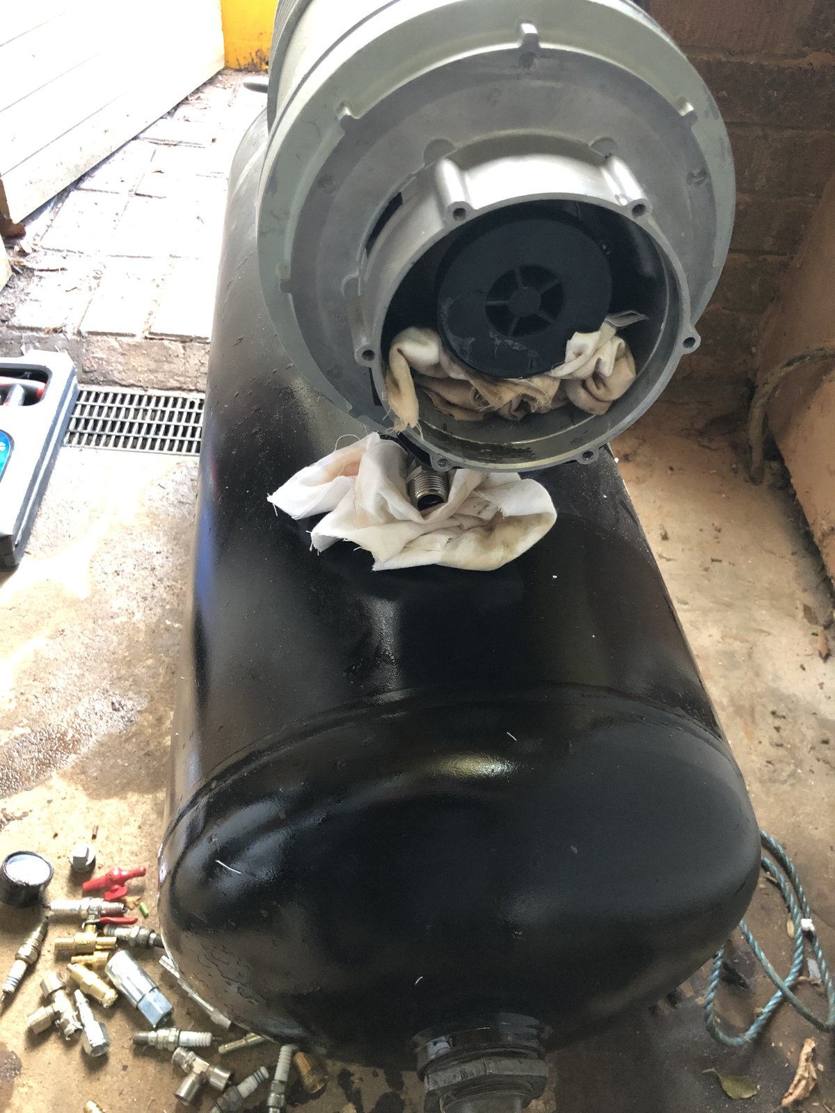

Hi all,
I'm new here and would like some advice with a Hydrovane we have here which is being problematic.
When we bought it a few months ago the previous owner stated that it occasionally leaked (didn't state air or oil) but stated it just needed a service kit and it would be fine.
Well when installing the service kit it had water and oil in the air chamber and lines into the tank. So I decided to clean the compressor all up and install new seals needed.
I bought correct size O-ring for the main chamber, used some o-rings I had here for the oil cooler lines and then made a gasket out of gasket paper as the kit for it to get it working was £120 which I didn't really want to pay.
Anyway when rebuilt and oil put in up to the fill plug (700ml oil) it's is producing air but it seems very low CFM. Also after 10minutes and up to temperature it was leaking oil from lots of places.
I then took the air line off to the tank and it was full of oil and the main chamber was full as well. (Previous owner has modified the switch and the tank was at 15 bar)
I don't know enough to fully understand the issue here with it.

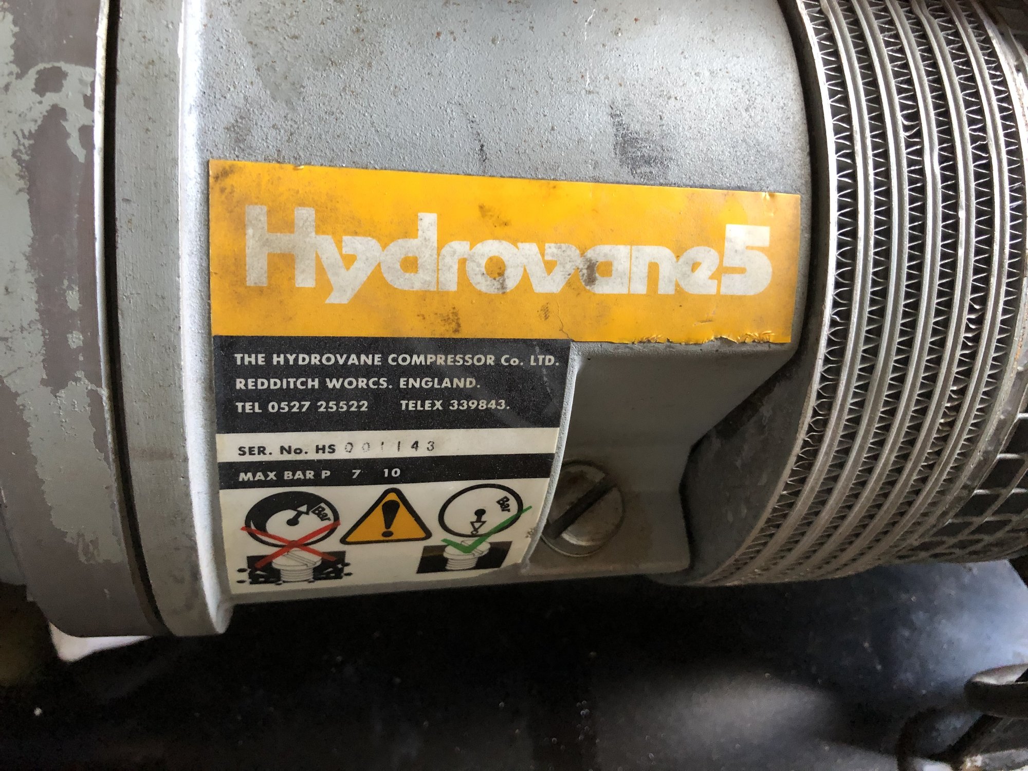

It's a Hydrovane 5 with a 1.1kw single phase motor on it.
Can anyone help me please as I don't want to install new air lines in our workshop until it's running fine.
