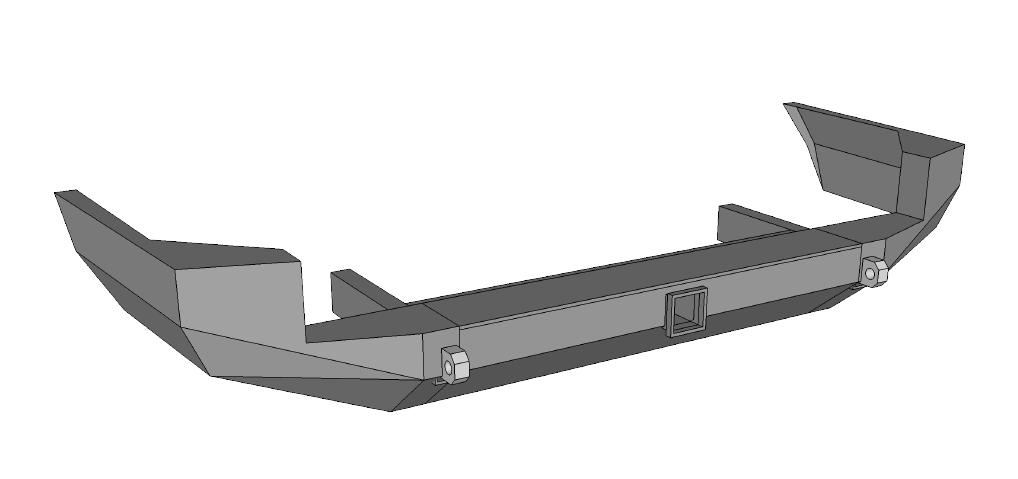

Hoping someone can help. I have a bunch of parts in a nested dxf file, I need to unnest the parts into individual files so I can send off for laser/plasma cutting, is anyone able to unnest them for me
@julianf I've got the free version of Fusion 360 but thats it. Looking online at free CAD programs that will allow me to manipulate the file.
Its a total of 25 parts that will hopefully enable me to make a bumper for the rear of my Jeep.

This is what the finished product should look like
