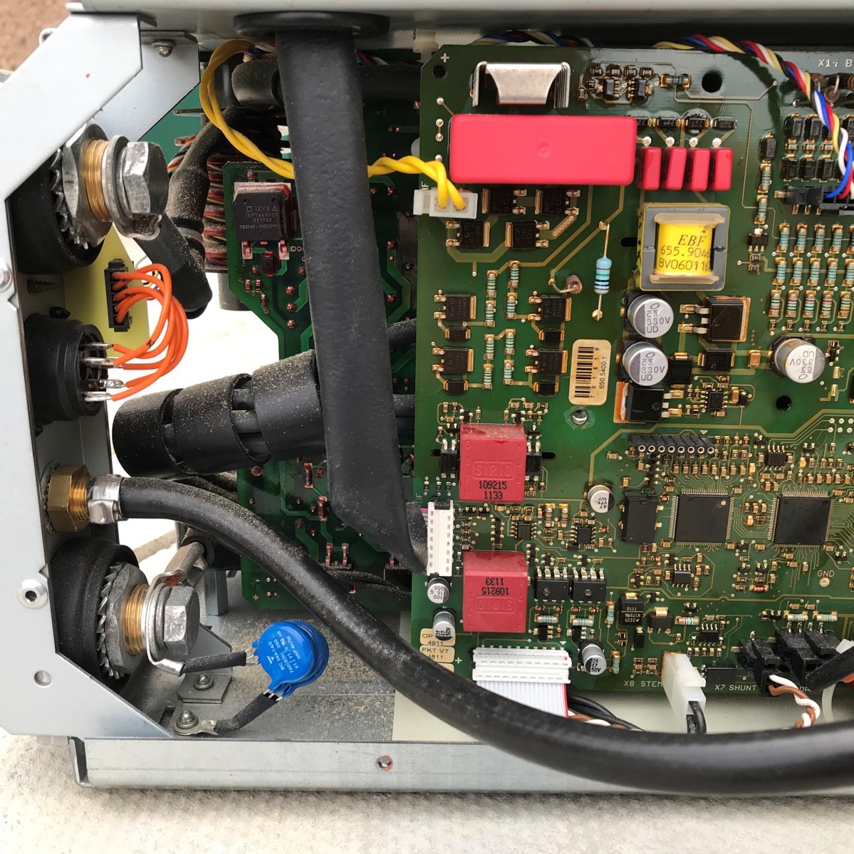

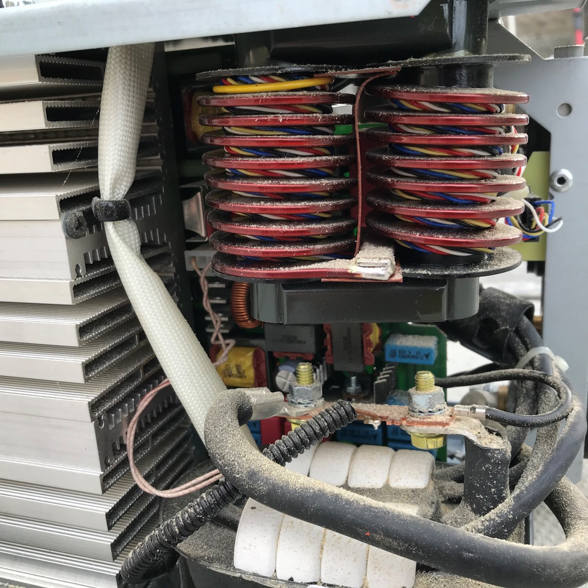

I have just been quoted £2400 to repair my Mini TIG 180.
The first one died and was returned to Germany, came back still not working.
Then I got a replacement which worked.
Now out of Warranty, I have only used it as a stick welder 6 times, owing to personal circumstances.
So this machine made a pop noise and died on Sunday.
so be warned, price isn't a guarantee of quality, or reliability.
