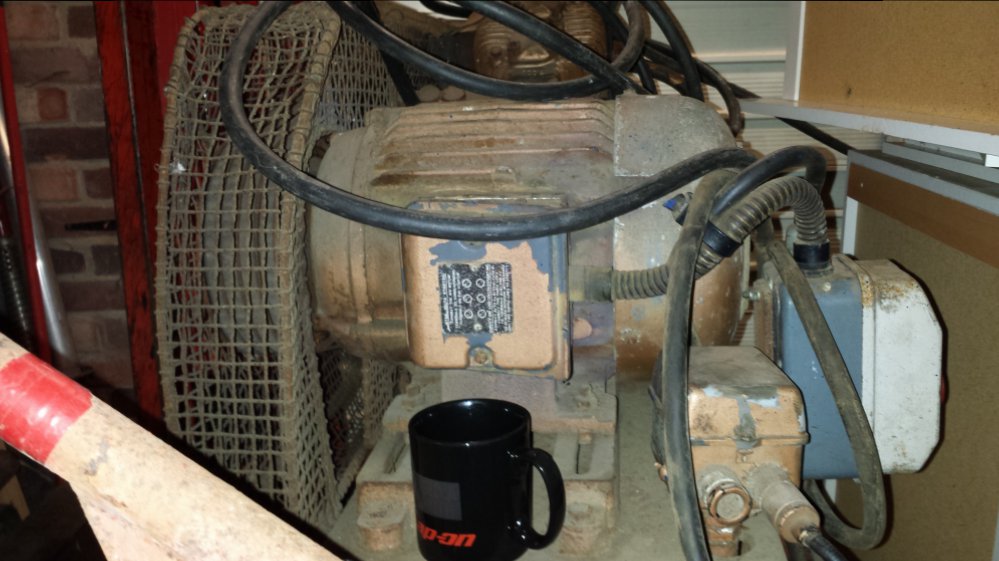

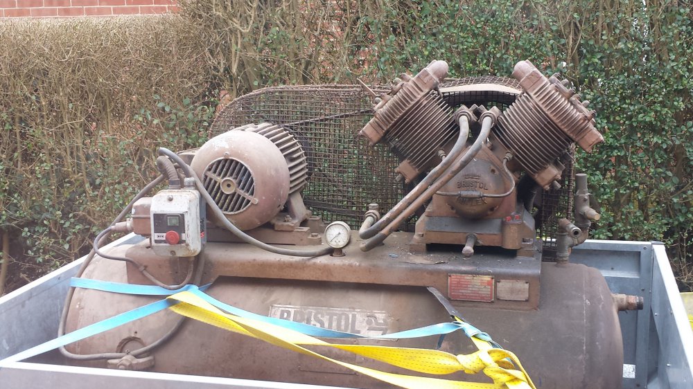

Nice project for youJust collected this old beast, a nice replacement for my little Clarke.View attachment 59676

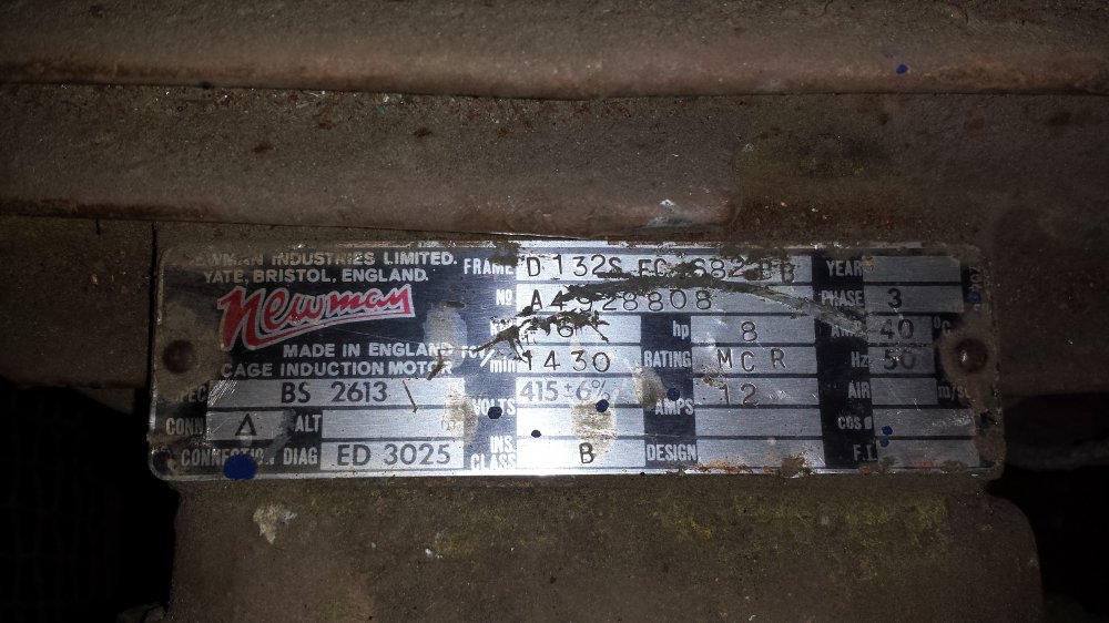

30cfm on a single phase 3hp motor seems a lot ?Yes its a 30 CFM unit so it should be fine for push bike tyres!
was gonna say no way would that run on single phase. 12 amp each phase is about rite a 16 amp 3 phase socket will be fine. what are u using motor rated hrc fuses or mcb ??It's 8 hp 3ph. I will get a photo of the data plate in the morning. Cheers
On a different subject Brightspark are you anything to do with Brightspark Magnetos?it wants putting on a 16 amp supply triple pole mcb c type
