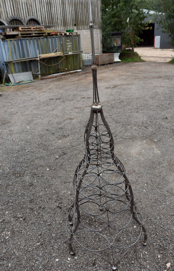

I sold my favourite piece of work a few weeks back, the Diatom plnkton thingy.
So it is time to make another.
I love the drawings of Ernst Haeckel, the 19c artist/scientist/philospher.
Especially the ones he did of plankton.
I was browsing google images and found this.
And liked the outline.

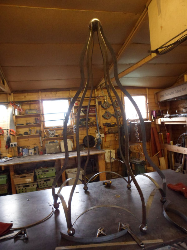

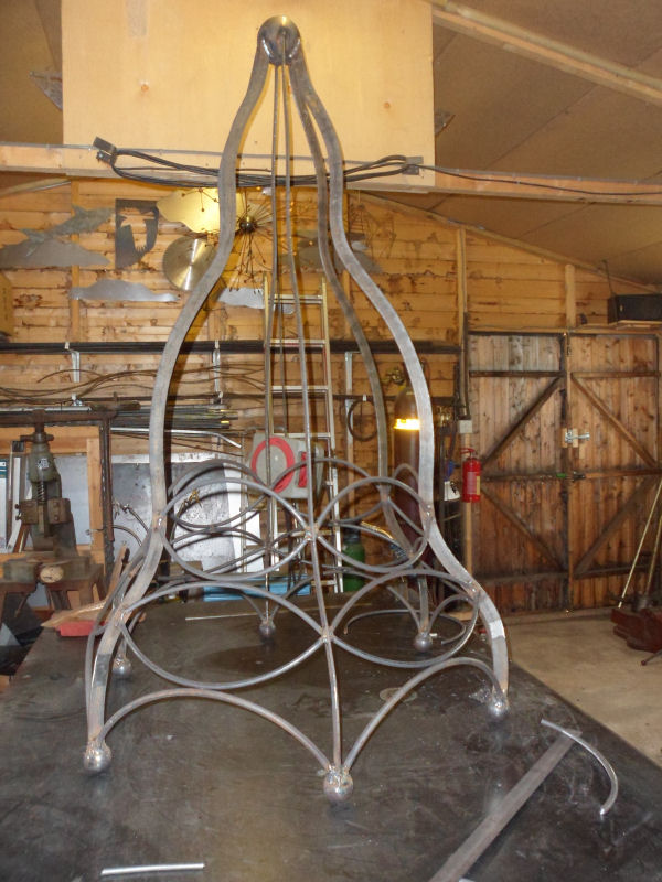

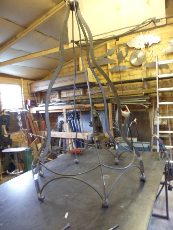

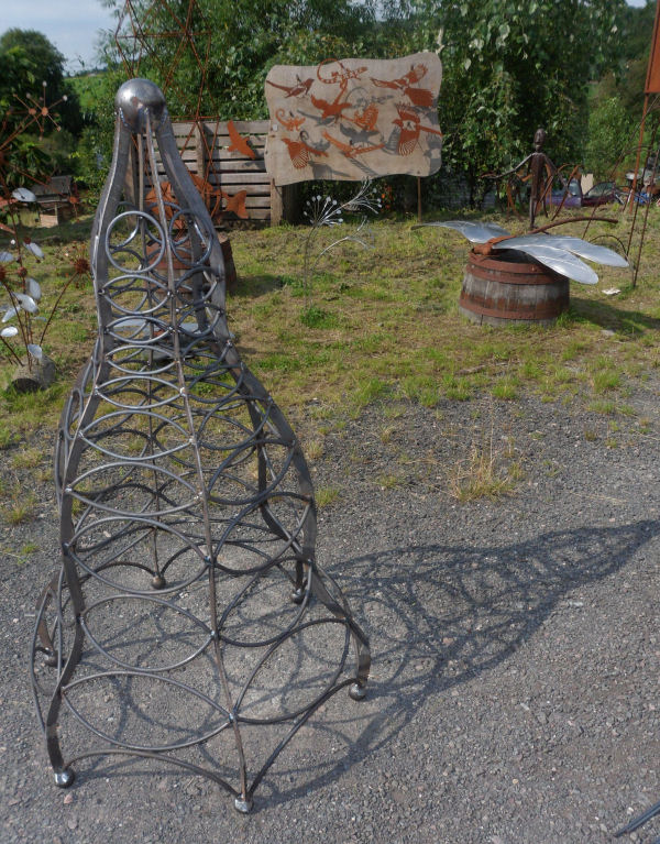

Two days later I have got this far.

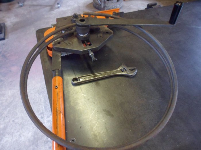

The main ribs are 30x5mm strip, damn near killed me on Friday bending all of these up. As usual I have used steel balls to finish the ends off and at the top.
Fitting the diagonal bits was a major headache because of the taper, but I seem to be getting there. Stands about 1.5m tall.
I am planning on making a nose cone to add another 50cm or so.
Plan A is to mount it on a pivot near the point of balance so it can roll about in the wind.
Lets see how it goes.
