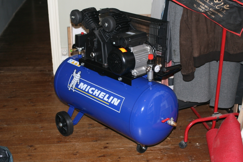

I've just bought two new identical belt driven compressors for the job. The specs are: 100L, 3hp, 230v, 240l/min output (8.4cfm). So I'll have a theoretical 480L/min together (16.8CFM). I've also got an older 2hp belt driven 100L that pumps out 190L/min (6.65CFM).
A friend is going to wire in 2 seperate 16A fuses and plugs and I'll run heavy duty extension cables (manual says 4mm2!) out to the patio.

1) Is the tank outlet on most home/DIY compressors 1/2" BSPP?

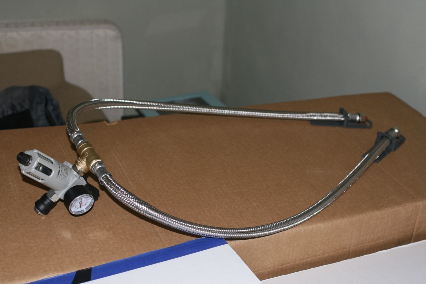

2) I plan to install an elbow, ball valve then quick release socket on both compressors, all 1/2". Then a 1m hose to a 1/2" Y piece which would then feed into the regulator/filter with a quick release the other side. Does this sound ok?
3) Will the 2 new compressors suffice or should I also plumb in the 3rd one? It's going to cost a lot more in fittings
4) I notice lots of people have used copper pipe. As this is a temporary installation, would ID 10mm hose be ok?

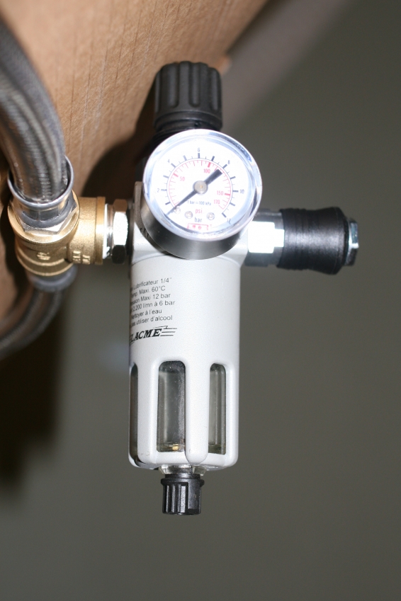

5) I already have a filter/separator but it's 1/4". Would it be worthwhile upgrading to a 1/2" one?
6) Alternatively, and much more simply, I have to hand the fittings to link the 2 compressors from the quick releases after the regulators via a 1/4" Y piece and 10mm ID airline and into the 1/4" filter/regulator. It means no more spending
but would it do the job? The compressors are equal sized so hopefully wouldn't damage the regulators.
