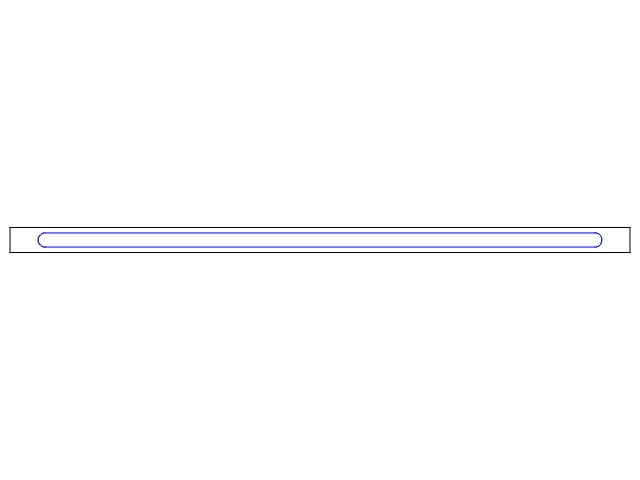

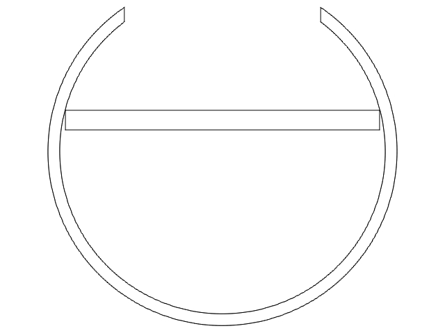

I'm trying to weld a 5mm x 80mm x 2000mm length of flat into a 2200mm 3mm x 88.9 tube with the intention of opening up the tube with 50mm wide channel. Hoping that the flat will help the tube retain its structure.
I've tried a couple of times but end up with the tube bowing probably as a result of too much heat and the fact each end of the tube is supported on axle stands.
I'm putting the flat in the tube then packing it so it's tight against the inside. Then grind away a slot about 3 inches long to expose the edge of flat and then weld it up.
Then after this is done about 8/9 times either side I open up 6inch sections and further weld inside and then fully open the tube up along its length.
But I'm getting warping and movement. When I cut the opening out the edges aren't straight
Do you think this is the correct way to do it please?
Should cut smaller slots across the edges of the flat?
I'm prototyping something, not at all trained in welding or anything to with metal working/engineering.
Many thanks in advance.
Dave
