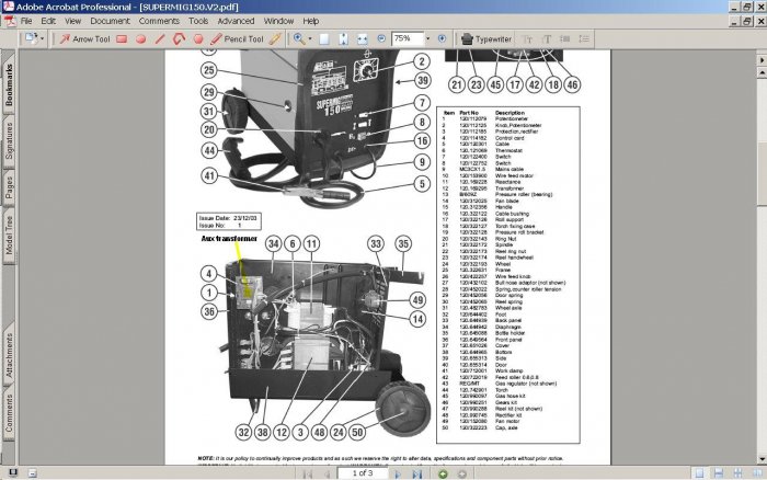

Hi there, I'm new to the forum, but have on occasions been a lurker on some of the threads however, the time has come for me to get involved as I've hit a problem of my own.
I have a Sealey Supermig 220 which is about 2 years old, and I'm sure has blown a fuse. The trouble is I can't find it.
I've looked in the manual and it describes the symptoms i.e.: welding from below and some spatter dropped into the gas cup and linked the cup to the tip, at which point the welder died.
I've Checked the fuse in the plug and its fine, so have power into the machine. The manual says the problem is most likely to be the fuse, which is located on the Auxiliary Transformer, and herein lies my problem. I can't find the fuse, in fact I can't even find a parts list that places the location, of the Auxiliary Transformer! I'm guessing the Auxiliary is the top one of the 2 transformers, but can someone, anyone, please help.
The season is fast approaching, I have a half built Autograss Class 9, and a.t.m., no welder to finish it off with. And to cap it all, a miserable bitch of a neighbor who keeps complaining to the council about the noise I make.
