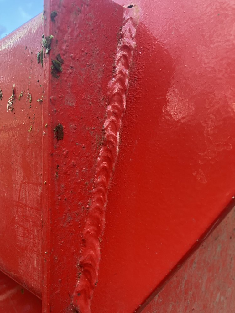

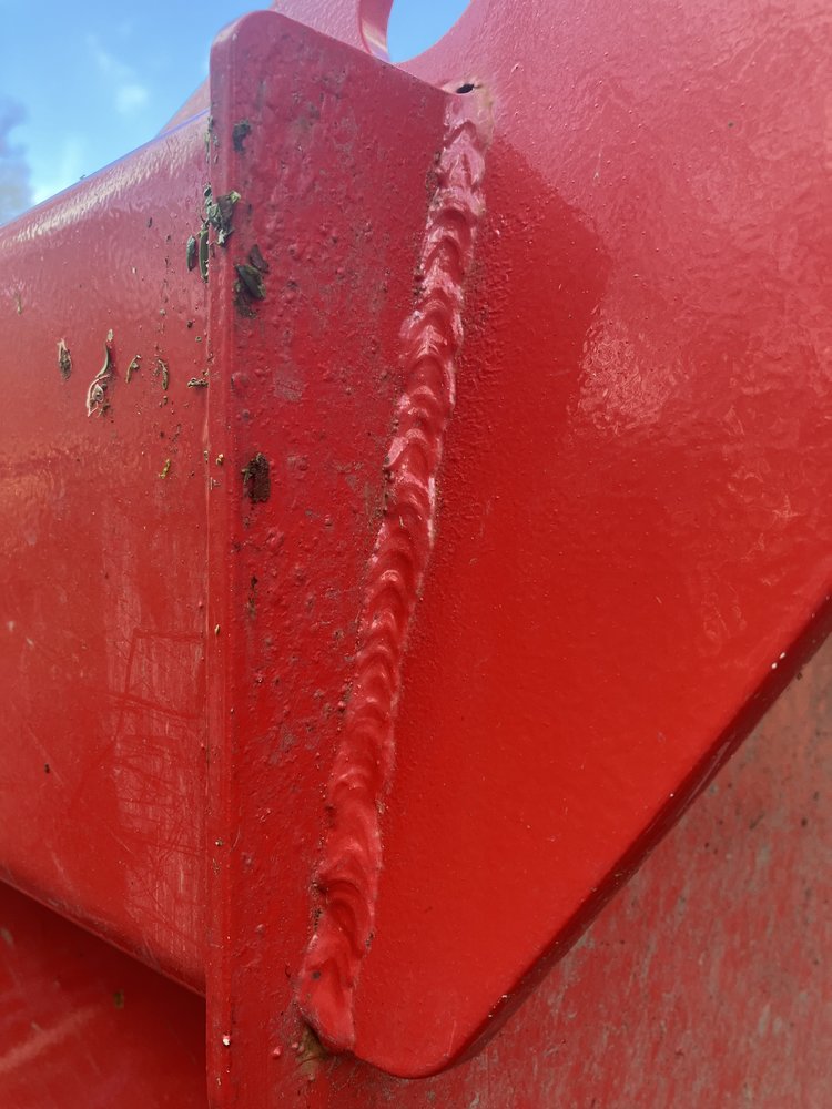

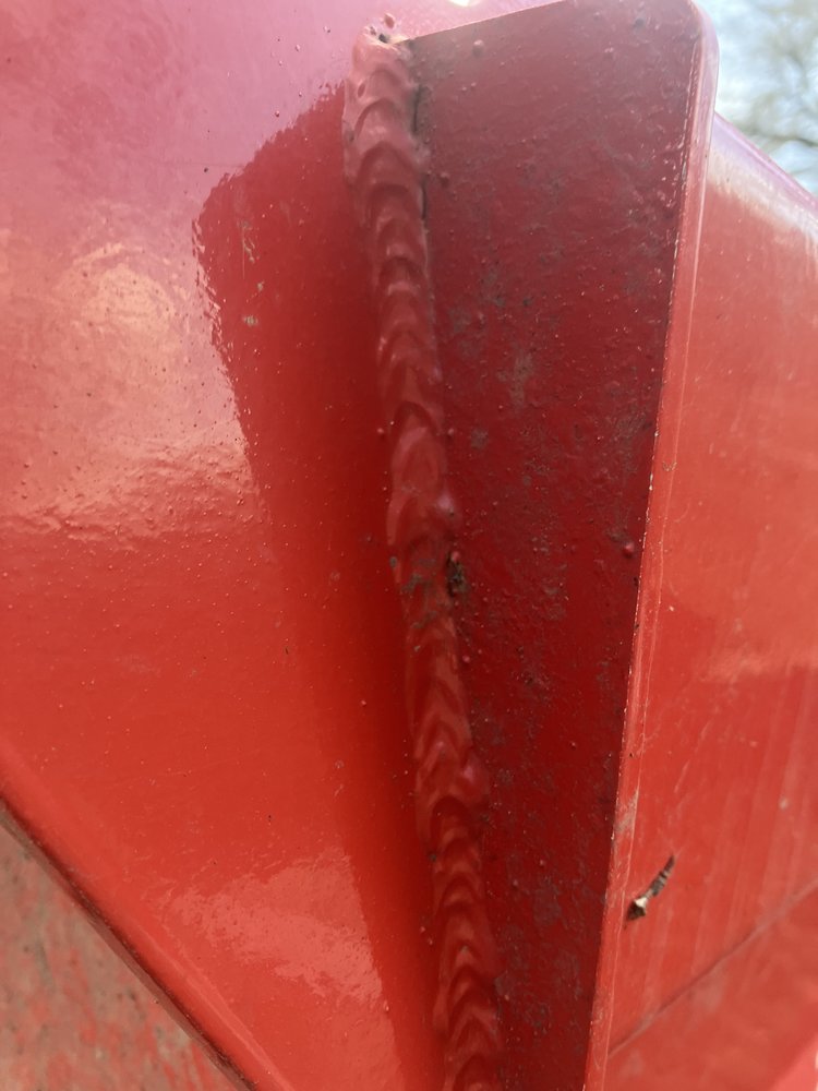

I like to see how new machines are made , there’s a new 14 tonne dumper trailer nearby made by a well known manufacturer from across the water
So I decided to have a look this is what I saw at front corners
View attachment 482089 View attachment 482090
its the one to bash your head on whilst working on the machineHasn't fallen off yet, what does that flange do ?
Probably best if it does pop off easy then!its the one to bash your head on whilst working on the machine
I think thats called Crapolini
Ok I willNothing wrong with that. It's not the tidiest but it's plenty strong enough.
Show us some of your welds Ivor, let's see if they're any better.....
Ivor does not need to prove anything, this was delivered with a CE mark if it is good. Upon visual inspection this is rejection and the welds should have been repaired before the vehicle was painted.Nothing wrong with that. It's not the tidiest but it's plenty strong enough.
Rejection for what reason?Ivor does not need to prove anything, this was delivered with a CE mark if it is good. Upon visual inspection this is rejection and the welds should have been repaired before the vehicle was painted.
Given the inverted vee shaped ridges it looks more like vertical up to me.Vertical down hot & fast.
I would put money on it vertical downGiven the inverted vee shaped ridges it looks more like vertical up to me.
Vertical down looks much smoother.
