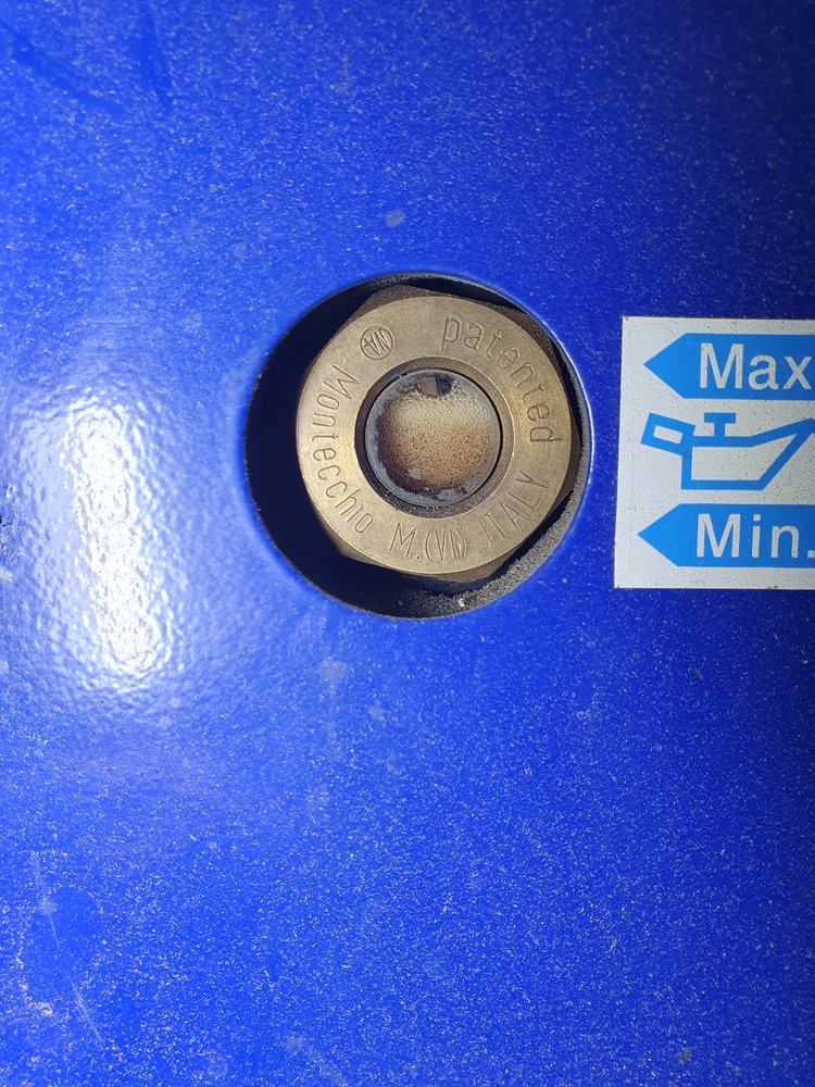

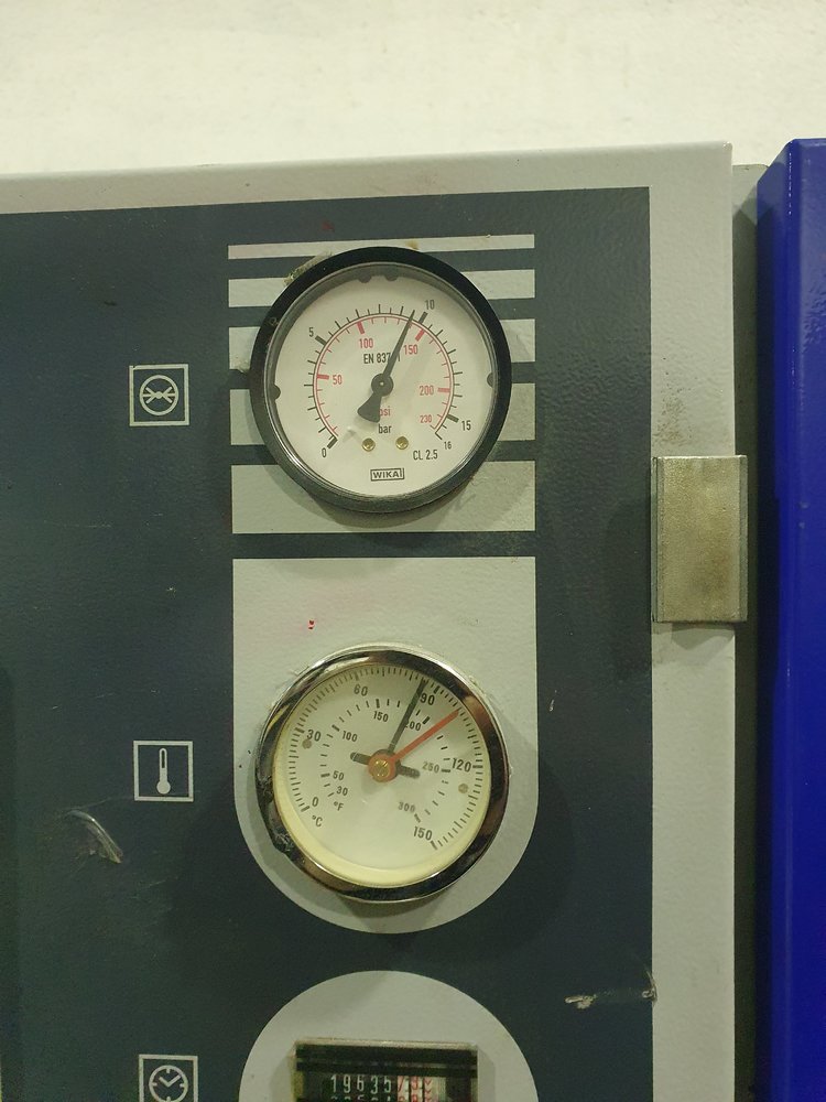

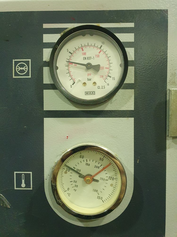

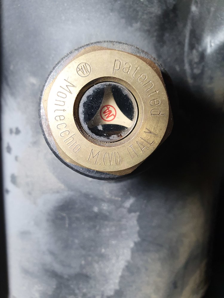

Now fast forward to today. I was using the compressor for maybe 35/40 minutes with my cabinet and I noticed it wasn't building pressure.
That was an oil temperature fault and so motor wouldn't start - fair enough.
I then noticed that the oil sight showed some oil in there with lots of bubbles in it.. when the oil settles you can't even see the level in the glass any more.
I have attached some pictures. The gauges show the starting pressure (I bled it off to test) and the temperature upon reaching 10 bar.
I've read the common cause for this is refrigerant getting into the oil. Does cause overheating too?
I believe the unit was serviced not long ago and hasn't done many hours since.
What do people think of this?
