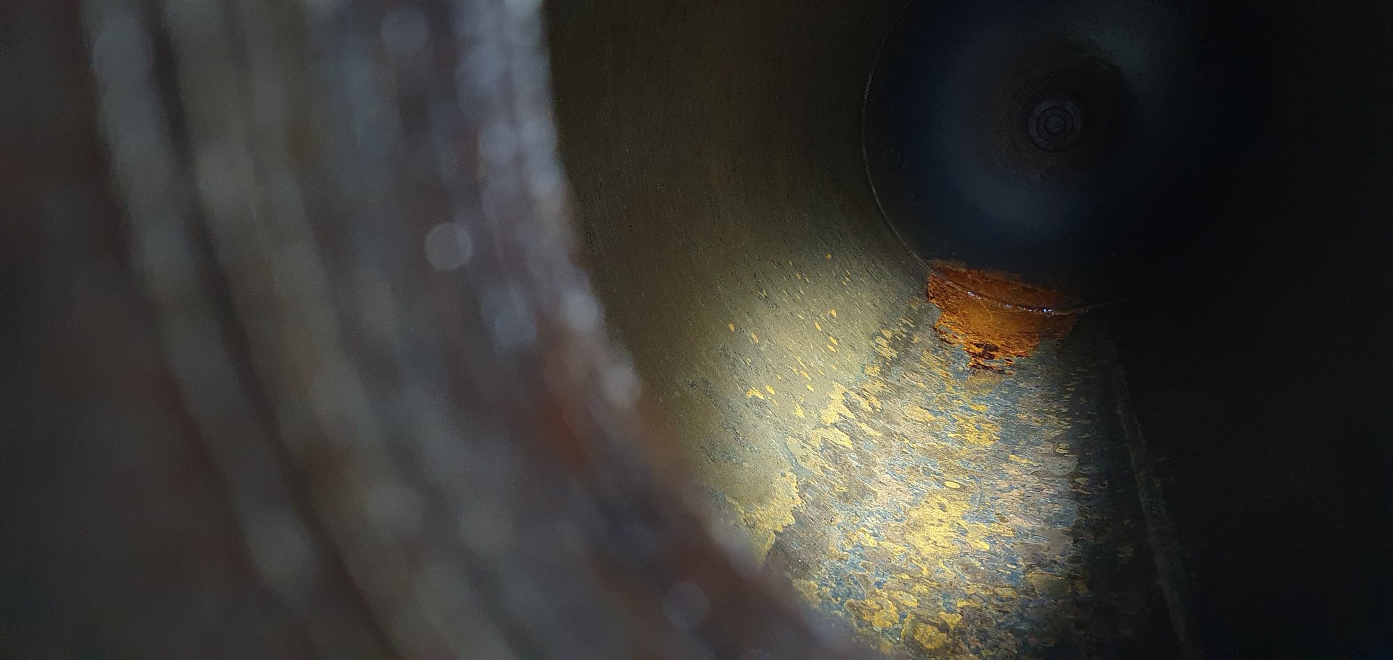

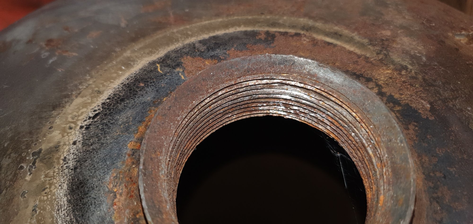

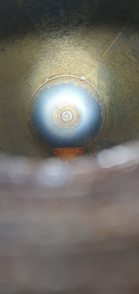

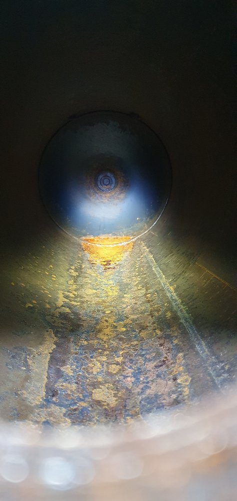

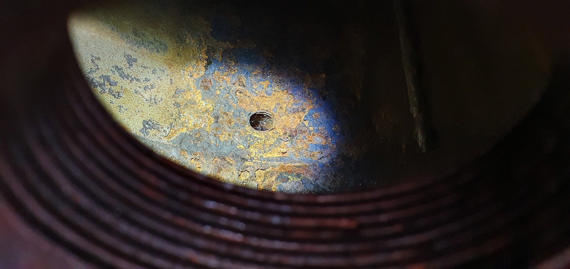

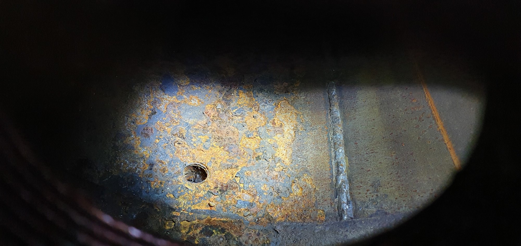

I bought an old compressor off the internet in the hopes of cleaning and inspecting the tank. If sound, have it galvanised for longevity. Below are some snaps if the inside of the tank. Ends are 2" BSP.
I wasn't too enamoured with the area around the drain so bought an unpainted air receiver. The fab shop I normally deal with when I need things sending to the galvanisers is adamant the tank shouldn't be dipped as it'll warp and potentially crack the welds.
Is there anyone on here who can offer an opinion?
With thanks,
Ian.
Cross threaded end port cleaned up with thread file. I had trouble sealing this with a new fitting when hydrostatic testing the tank post-clean.
