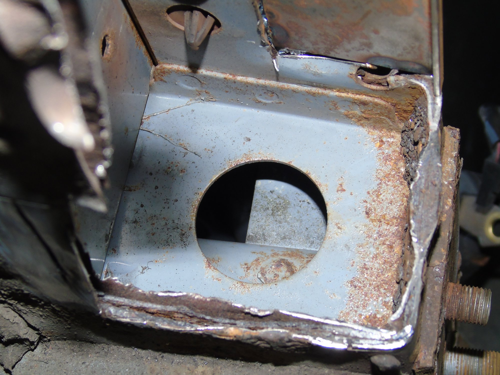

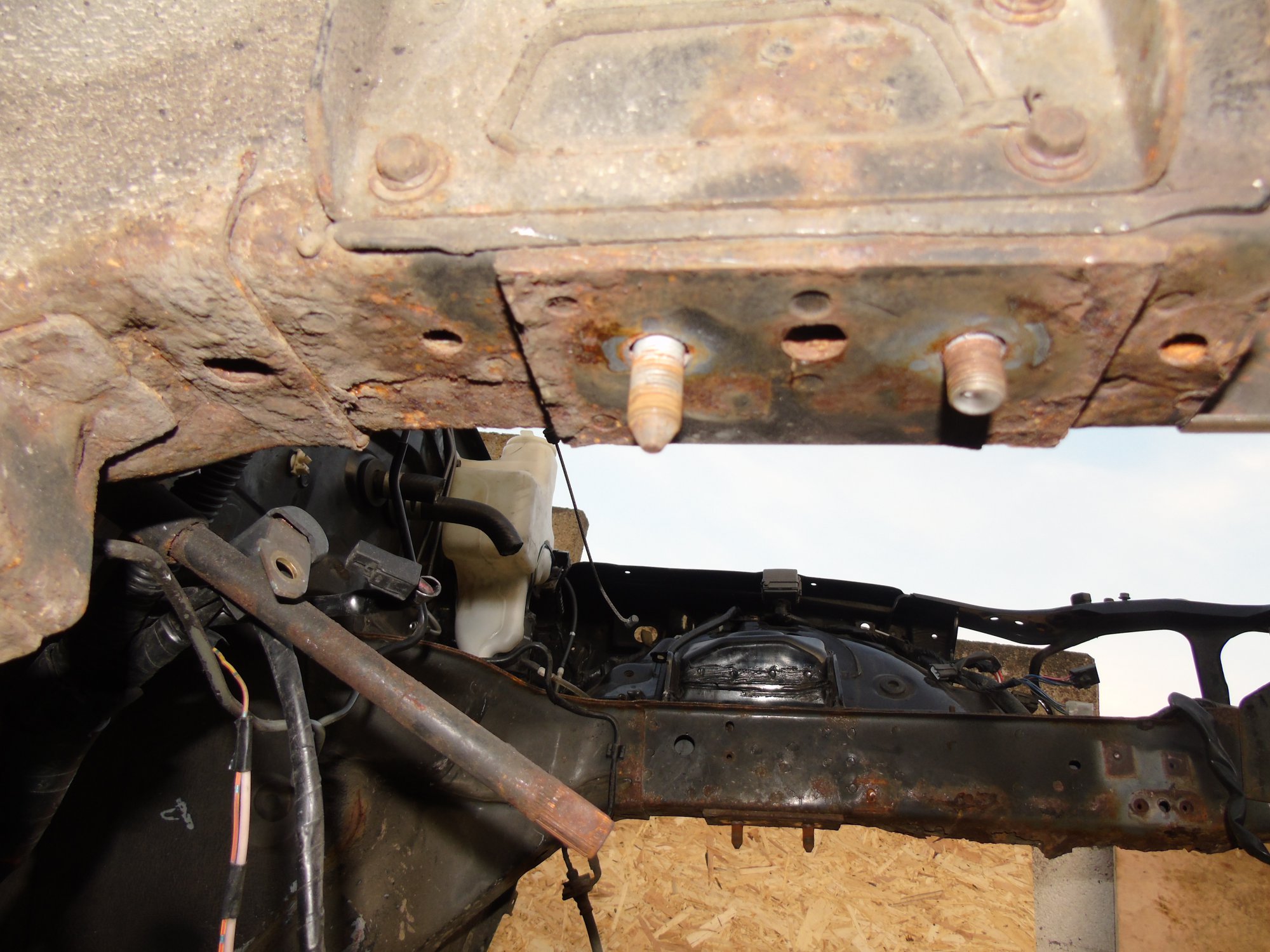

While removing the front subframe from my Mazda MX-5, I managed to snap one of the four mounting studs inside the shock towers. No idea why - this particular one was a real git to turn and eventually snapped right off about halfway down - might have been a damaged thread!
I didn't pay it much heed at the time because I assumed I'd just be able to back out the stud and replace it with another, but it turns out it passes through a crush tube welded to the inside of the frame rail... and is then spot-welded to the crush tube. So basically, it can't be replaced.
The way I see it, I have three options:
1) see if there's enough thread left, and if the thread is in good enough condition, to just put the nut back on anyway - I must admit I haven't checked this yet
2) cut and drill out the stud, tap the hole and thread in a new stud
3) Cut the entire thing out of the frame rail, top and bottom, and make a new assembly - crush tube with stud welded to it, plates top and bottom, then weld it where the old one went.
Not my image, and this is a rear subframe mount rather than front, but it's this kind of arrangement: http://www.miataforumz.com/attachme...lp-my-differential-ppf-bolts-stuck-004888.jpg
Any advice for dealing with this? I'm sure there's some way to fix it but since it literally holds the front suspension and engine in the car, I don't want to go the wrong way here...!
