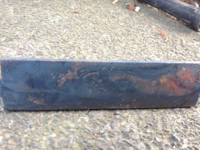

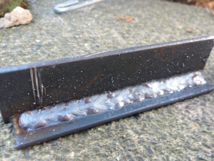

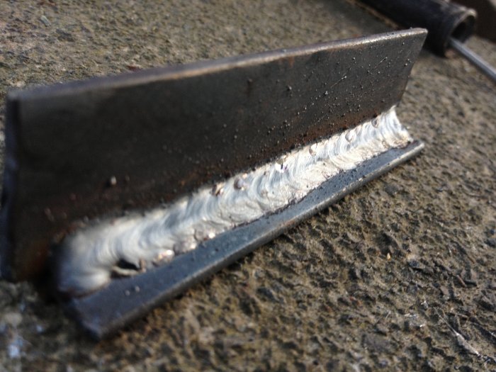

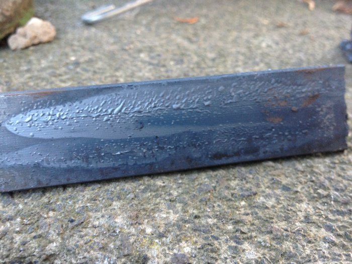

Can I ask for your opinions on a couple of test welds I have just done?
3x25mm mild steel flat bar
10lpm argon/c02 80/20%
wire feed 7.4m/minute
The first two pictures were set as above using 18.5v and have virtually no penetration?
and the other 2 pictures were set as above using 19.0v
I got the settings from the millers calculator. First time I have done any fillet welding with the R-tech MTS210.
I have got a bit of mig/stick experience from when I used to work for a place doing gates, railings and decorative stuff.
Just trying to see where I can improve and try to sort things out early before I continue practising bad habbits.
