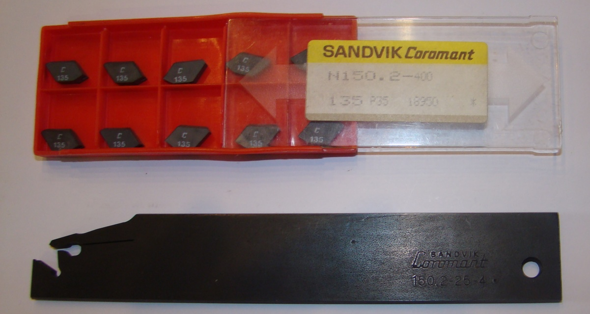

Brad you could be right as i am having a job finding anyi very much doubt you will still get the inserts.
Iscar, Sandvik and Kennametal have a tendency to change their design every few years to stop copy cats.

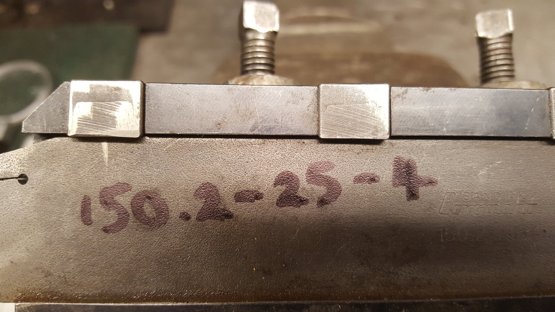

I'm guessing from the code that's a 2mm wide parting blade
Thanks for your help, the need for the tips does not equate to ordering from a non english speaking siteHungary:
Lukács Erzsébet egyéni vállalkozó
Lukács Erzsébet egyéni vállalkozó - szerszámkereskedés, Fémforgácsoló szerszámok, mérőeszközök, váltólapkák, szerszámbefogók, idomszerek, mikroszkópok és gyémánttárcsák kereskedése.www.lerzsebet.com

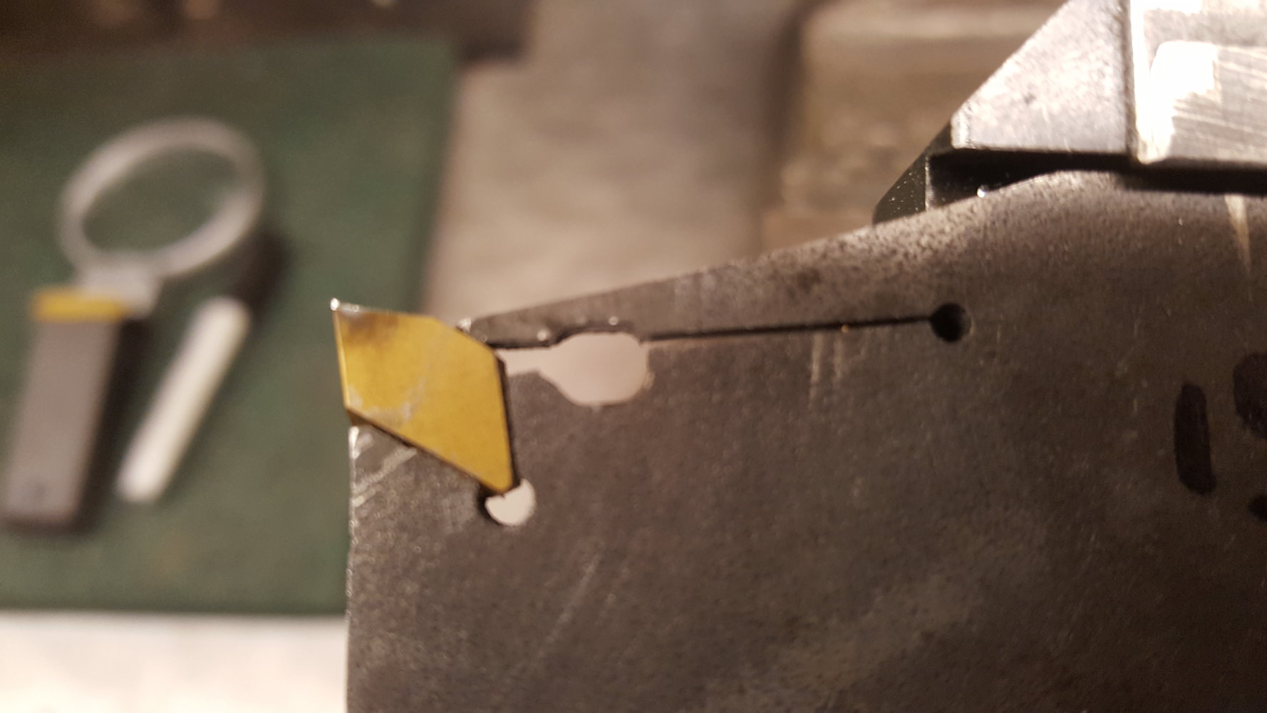

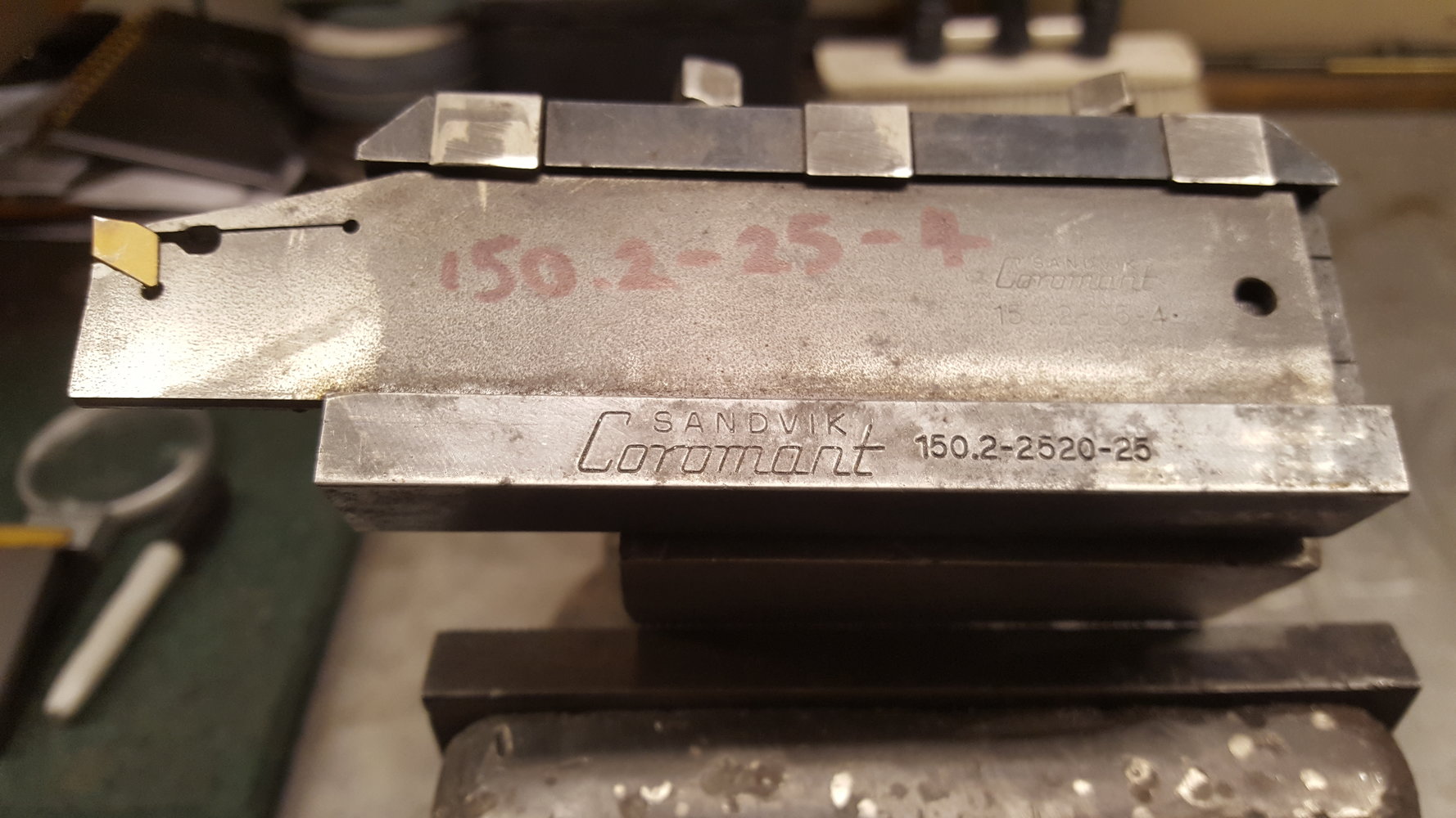

Code for tips in image:
5x Sandvik Indexable Carbide Inserts N150.2-400 235 P45 OMA486122 | eBay
Don’t pass the buck said Evans Fieldhouse Gill Goyen agreed and Hines Kennen and Lukin agreed. Milnes Muckle Munro Overton Paterson and Sibley Smith with Wilson were adept Britannia the challenger and Churchill Drummond had an ETA with EXE.www.ebay.co.uk
Bought and on there way....thanks for that mateYou might have missed the late edit to my post. There are 5 on eBay UK. Best buy them now.
