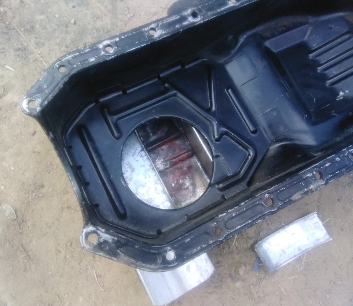

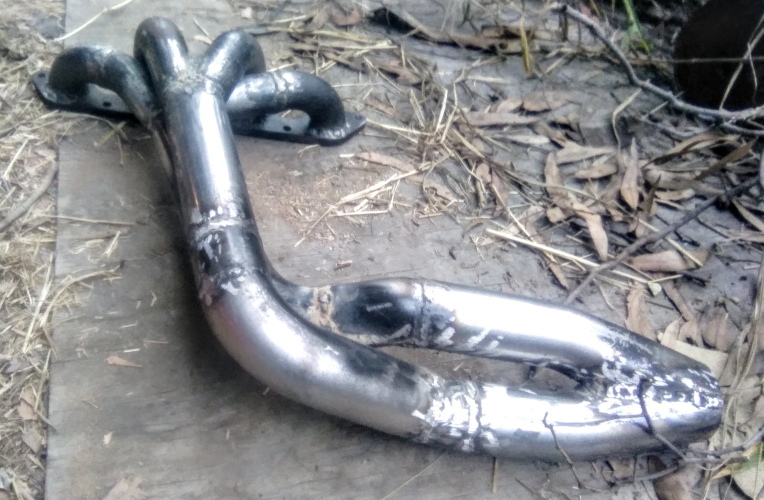

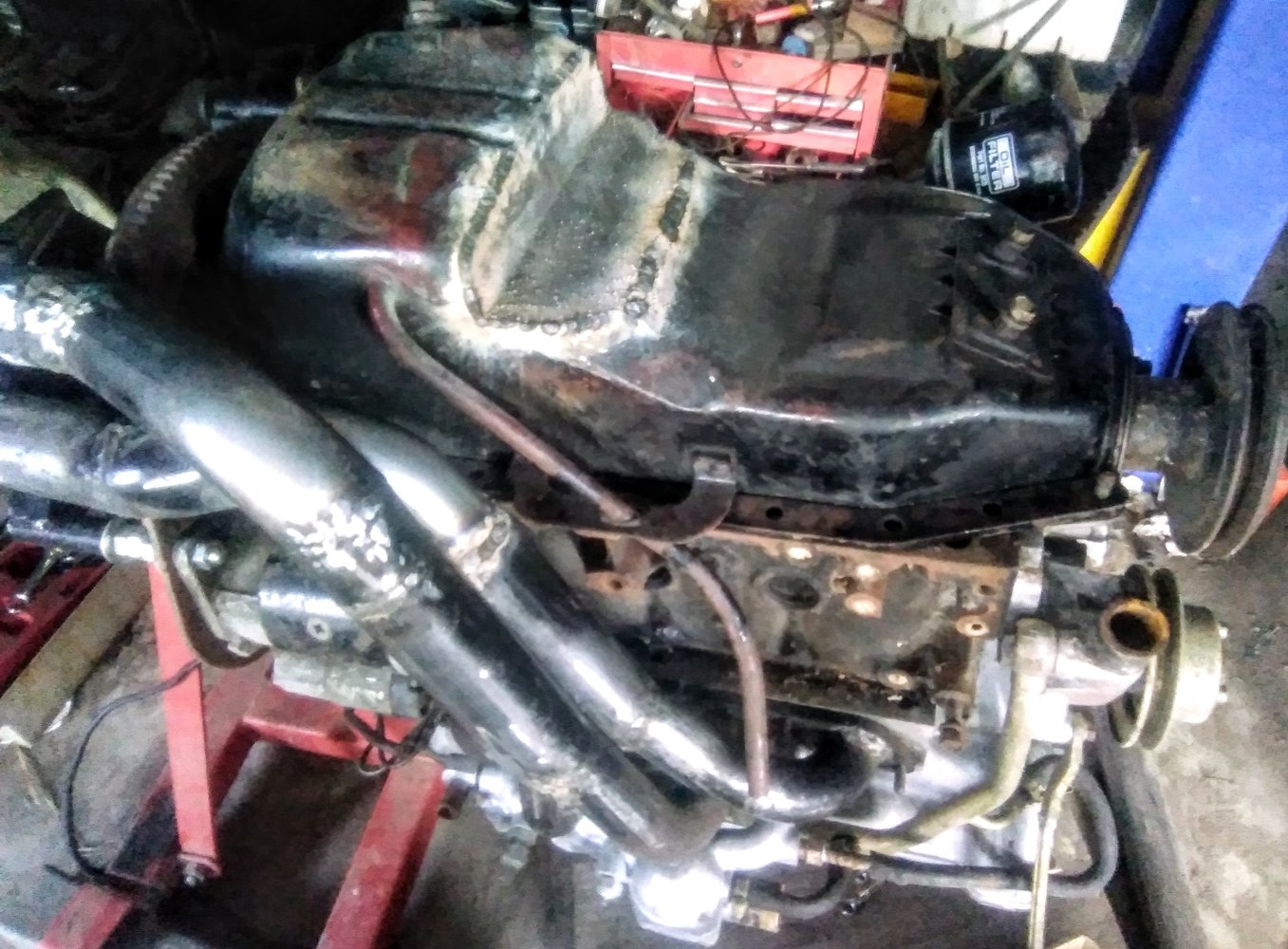

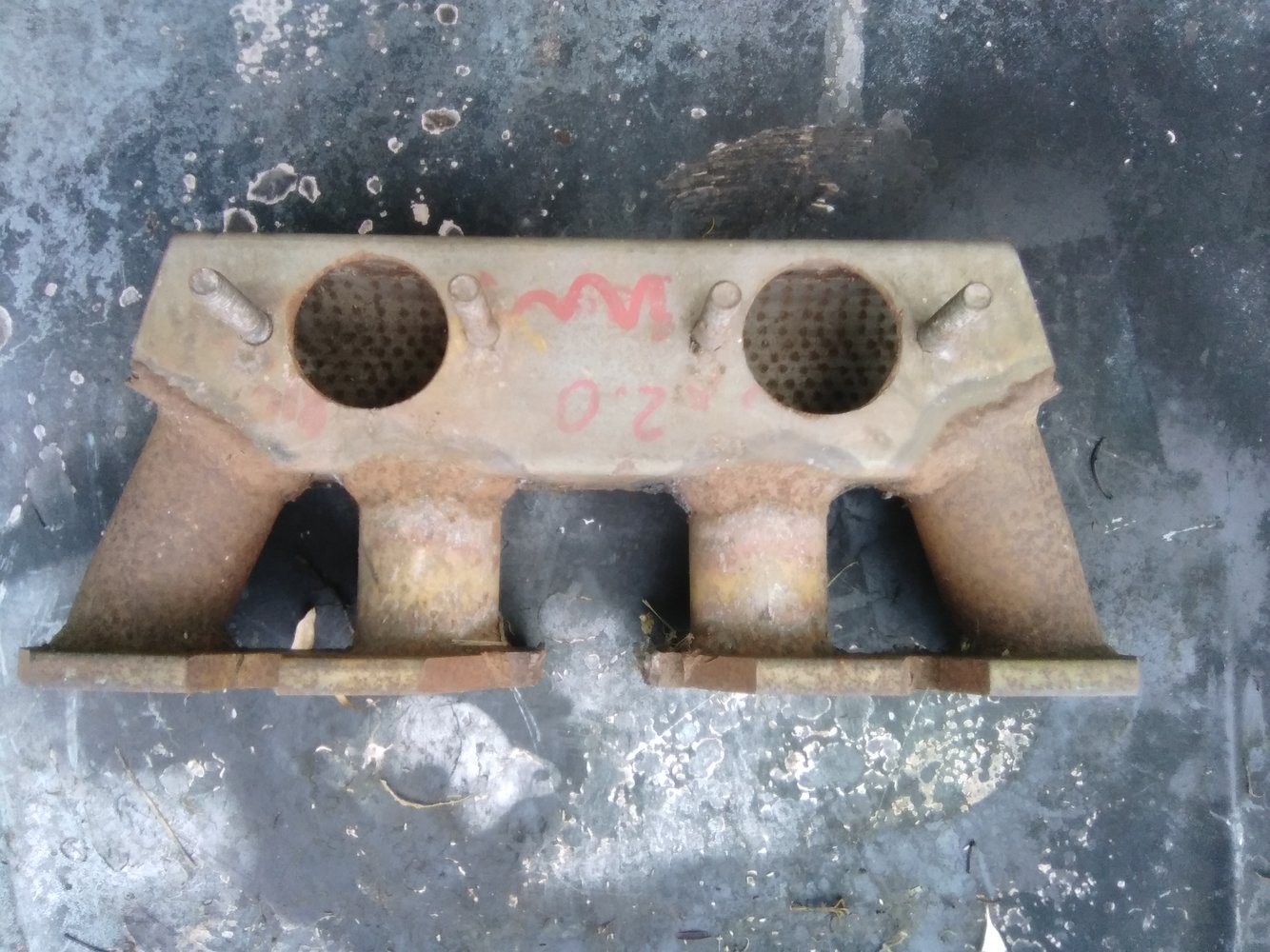

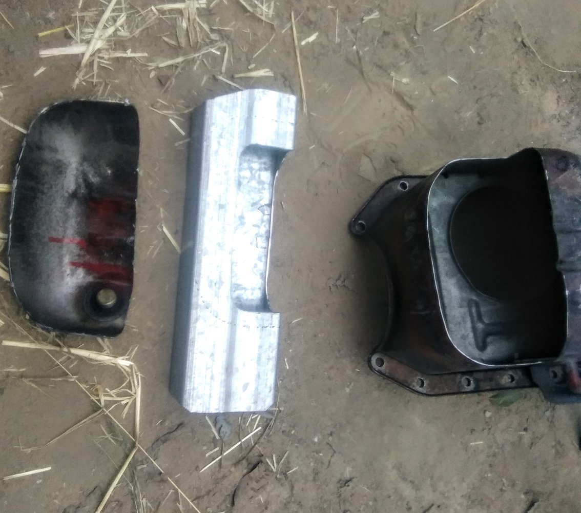

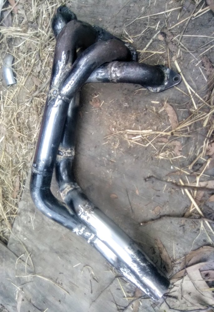

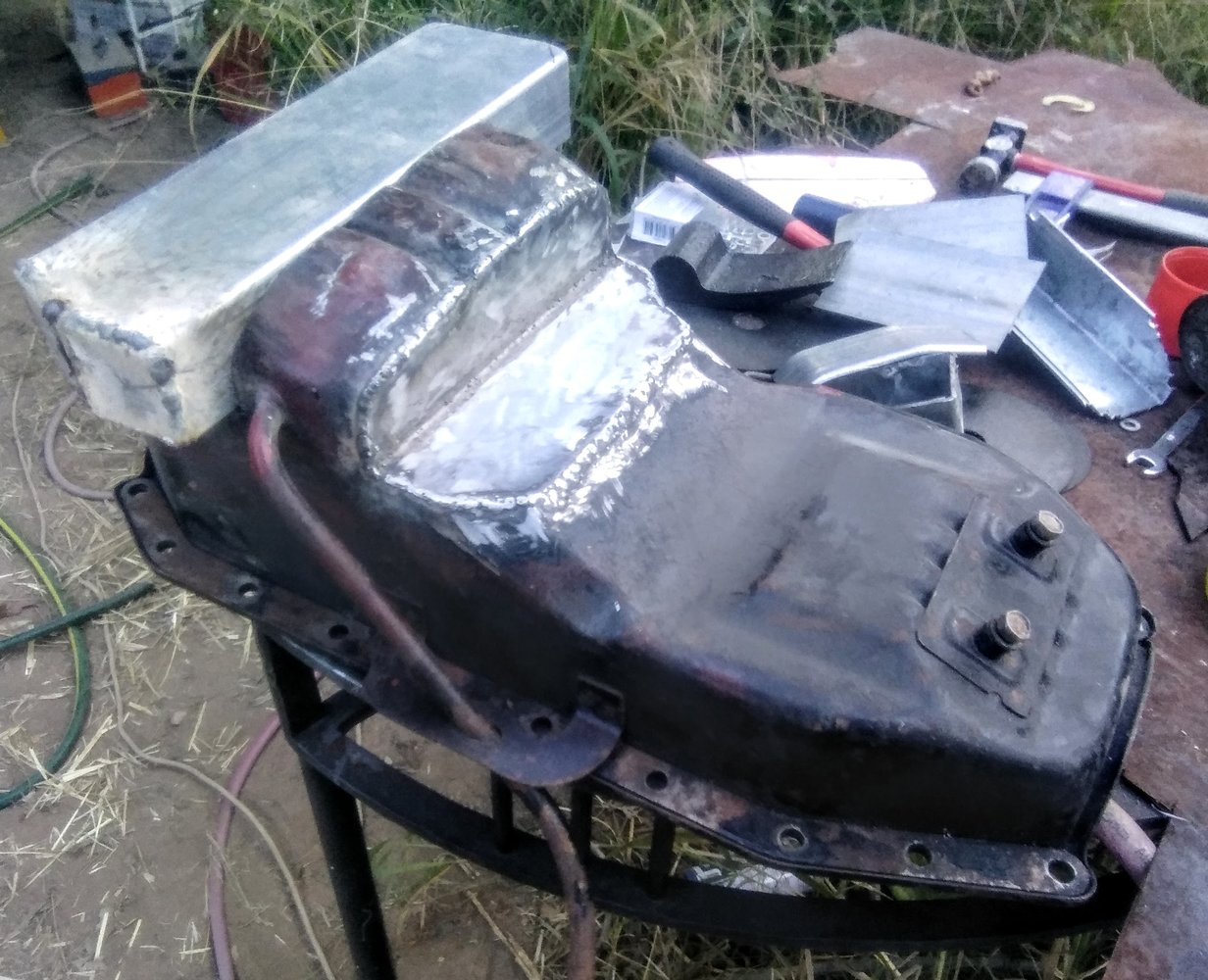

I'm hoping to end up with with a fun engine worthy of the Opel GT race replica I am building.
So here's the headers I have made and the winged sump and intake I am working on.
I'm making as many parts myself as I can.
I wonder if I may add a note of caution however. It looks very much like you are welding galvanised steel there without removing the zinc. I would reccommend that you do as the fumes it gives off are particularly unpleasant. Search Galv flu on this forum for more info.
