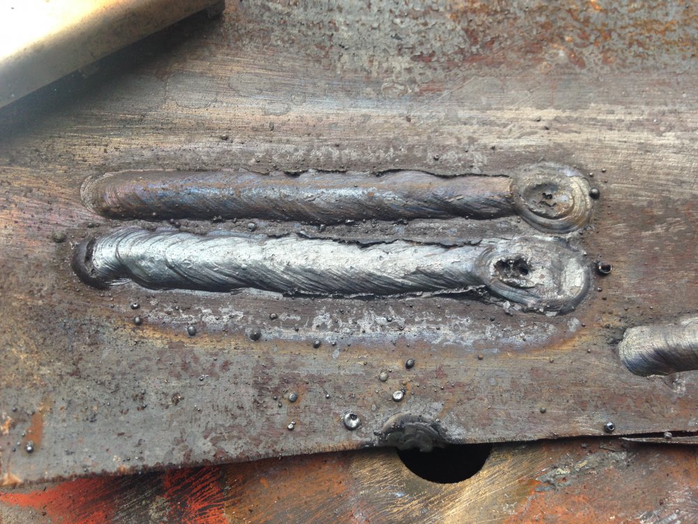

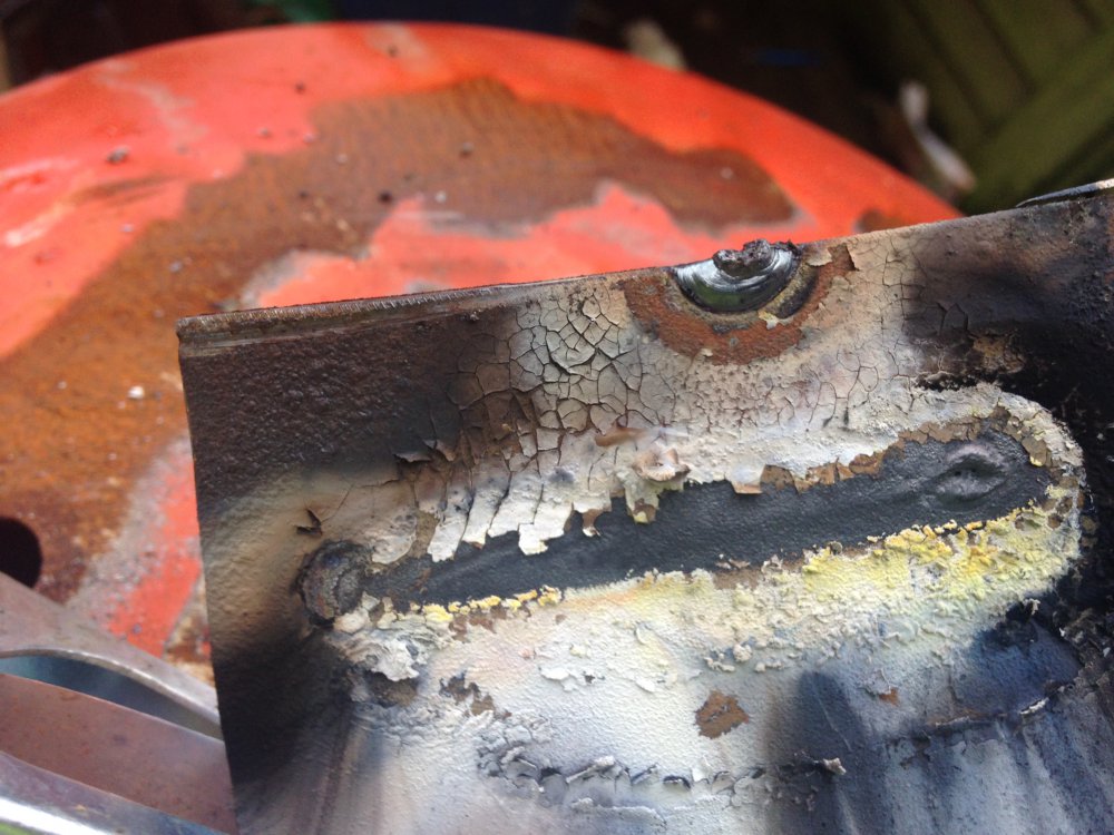

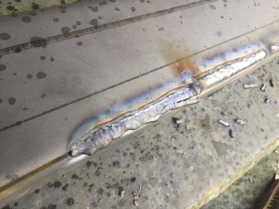

just noticed on my box of 2.5mm parweld 6013 rods that it says 40-70 amps ac or dcen...I thought 2.5mm rods had a current range of about 60-100 amps.
The box of 3.2's have no current info on them at all.
Could this be why I was blowing holes with it earlier if these rods are meant be run between 40-70 and I had them set at 80-90?
I can't remember having problems with 2.5's blowing holes in the material I was welding earlier with my other xti 160 or with my fathers cheap buzz box but I was using fincord rods back then.
Have looked at the parweld site but can't find current info for either diameter rod on there so a bit confused at the moment.
I am going to try these 2.5's at 50amps tomorrow and see how they do
