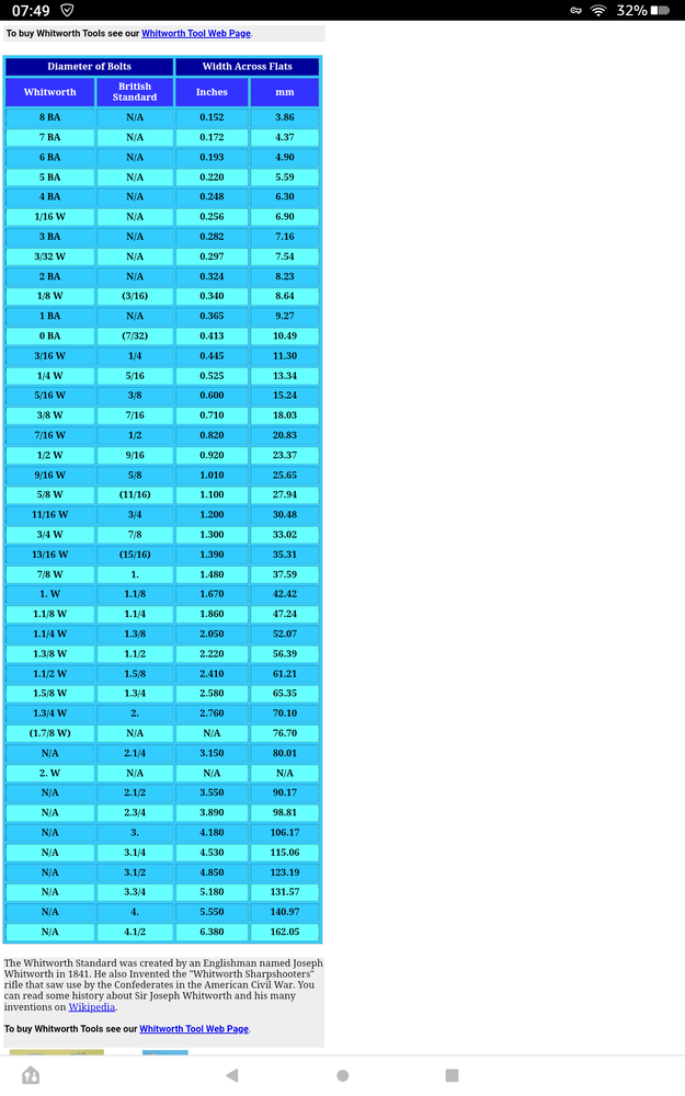

You are correct. My early morning maths was right (1.3”) but wrong column on the chart.1.3" ,works out at 33.02mm. That is the Metric equivalent , of a 3/4 whitworth , fitting or bolt.
