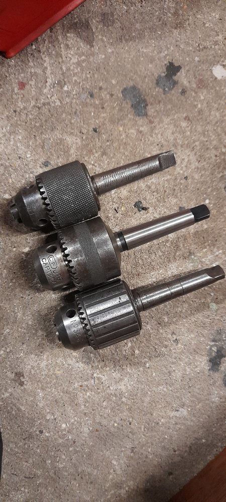

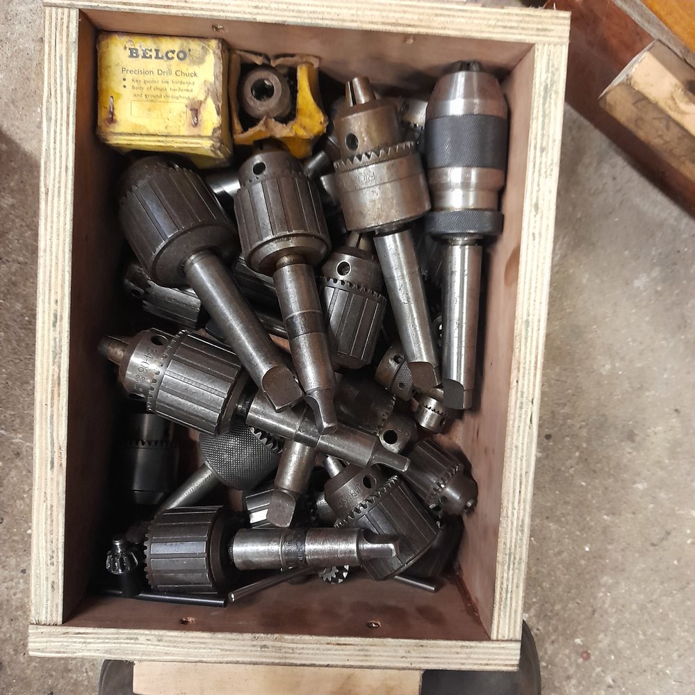

Once it's smooth I think I really need to find a new chuck too.
Any recommendations for something up to 13mm which is reasonably cheap? Keyed is fine.
Not had any luck with used Jacobs.
