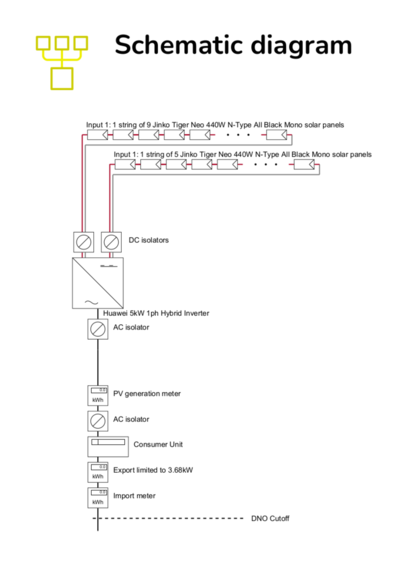

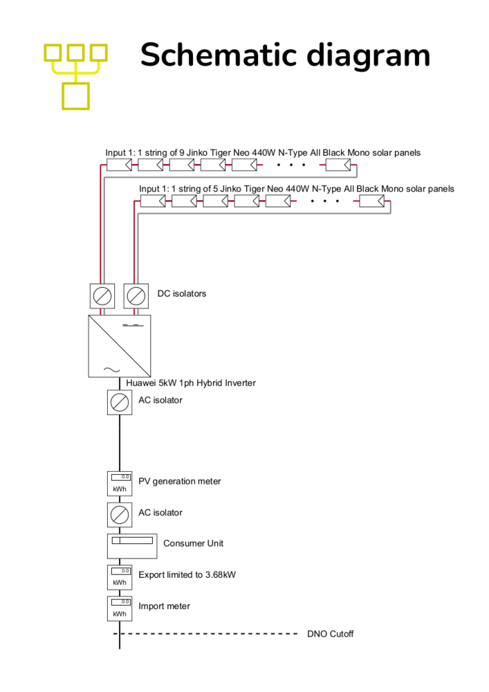

My Mum has just had a solar install done, not sure the exact spec but it covers one pitch of a 2 bed bungalow, so I'm guessing a couple of kW?

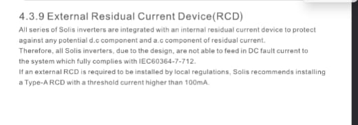

They finished wiring the inverter last week. Since then she's been having random RCD trips. I've said it could be a failing appliance or water ingress, but she's been there a year so far and no problems up til now, so it seems a bit suspicious.

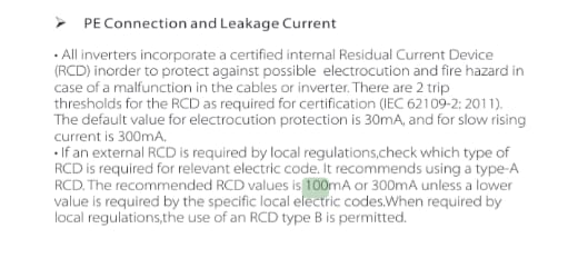

I know we have a few members on here who do this for a living - any experience of high-frequency noise from the inverter causing RCD trips?

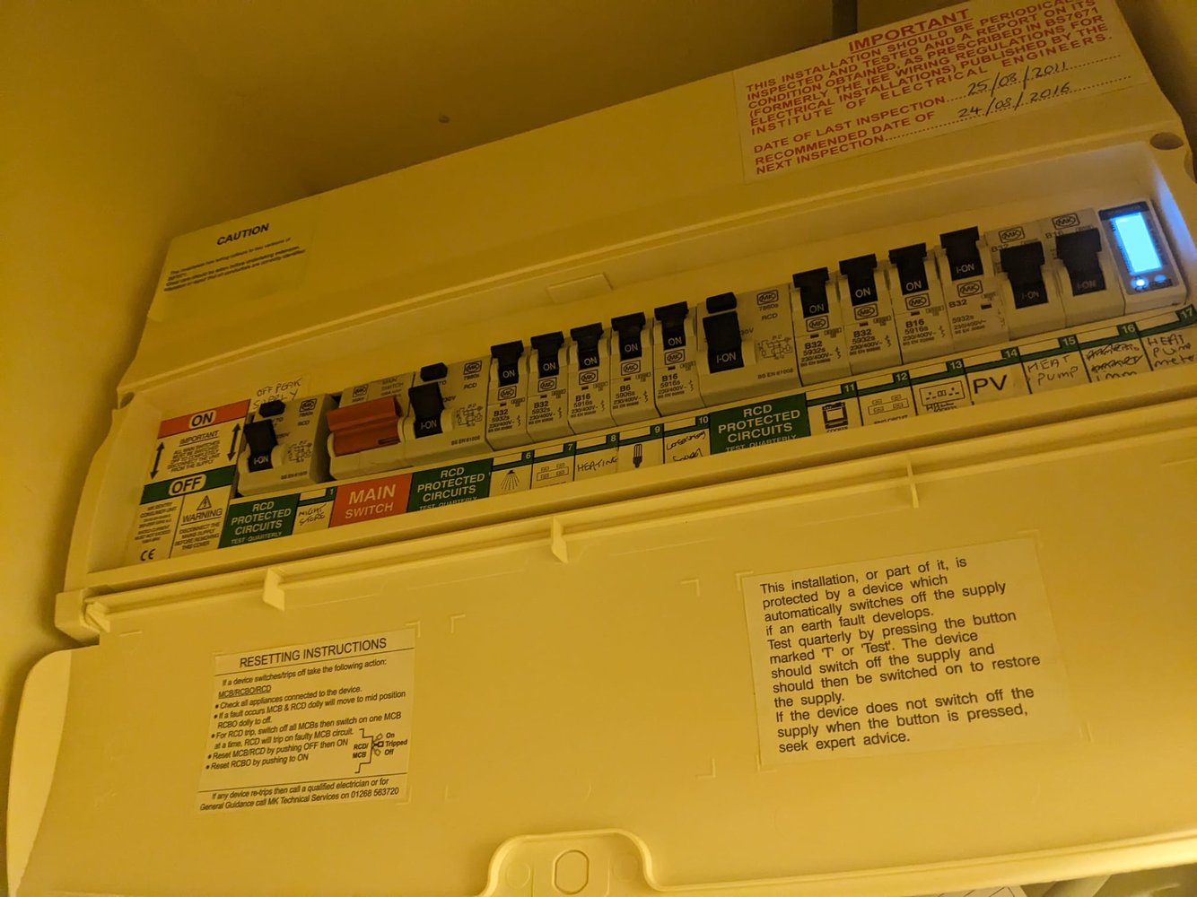

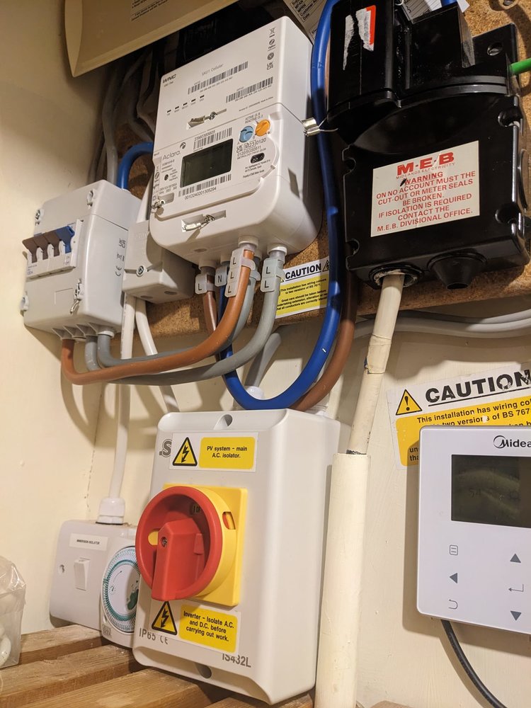

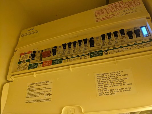

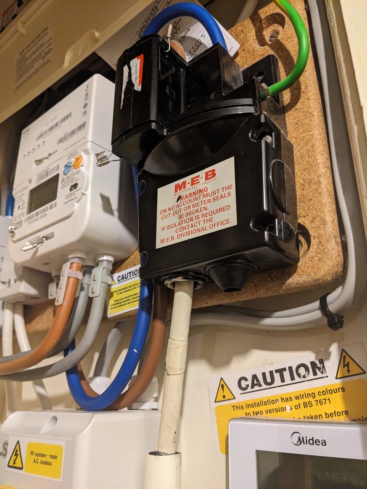

It'll be a week before I'm able to get over there and take a look myself, I've asked my sister to take some pics of the CU in the meantime so I can see how it's set up.
If it was a hard fault I'd tell her to just get a sparky in, but intermittent faults have a nasty habit of disappearing the moment a pro shows up.
