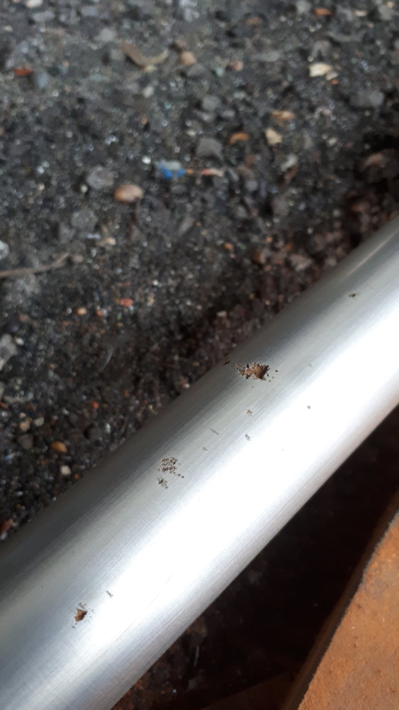

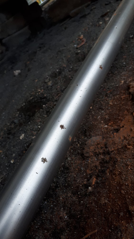

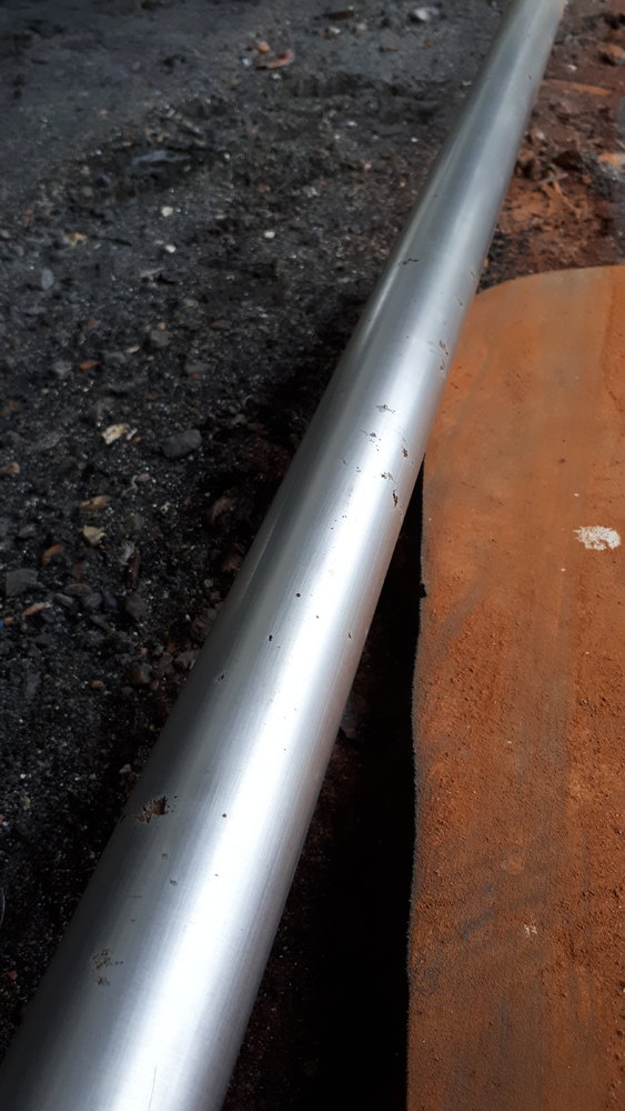

That will bend the shaft tigging little spots. Would not recommend that.This looks like pitting arising from inclusions or impurities in the material. The holes can be quite deep and result ultimately in stress fracture, if the part is under high stress. One solution might be to grind the pits back to clean steel, and use TIG with stainless filler to fill the depressions, then grind or machine to suit.
Yes, They sit in shaft tubes but the water doesn't naturally change much.Are thes out of the boat ?
So clean out the pits as best I can and the pickling paste?You need to mechanically remove what is causing the pitting which is probably ferrous material. This can be done with a wire brush grinder.
Then passivate With something like this:
Antox 71E Plus Pickling paste
<font color="#ff0000"><strong><u>Pickling paste is only used for the removal of weld burn on stainless steel.</u></strong> <br><br></font>Available in 2kg tubs with acid resistant brush. <br><br><strong><em><u>Discounts available on 6 x 2kg case purchase.(see discount page)...www.elmerwallace.co.uk
I would but they are 12 feet longIf they’ve been in the water for 28 years I’d be surprised if they will get much worse.
what about digging out on a lathe, pre-heating and a spiral weld repair?
that or have some new ones made…
if you can avoid welding shafts do so.I would but they are 12 feet long
