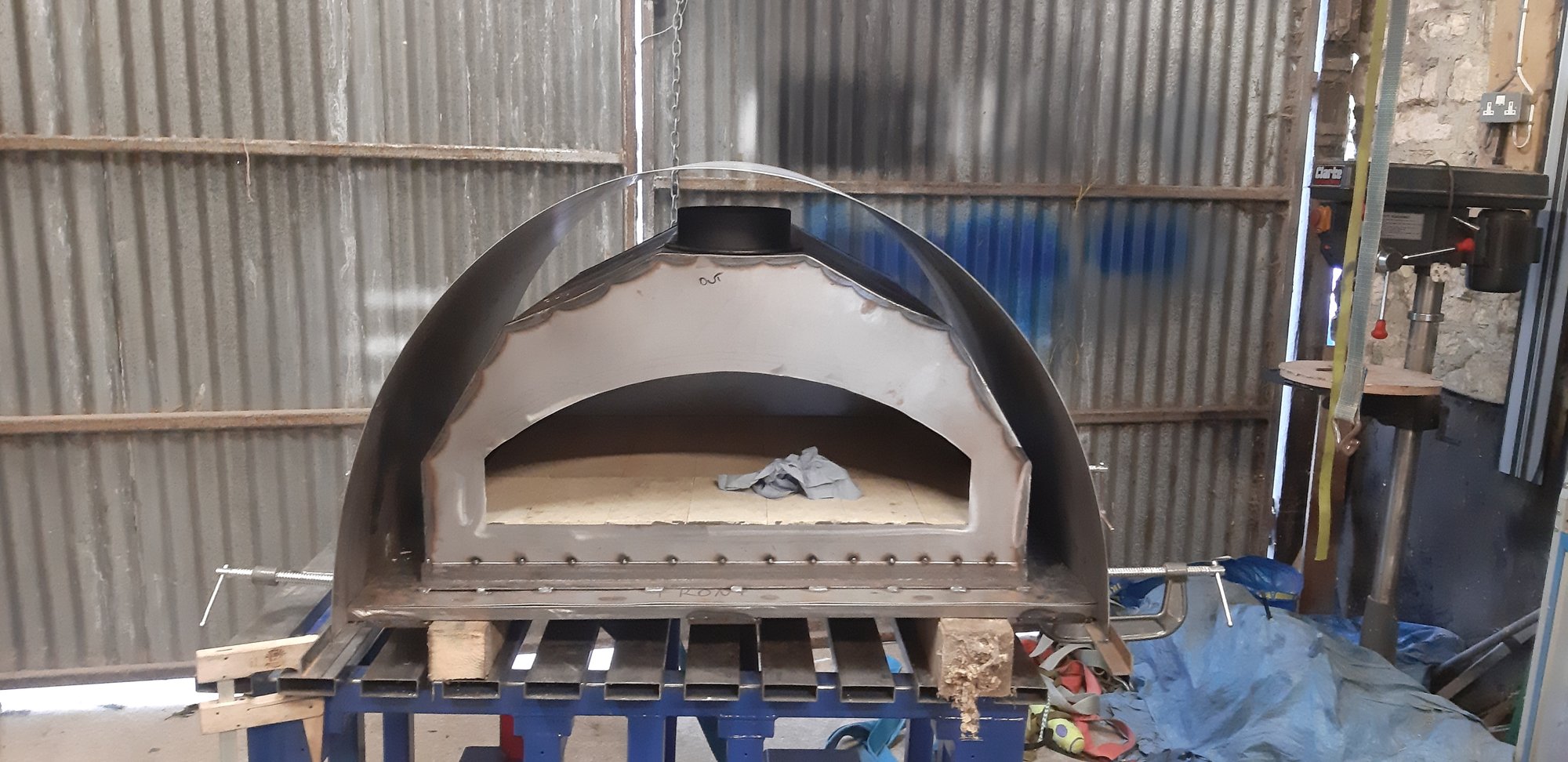

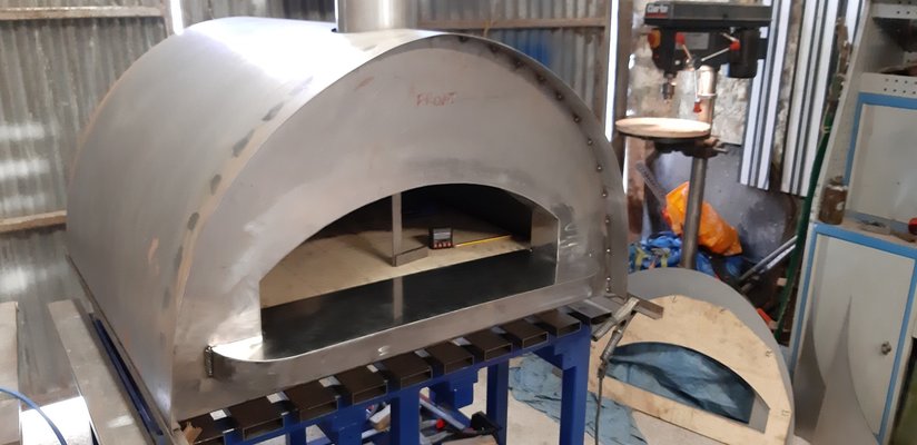

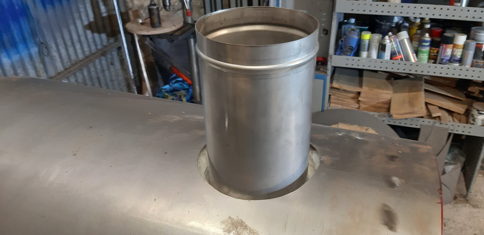

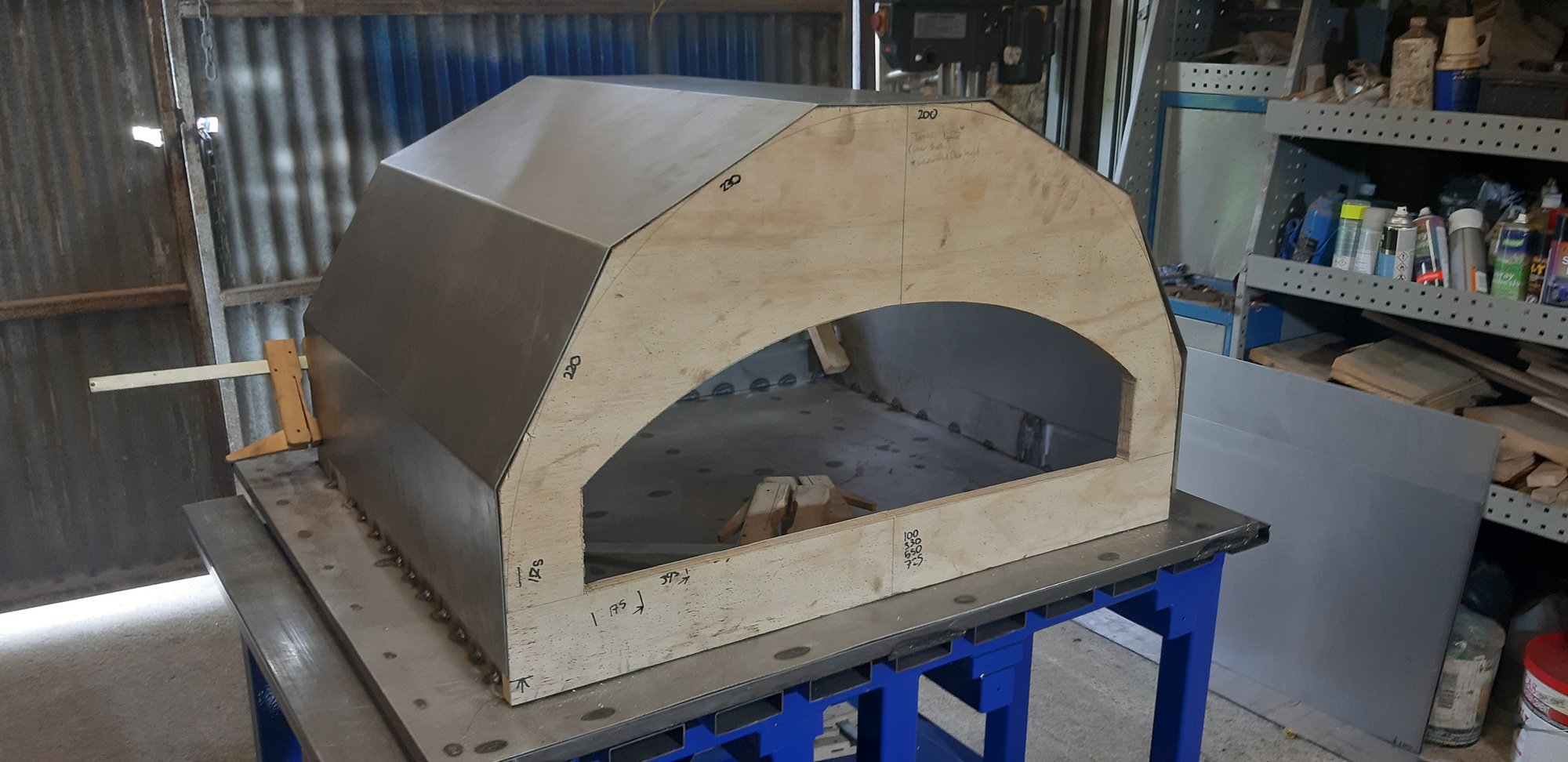

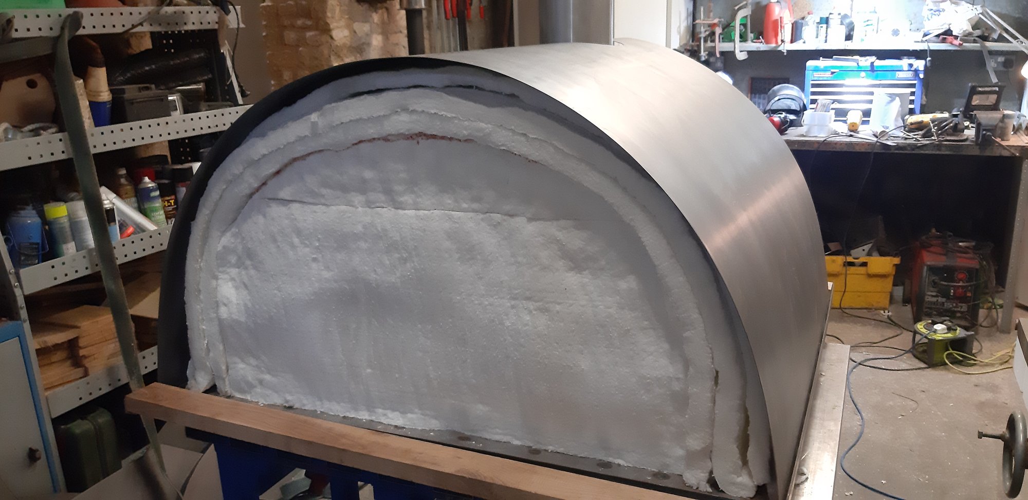

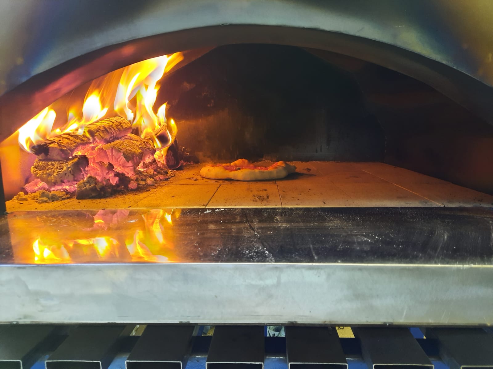

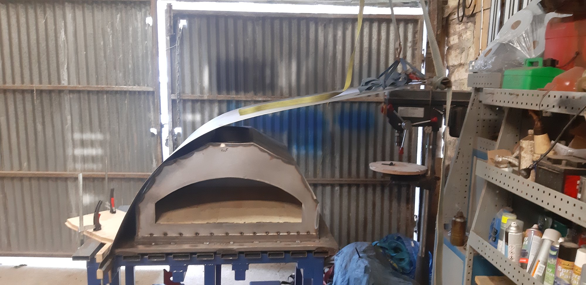

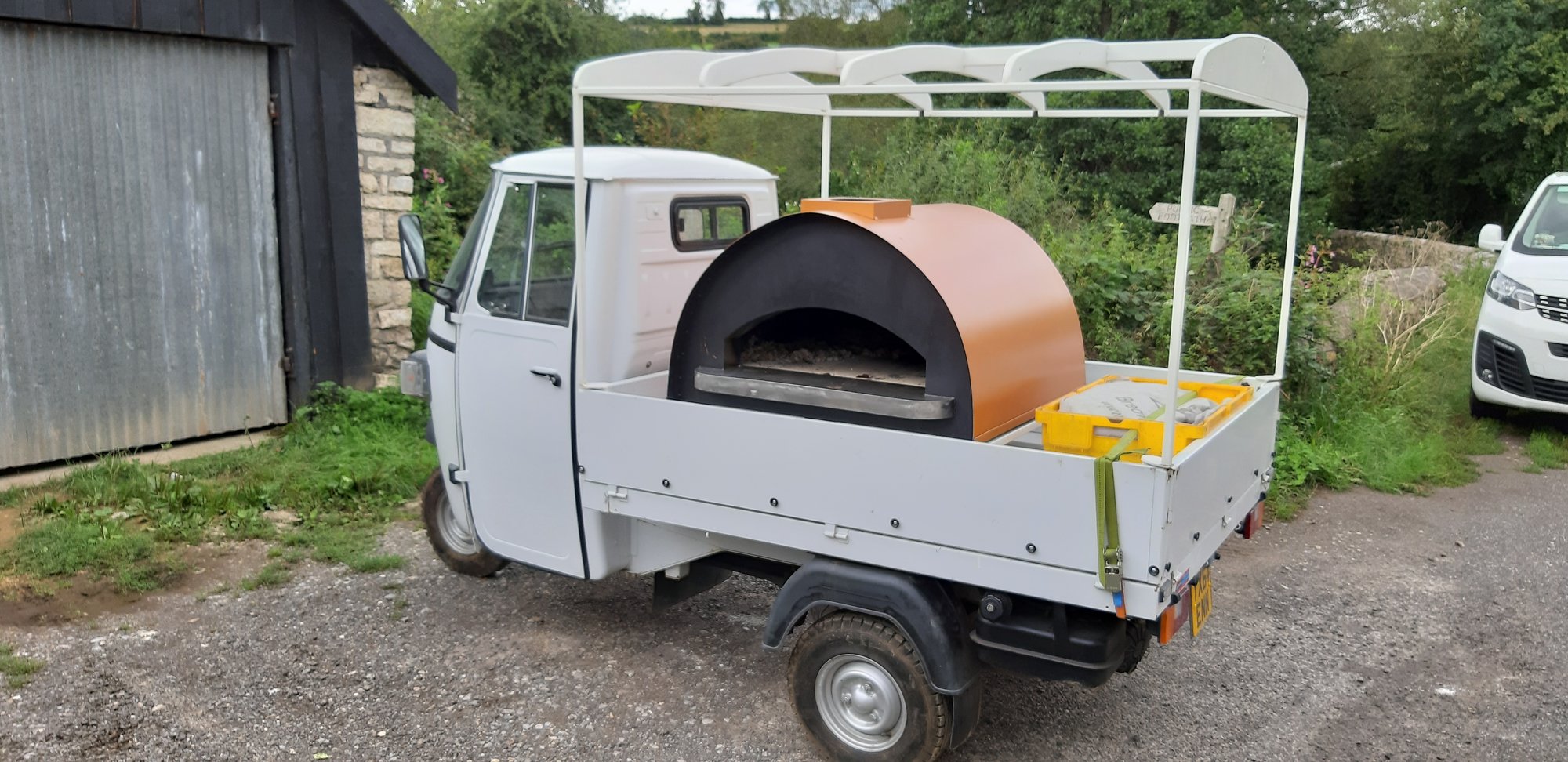

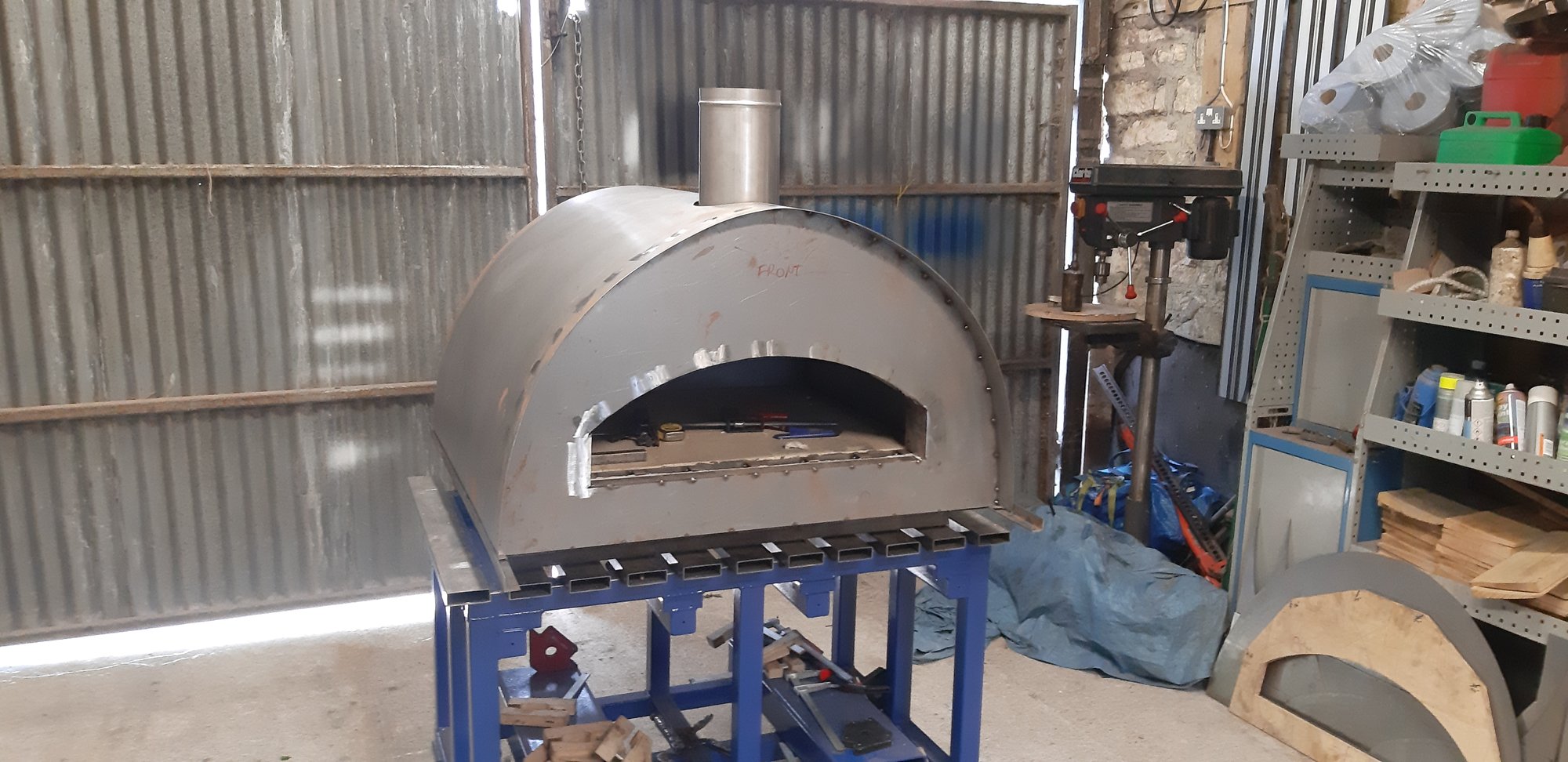

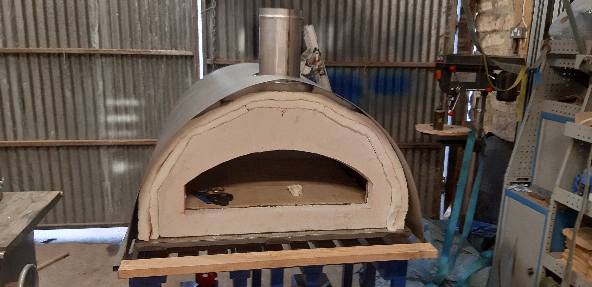

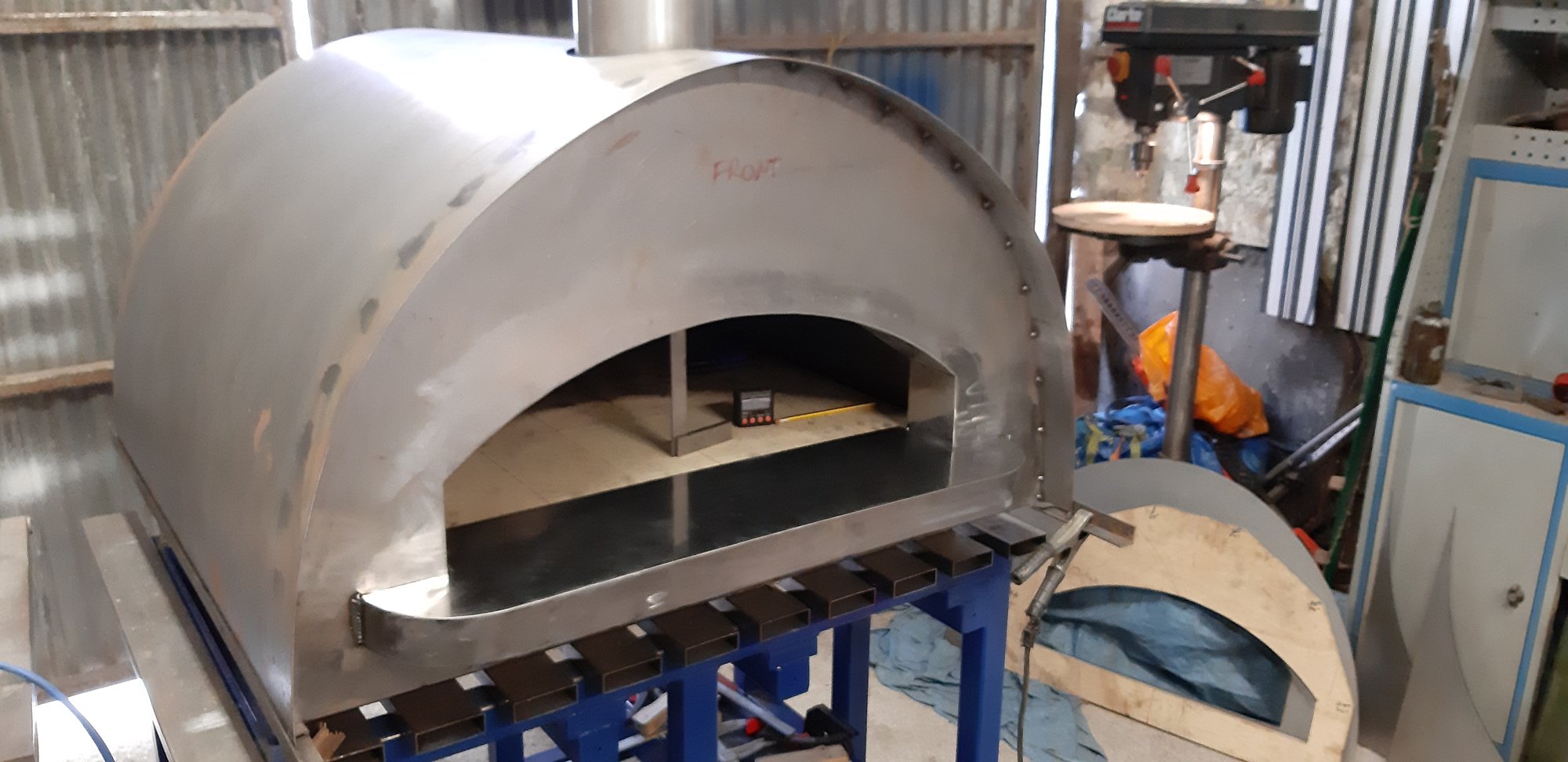

So I've decided to try and make a pizza oven. Twin walled with ceramic insulation. The inner oven skin is bent rather than curved. Its 1.6km steel about 700mm wide. I was going to try and hand bend it but after a quick test on some scrap decided I was going to struggle. I popped into Hiscock Engineers in Wiltshire. They did me a massive favour and bent my steel for me. They did me a great price, did it the same day and were a really friendly bunch. I would definitely recommend them.
