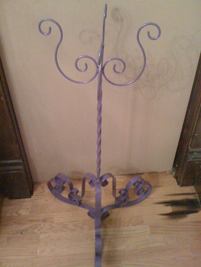

I haven't made these for 6 or 7 years. So today i dusted off my powered scroller and my twister and made one for a sample for orders. These are straight out of the shopoutfitters.com idea book of years ago. I used their scroller except i motorized it and i used my twister for the 1/2" center bar. The rest is 3/16x1 flat and 1/4" round for the basket holder...Bob
