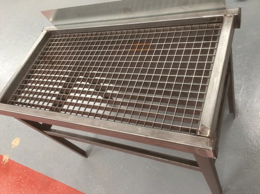

couldn't find anything commercially available and didn't want everything blasting onto the floor from the plasma so..
Got started on a table with sunken grid so I can G clamp stuff and support it without cutting through the blades every time. Tig'd the box ladder and just mig'd the rest but wish I'd taken more time on it but, it's meant to be functional. Going to box it in and put some extraction on it when time allows (in other words it may be some time)
