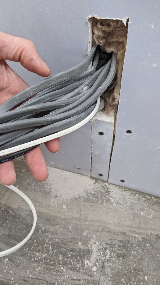

These cables will go into the side of an adjacent 30cm kitchen unit and I'll terminate them all on a panel hidden behind the 30cm kitchen door.
The cables are for the fused spurs and timers for the electric radiator, underfloor heating, extractor fan etc.
Any suggestions on a gland/box that would accommodate the cables to tidy it up a bit although it will actually never be seen once the installation is complete.
even filling the hole is posh stop a bit of draught and thats about it
no it doesnt the only time fire stop is needed if cables go through a floor or ducting or walls namely in flats and public buildings to stop any spread of fire . the wall is only half inch plasterboard on battens and cables go in to a kitchen unit that has a plinth and backs in cupboard ive fitted underfloor electric heating since it 1st came out and fitted loads theres nothing to set on fire
