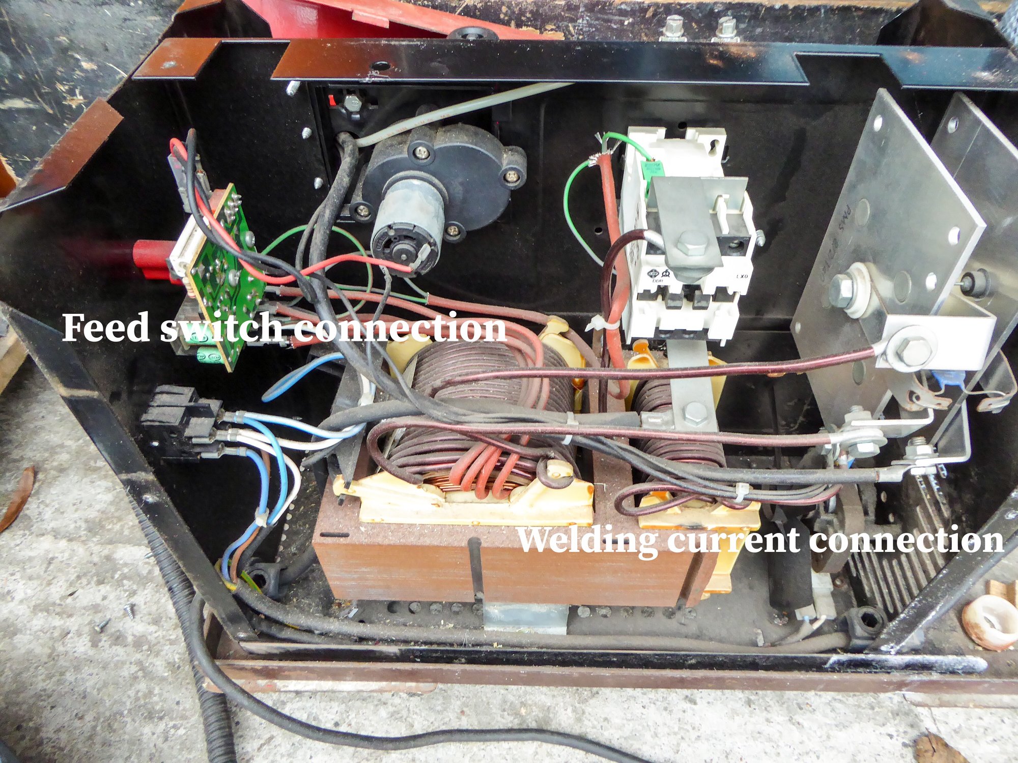

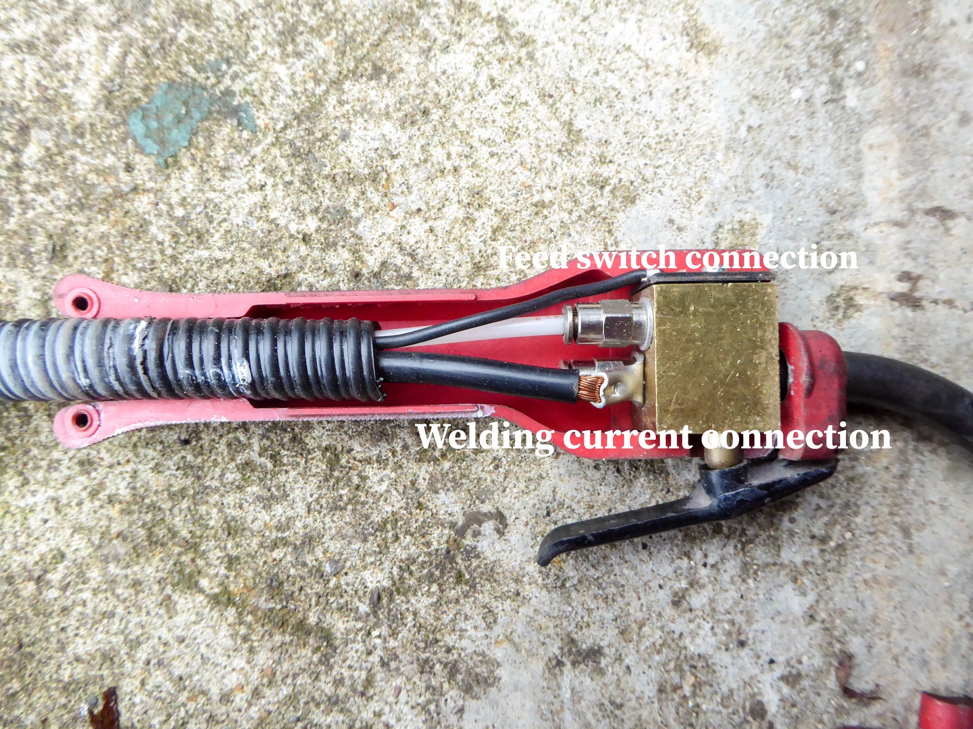

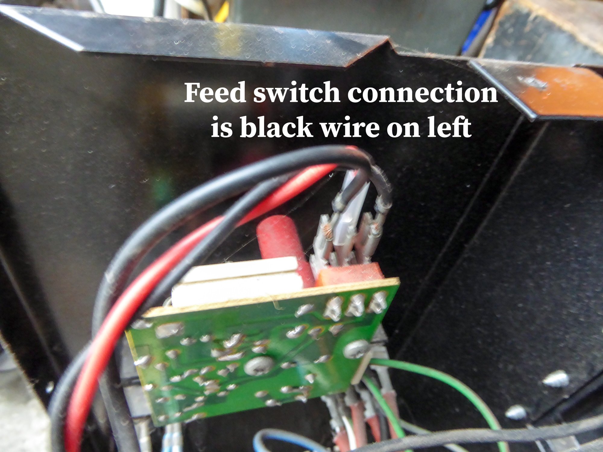

I was recently given a pocket 130, and the chappie had pulled the broken wire feed mechanism out and removed the torch etc. I have got the torch, and bought one of the "ebay special" wire feed mechanisms. I should pop into the garage today to make a tray adaptor to get it lined up nicely, but....
I have no idea where each wire connects. ie the main power cable and thinner "trigger" wire from the torch. Plus a pair of back wires that come from a common connection to a main "coil" near the back of the welder. I presume the red wire goes to one of the motor connections.
So a picture or two, or where I can find a suitable pic would be great. I have lost the plot searching (keep getting other welders, or pictures that don't show enough detail)
Thanks
Clive
