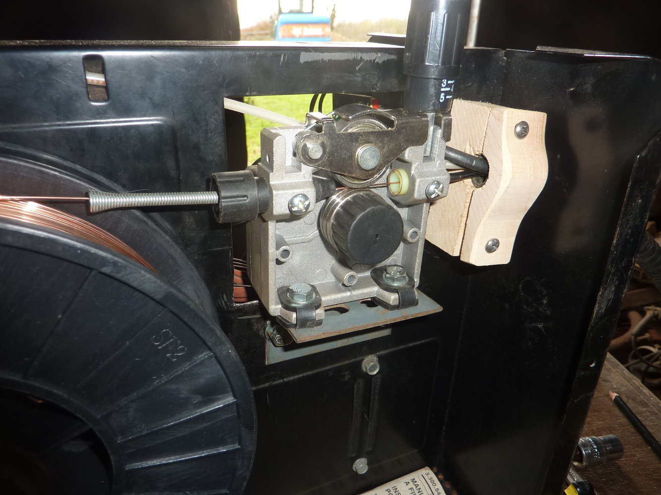

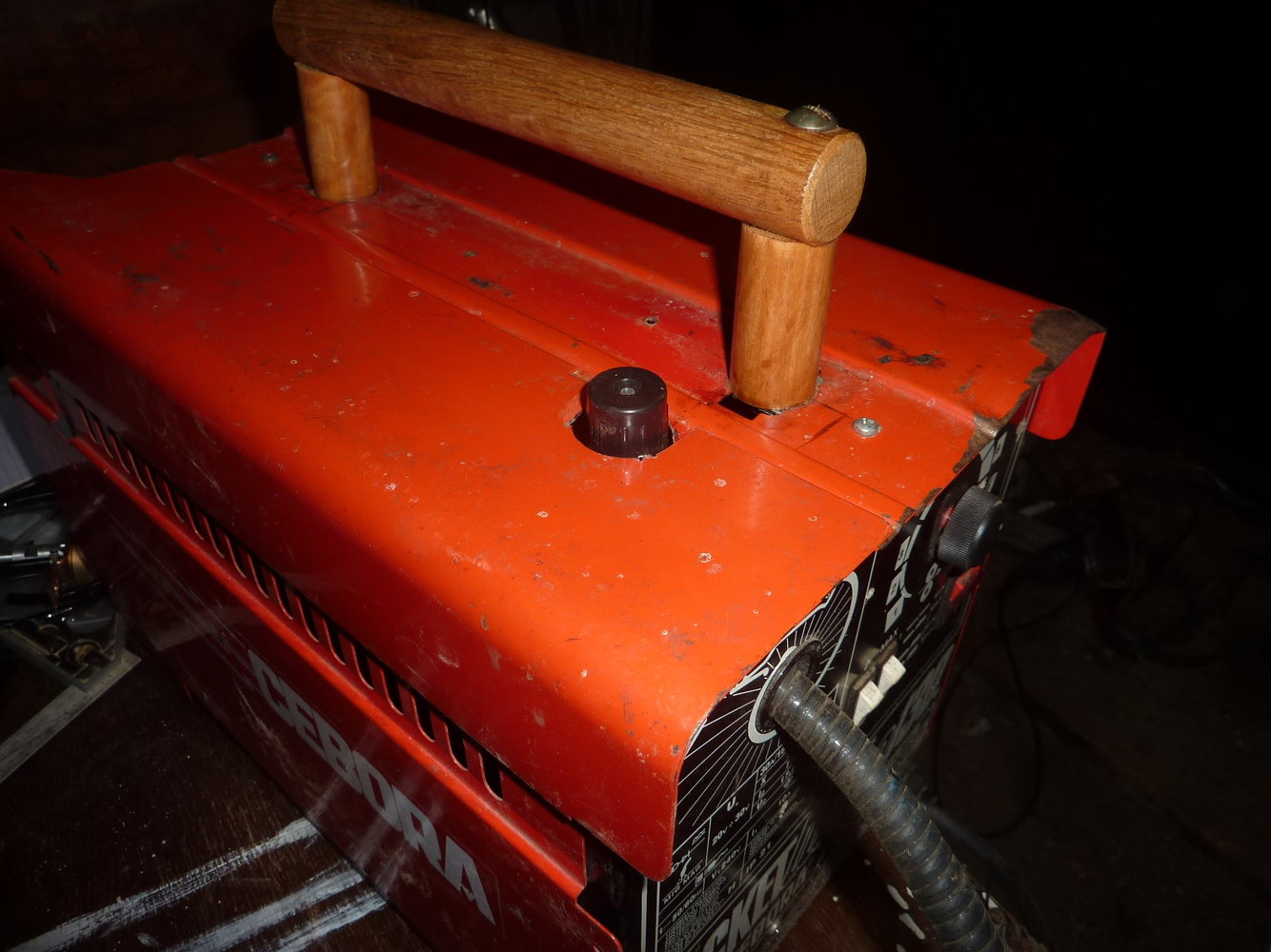

The wire feed on my welder works fine if the gun hose is fairly straight, but becomes erratic if there is much bend in the line. Most migs seem to have replaceable feed vee rollers of 25 or 30mm dia. The Turbo130 has the vee feed direct on the gearbox shaft and is about 16mm dia. and I suspect that as the machine is maybe 35 years old the vee is worn and slipping. Has anyone tried making a thin walled sleeve with vee to fit over the shaft? It would need to be thin or the tension arm wouldn't fit and wire feed could be too high. Would this help?
If that isn't feasible are the cheap feed motor assemblies on ebay an improvement? - I dont want or need to go down the euro torch route - so just a substitute of the feed drive.
