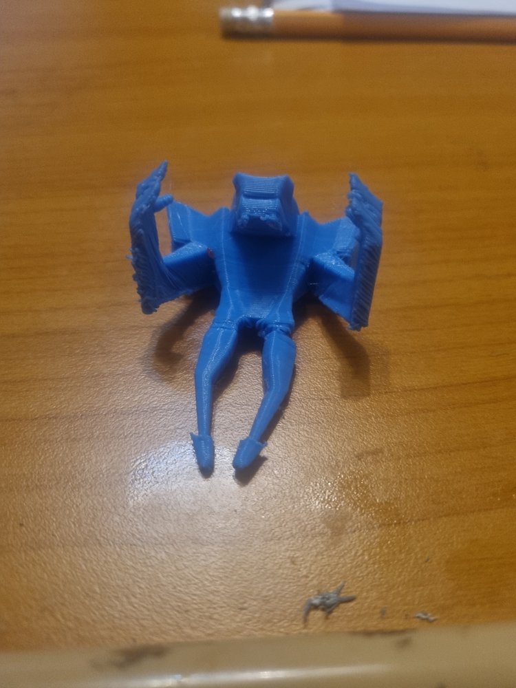

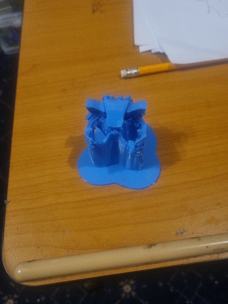

I am using cura and cant get this thing to resize in cura or drop to the bed either.

Why do some do this and others don't?Yes. It's a chore. I scaled it by 0.1 then fiddle around with the XYZ. Get Z sorted first by sighting along the horizontal. Then move X.Y individually until the shadow falls over the bed...

Middle is lay flat (cura has it's best guess at laying flat).
Right is select face to align to build plate.
You are selecting the stl before you select the lay flat?Found it but sadly it does not work![]()

First you need to select the object you want to orientate, or the menu won't even show.Found it but sadly it does not work![]()
It's actually on thingiverse....I have not experienced a model like this in Cura. It is so far away from the origin that the interface makes it very difficult to orient the model. So you can drag X and Y until the cows come home but there's no easy way to tell if it's getting closer of further from zero.
The only way I could recover it was to bring the bed to eye level and drag Z until they align. Then looking down from above (as much as is possible in Cura, drag X, move, drag X ad see which way you moved etc.
So it was a tricky one. Undefined or incorrect scale and miles off origin. This is why I suspect I will have to move away from STL and get into STEP (so to speak).
