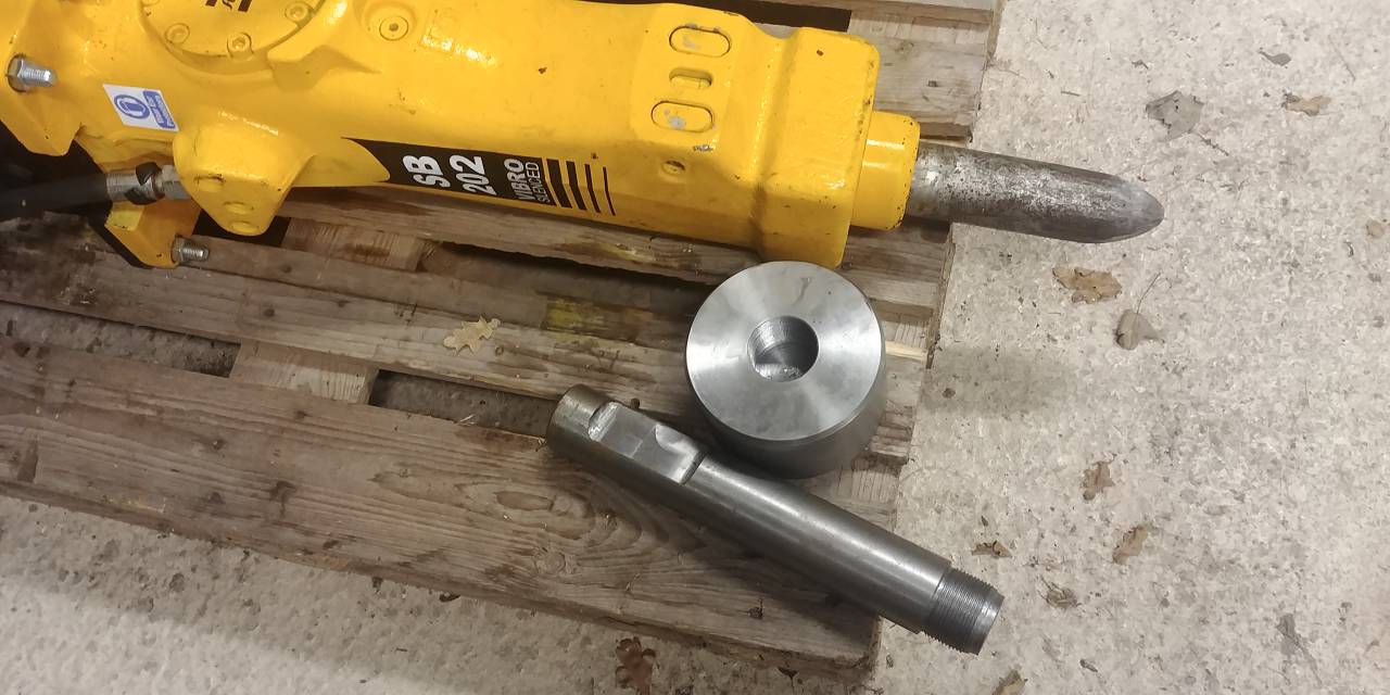

That was going to be my next questionI shouldn’t worry about the material of the cup too much but on what material the old chisel is and how you’ll go about welding it.
A mate made a smaller cup for putting in marquee poles with a breaker hammer, it was just mig welded with no pre/post heat....it split right round the weld between chisel/cup

. As it stands the only thing joining the stem to the cup is going to be the weld - I was thinking if I thread the end it should take a lot of the stress off of the weld, or am I over engineering this thing.
