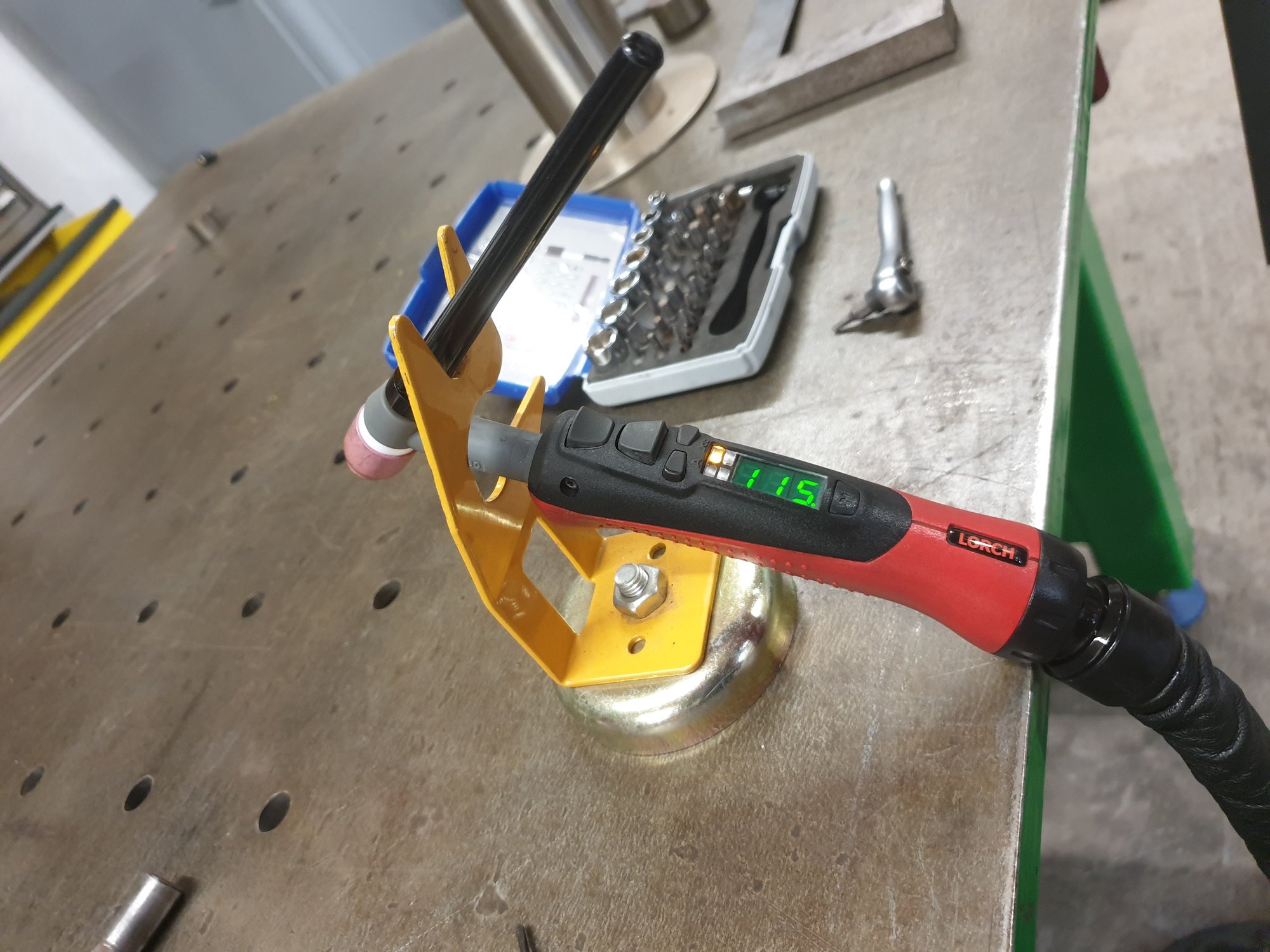

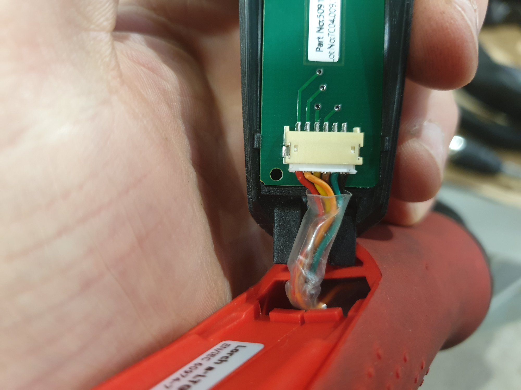

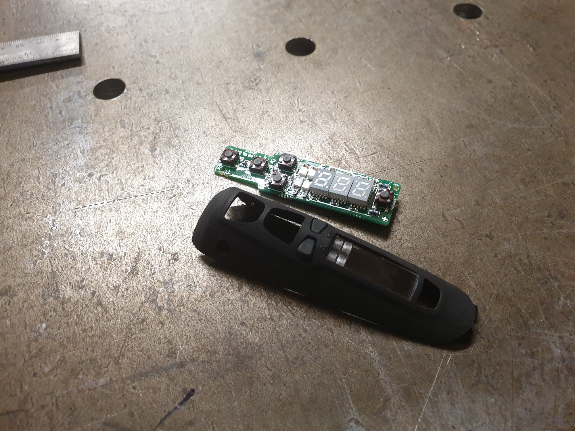

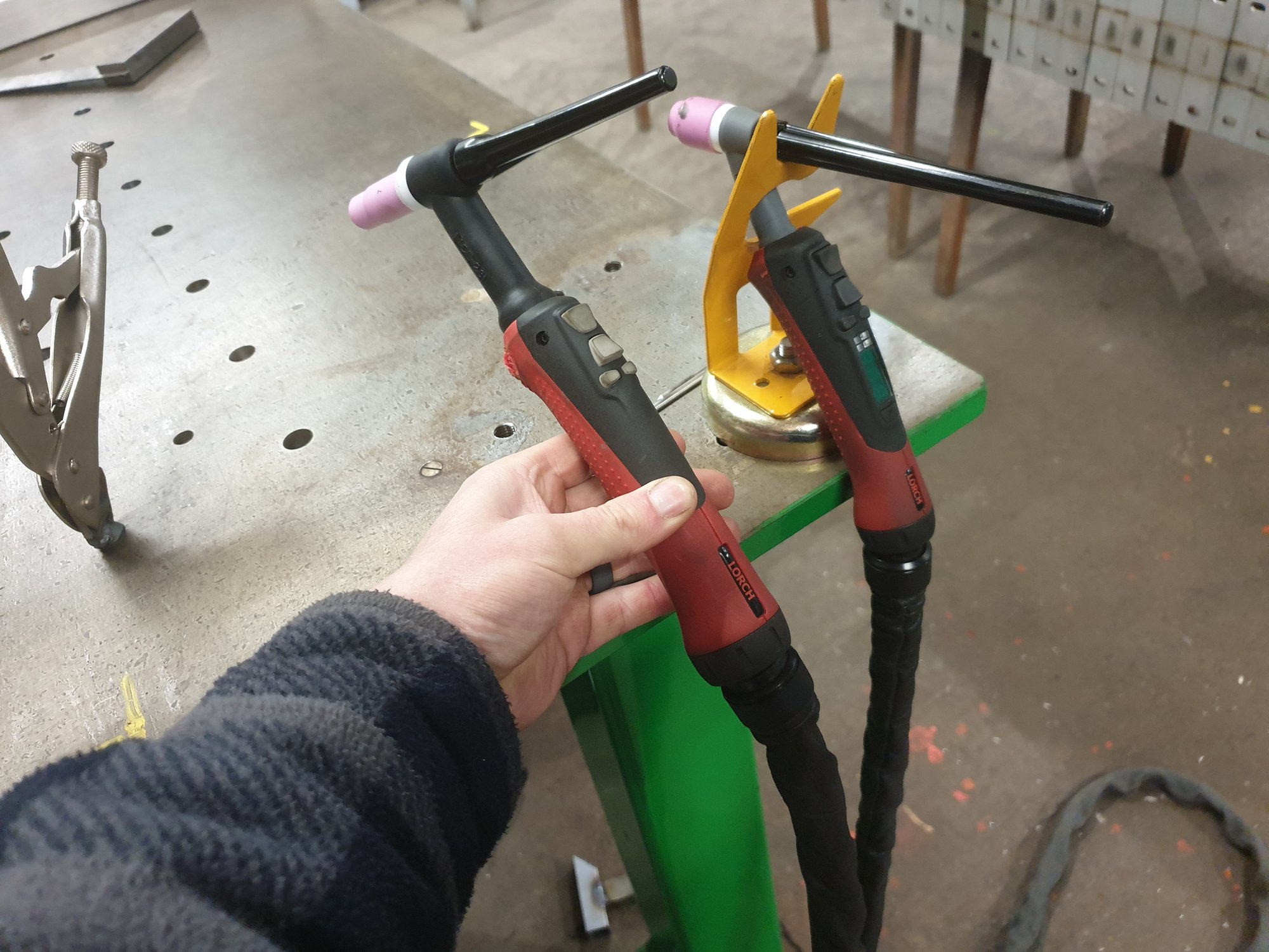

They’re greatI've been after one of these for a while... Anyway Express made sure it would work on a plain updown torch, and then sent me this
On the MIG, it is literally invaluable.I've put around 10 hours on it already now, and it's perfect for what I do.
I've been using the updown torch since last year, and setting two job programs on the handytig works perfectly for welding box section, since I'll have the butt joint set 20 to 30 amps colder than the fillet. I have literally tens of thousands of 50mm welds to do on batches of trestle legs over the next few months, and using the job programs helps speed and quality. The major downside of the updown torch is having to look at the machine to check your amps.
With the powermaster, it's right there at your hand. Saves a few seconds per weld... It all adds up over thousands of welds!
If you're working by the hour, it's a nice to have. If you're working by the job, then honestly, this torch is simply brilliant.

If your standard torch has the newer style cable and connection in the handle, it can take the powermaster control according to Express.Ah you can up grade your torch may have to do it too mine if i can though its just the plain start stop and secondary amperage setting one.
Cheers will have too look into this furtherIf your standard torch has the newer style cable and connection in the handle, it can take the powermaster control according to Express.
