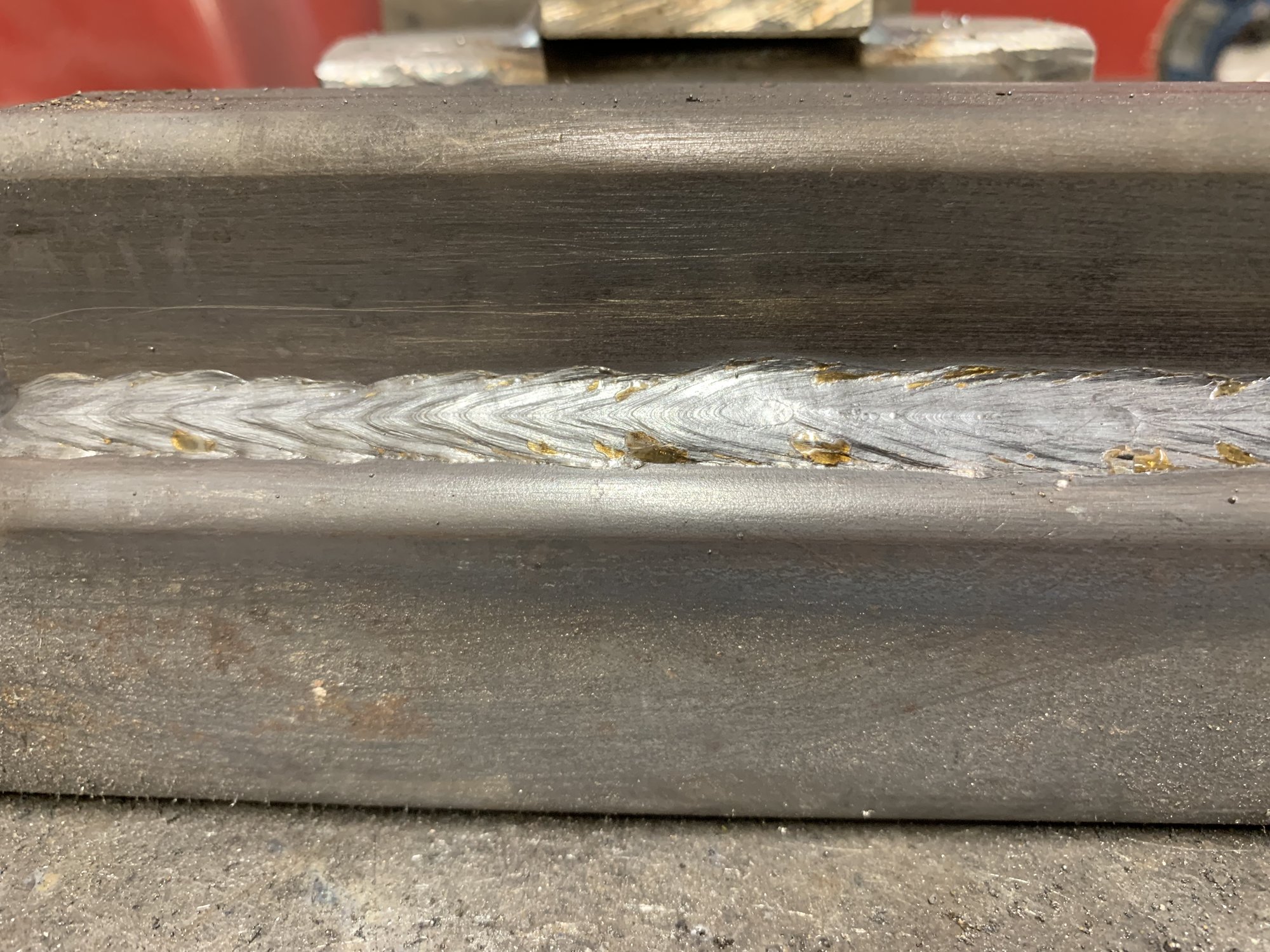

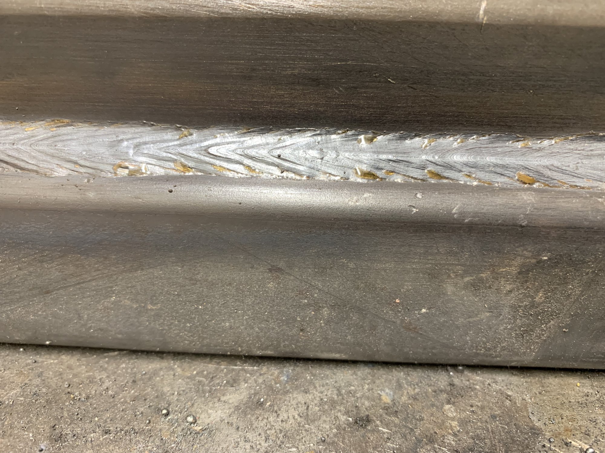

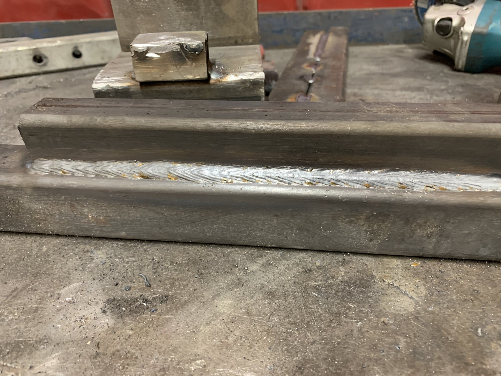

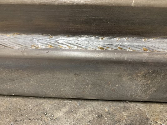

I’m practicing for my first weld test at work in my new job any advice would be great all my weld are looking like this
are you dragging that ?id be pushing
another wee tip,always pre heat to above 100c as condensation forms in the joint when you weld on cold plates then comes out as steam ! you will have pores and worming on the surface .
