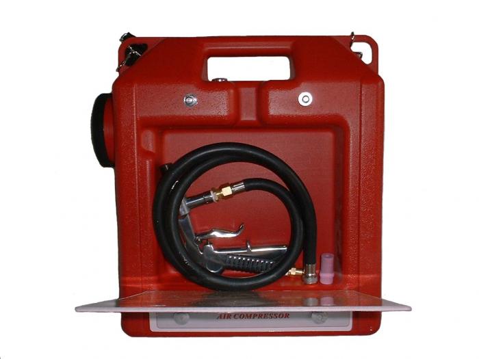

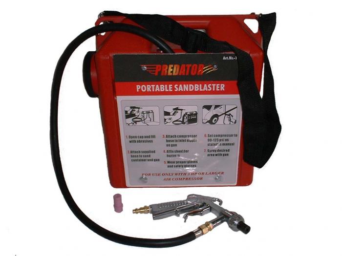

Do any of you have one of the predator portable sand blasters & if so are they any good?I have just seen them on evil bay for about £17 which seems a bit cheap.
Looks like it has a suction gun, which aren't a patch on the pressurised pot systems available on ebay. If you use sand or similar grit the nozzles won't last verry long so make sure spares are available.

No the pressure & suction guns work on completely different principles. In a pressure system the media container must be capable of working at around 100 psi, x2 for safety.
