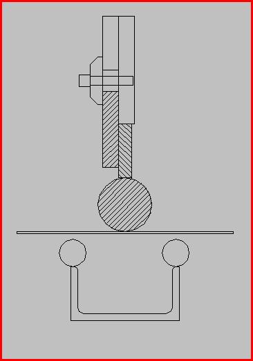

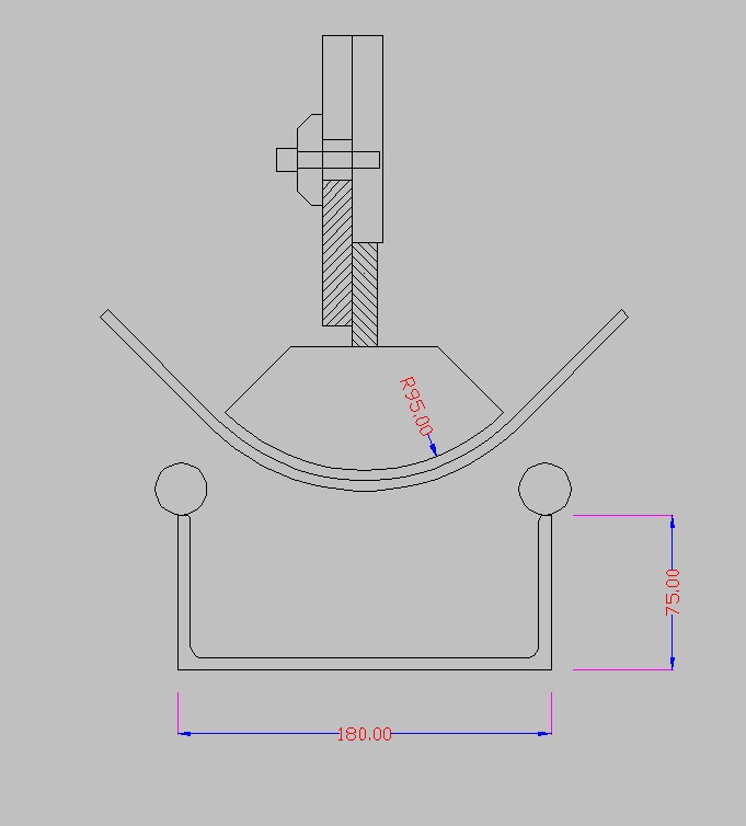

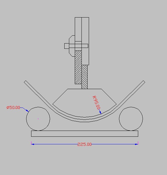

I need to press a 100mm radius along a 400mm long piece of 5mm steel. I have made a tool with a half rad press tool that pushes into a 150 x 150 90 degree angle.
My part is coming out under bent? I was just after advice on what angle i should make my female tool to achieve this?
I only have a small press (stroke) and we have been pressing these with success for a while but would like to ammend the tool so we can press them perfect.
Any advice would really help us?
