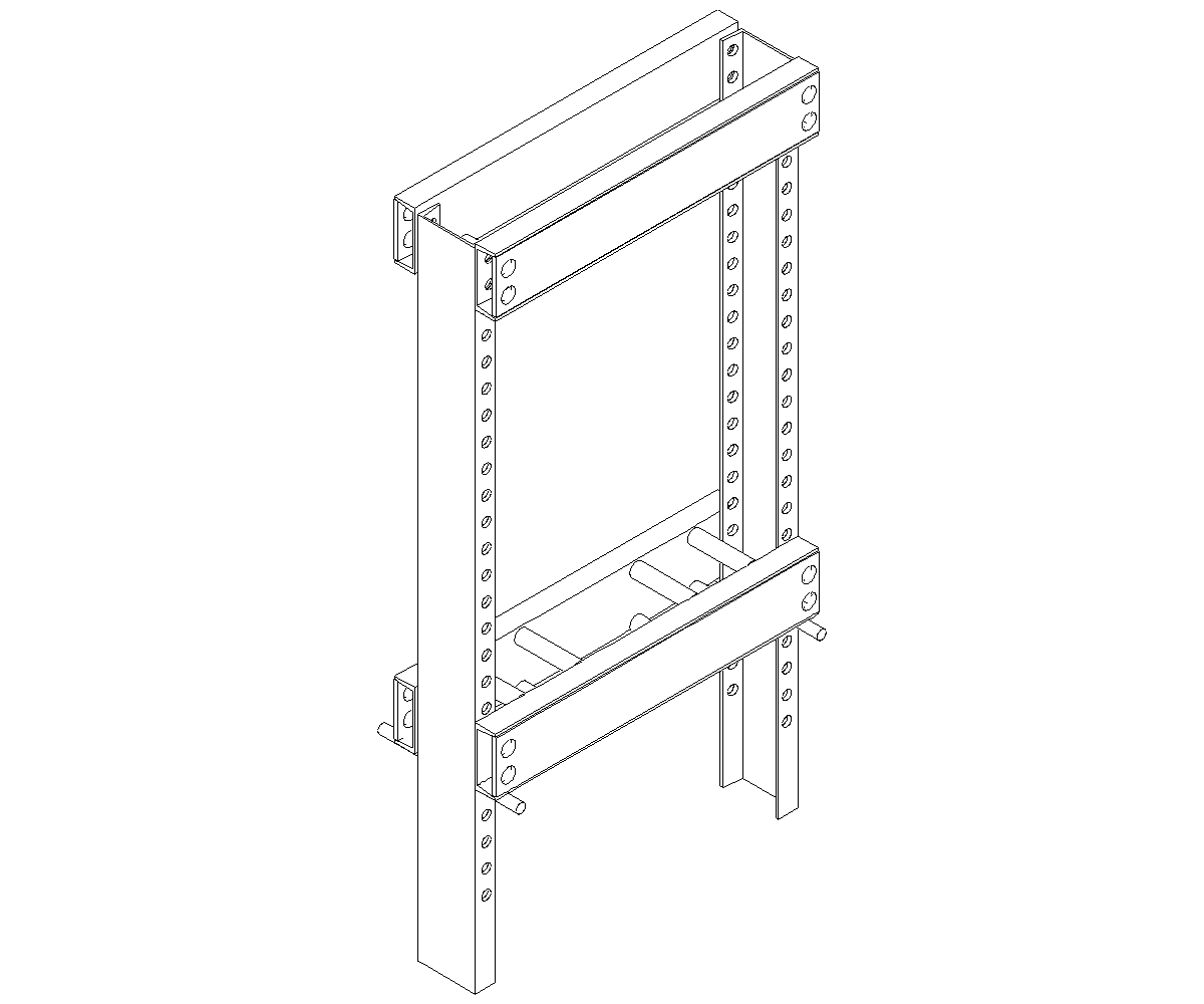

I've scrounged up enough to build a hydraulic press, 10-ton bottle jack, some fairly sturdy 125mm x 45mm hot-rolled channel section and some 10mm and 12mm plate, wondering how to join the top "lintel" to the uprights, simplest might be a pair of 24mm grade 10.9 bolts through the lot, wondering if it would be stronger to weld the parts together (given decent welds...) or perhaps weld after bolting up - any recommendations?
I'm hoping it'll look something like this:
It'll be 24" between the uprights (27.5 overall), 55 tall, planning to weld some 12mm plate into the open side of the horizontals and hang the bottle jack between the "lintels", couple of lengths of hefty angle (not drawn in yet!) spanning the bottom of the uprights.
