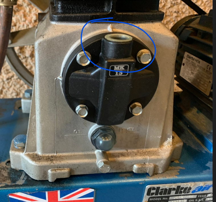

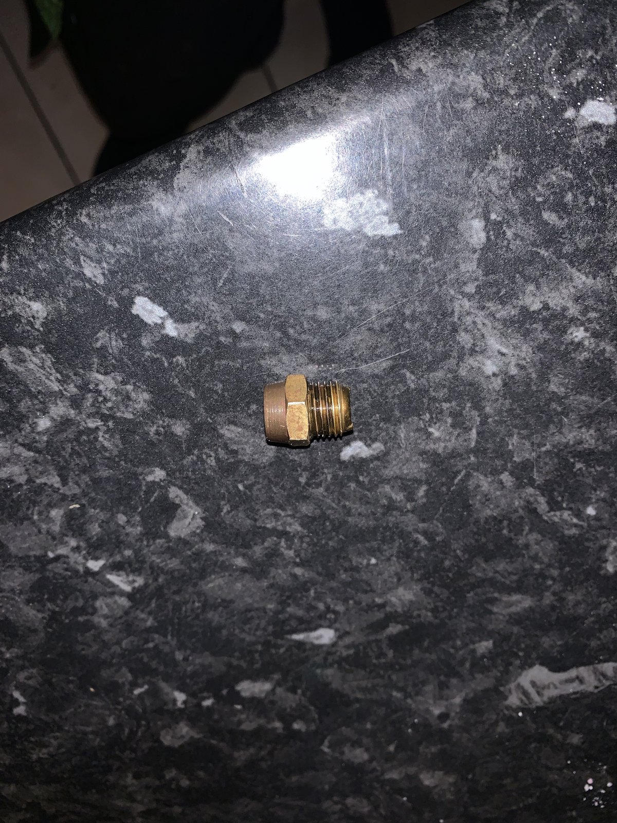

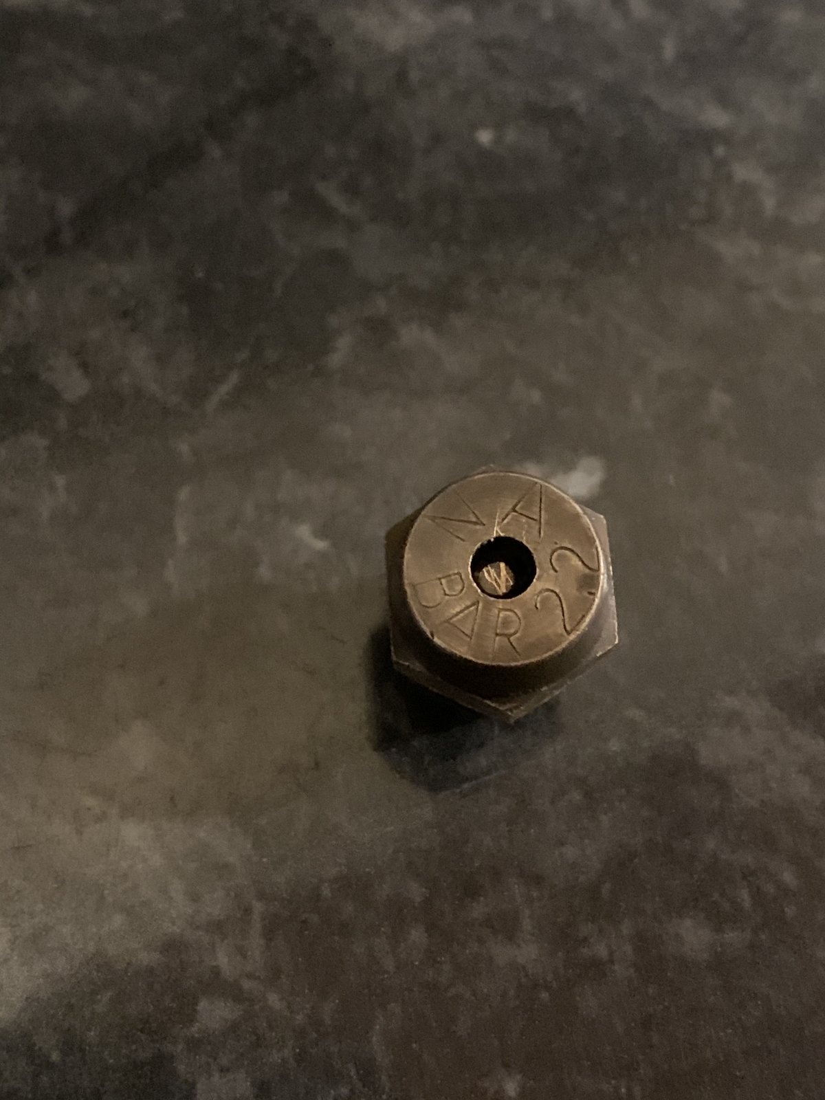

looks like the wrong one if its the safety valve on the tank if its the case u can get adjustable ones and it wants setting up about 5psi more than the pressure switch max settingThe valve is rated at 2.2 bar if I'm reading it correctly. That's around 30psi. Are you sure that you have the correct item fitted?

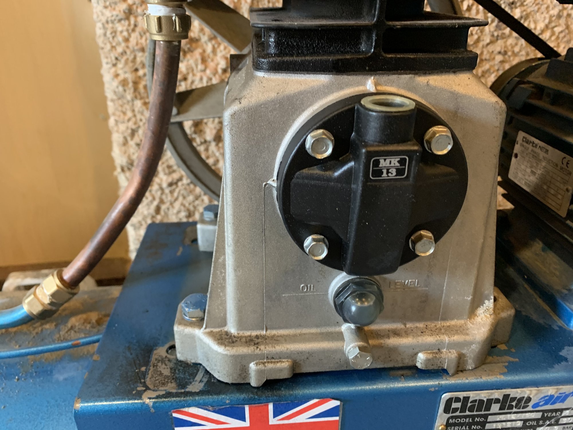

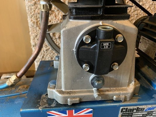

Are you saying that plug is here....
.....as that would suggest it's the oil filler/breather. If this is blowing off then you have some other issues as the crankcase is getting pressurised.

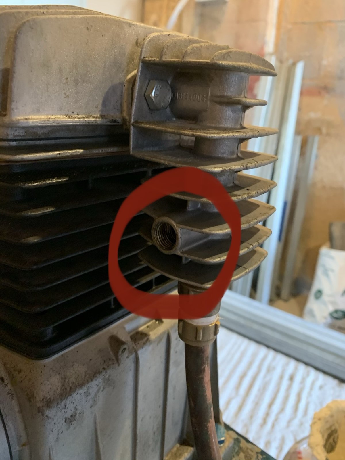

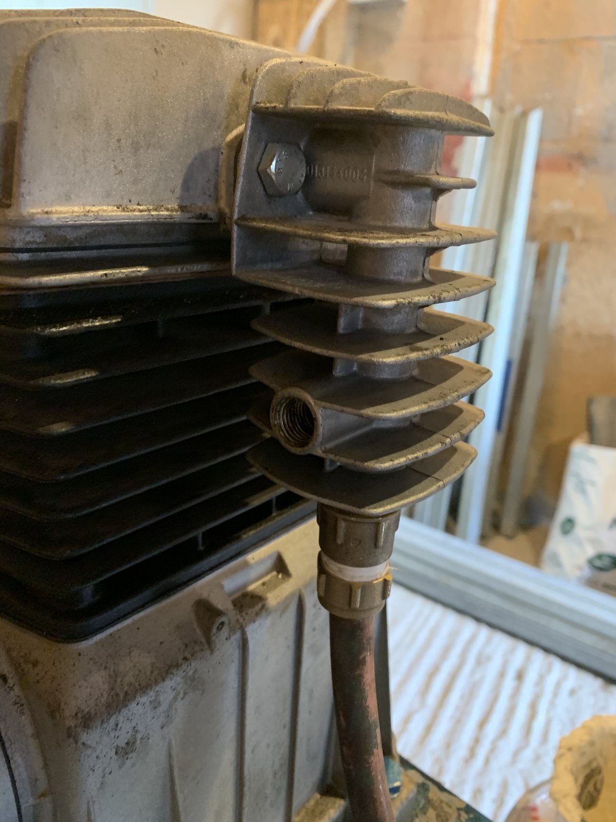

buy a new one rated over your cutout pressure theres your problemMy fault, no sorry 3rd picture in

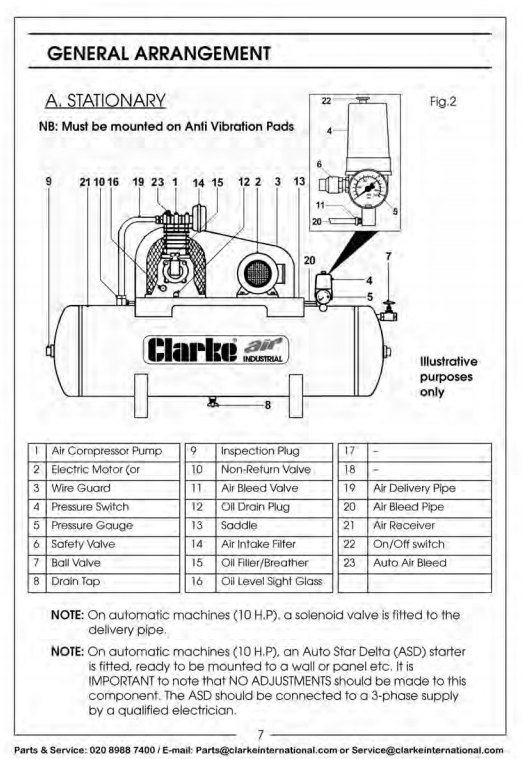

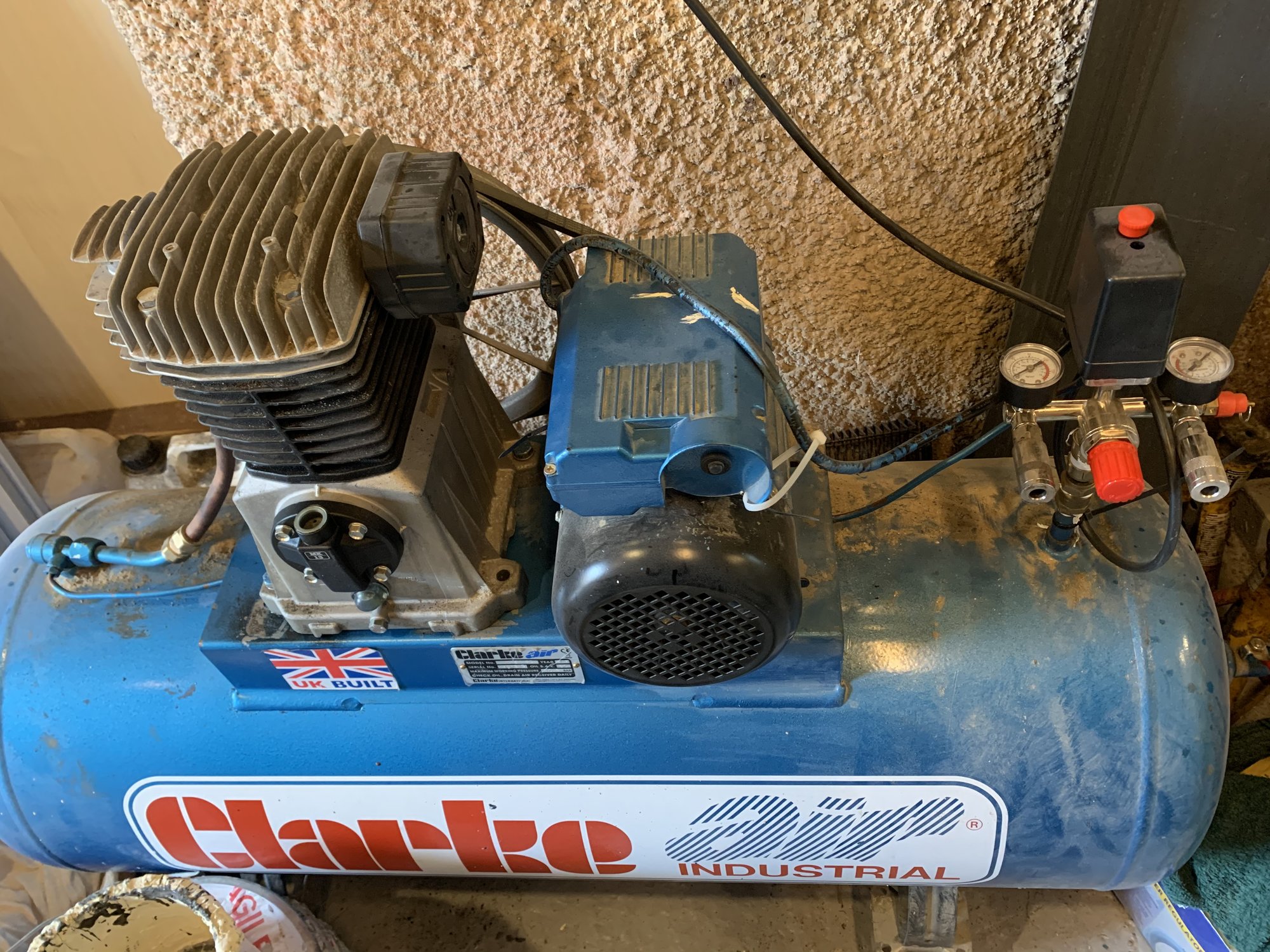

I don't think these are safety valves, these are in the delivery line and bleed off the air when the compressor stops, as AL Strachan mentions above. I'd order one from Machine Mart, I think item 23 on the pic below....Machine mart sell a 11 bar one but you need to check the pressure rating of the reciever is higher than the safety valve
