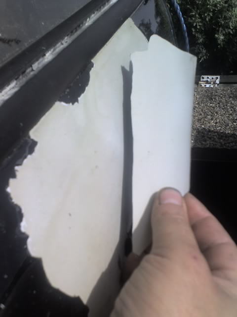

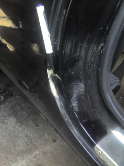

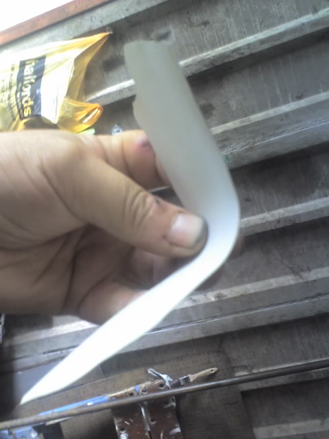

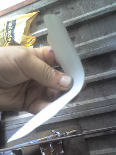

My Scimitar was professionally resprayed about five years ago, they had to do it twice because the paint blistered soon after the first try. It's now doing the same thing, an I'm wondering what's going on. The blisters start on concave areas, it's as if the paint is shrinking and pulling itself (and a layer of primer) off the primer below.
Suggestions from local bodyshops include water in the GRP which I doubt because the car was low-baked overnight before the painting, and rubbing down between primer coats with too-fine a grit paper.
Any other ideas? I'm going to try repairing the worst of the bad bits but I'm curious about why it's happened.
