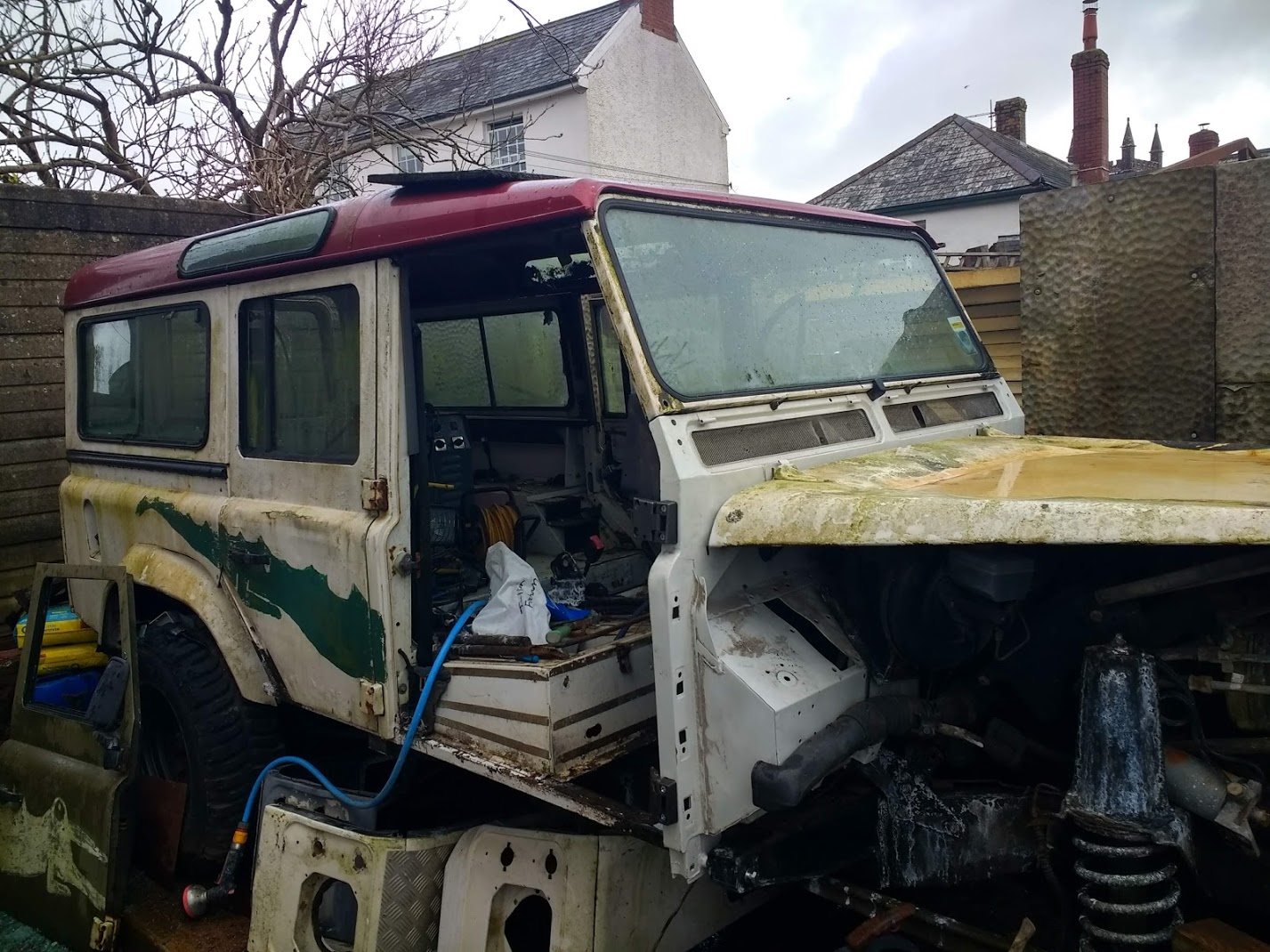

So, ive got this bulkhead -
Its going on this monstrosity -
(yes, i got it years ago, but have had a bit of a pause!)

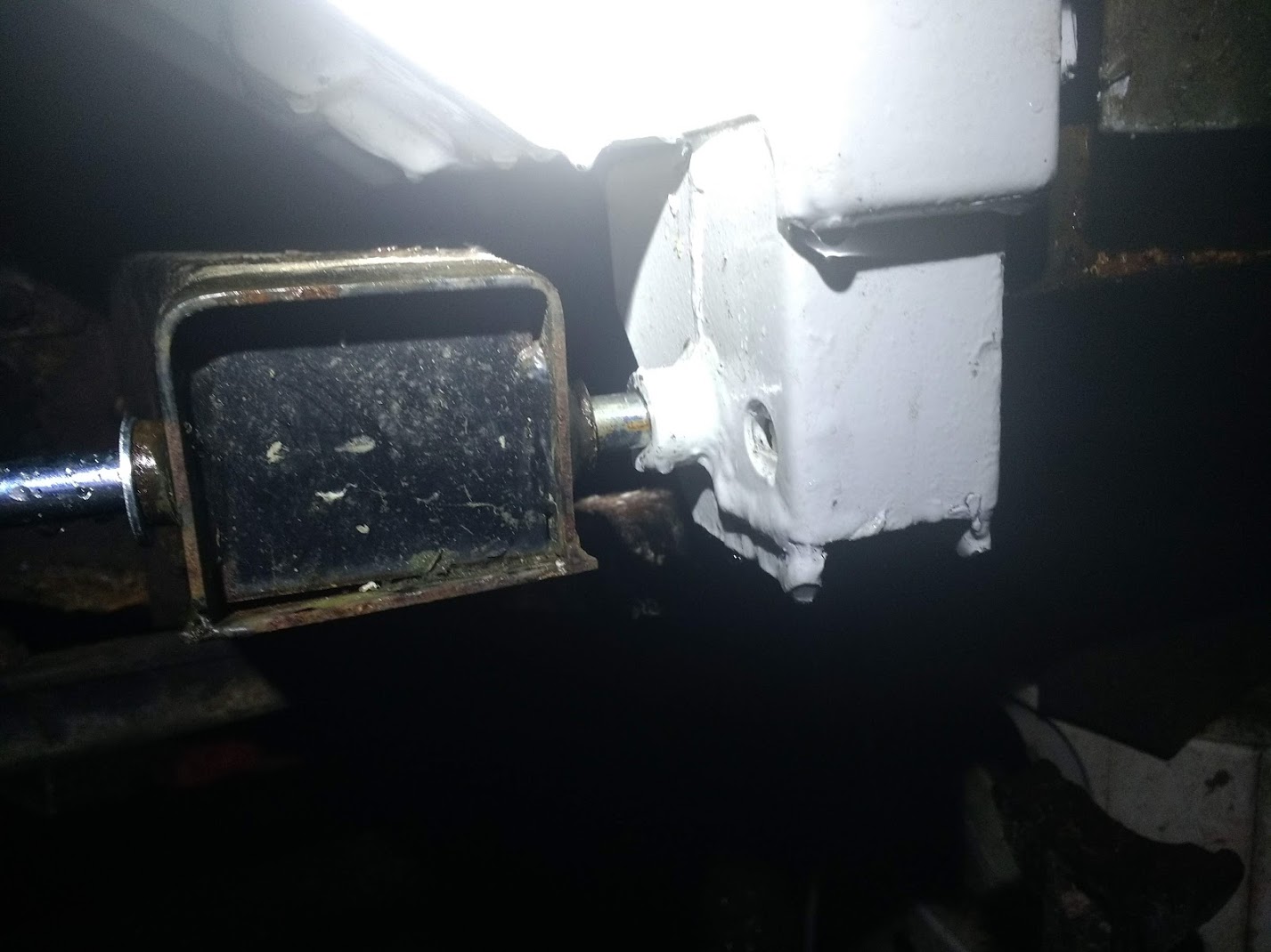

So here is the foot -
You can put spacers in that gap (its not "spaced" nor tightened up in the photo), but the more spacers you put in, the tighter you close up the gap at the bottom of the door.

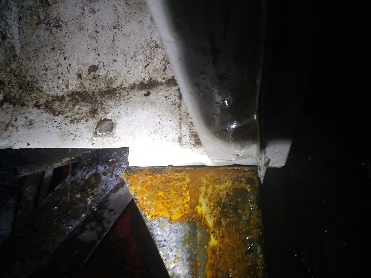

Also, the more spacers you put in, the closer you get to the sill. At some point you conflict. Im talking this part (but this photo is on the other side to all the others) -
My point is, you cant just keep adding spacers, otherwise you mess up the bottom door gap, but also have to shorten the sill! (and yes, its a fabricated sill, but its spot on dimensionally against a stock one)

So, to recap, you have the fowards / back adjustment using the spacers on the foot / outrigger joint, and that seems set right (bottom door gap is fine), and this is also a pivot point.

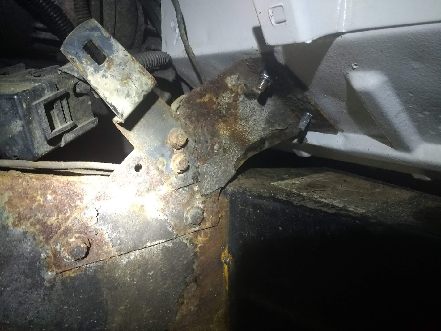

...which is maintained by this bracket -
Which mounts to the footwells, and to the chassis.
The holes in the bracket are elongated, so as you can move the bracket forwards and back on the chassis rail. So you pull the footwell forwards, pivot on the A post feet, and alter the door gap at the top of the doors.
...except you dont. Or i dont.
At the full extent of travel on those brackets, pulling the footwells as far forwards as i can get them, even if i get a bar in between the A post foot and outrigger, and lever that joint open as far as i can (ie until the foot conflicts with the end of the sill) with a friend watching the b-post / door top gap, im not getting to where i need to be.
