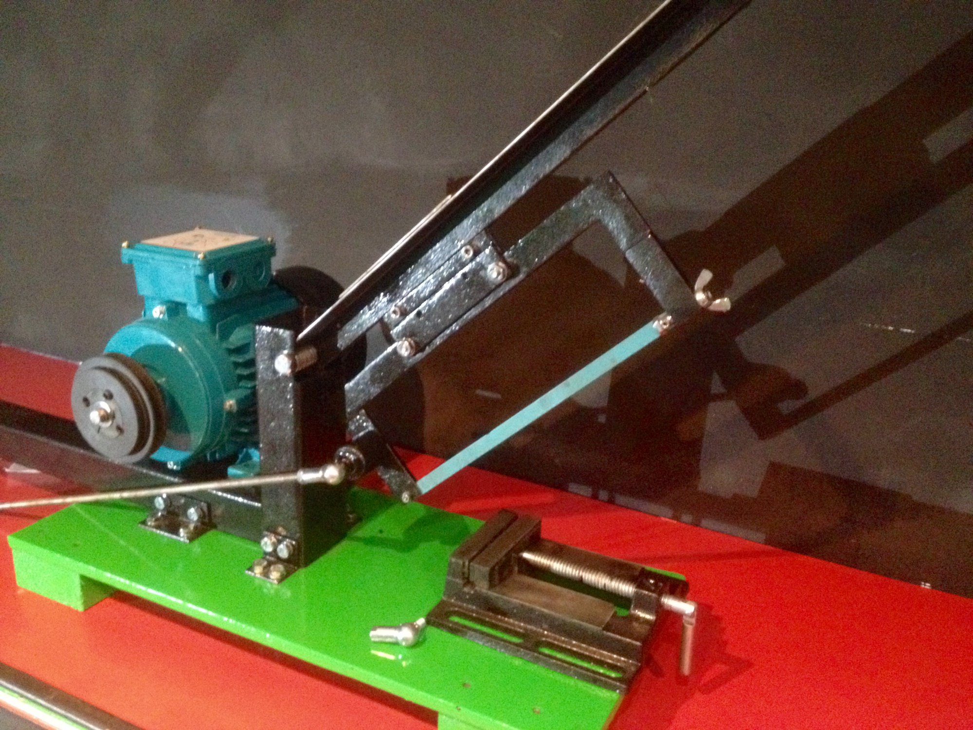

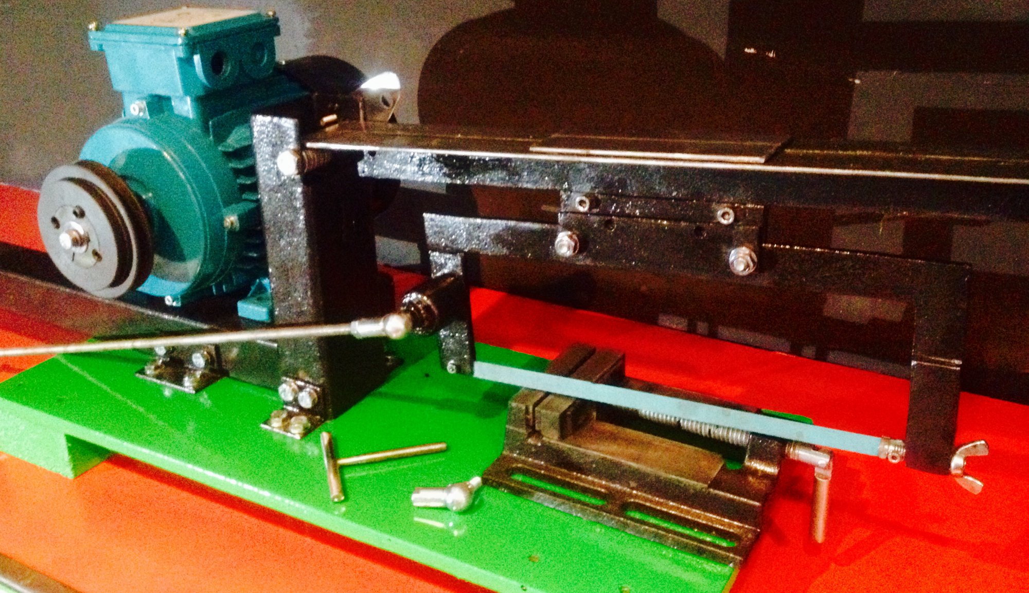

Been making decent progress on my powered hacksaw.. Picked up three phase motor today ( runs via my invertor off 240v ) got a pulley to fit which can take a belt, building in such a way that I can also use it to power other projects should I wish.. Just need to drill and tap thread for connecting rod attachment to pulley when I'm in a position to work out the con rod length.. ( soon)
Sliding hacksaw arm locks up via t bar out of the way when req.. Workpiece Bench clamp will revolve around a pivot point with angles marked for joint cutting..
Everything has been made so far from bits and pieces laying around apart from obv motor and pulley..
Will update as we go.. And video if, the creature comes alive..
