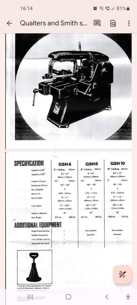

I have 3/4 HP on mine. Works fine. I fitted a motor mounting plate as the metric frame motor didn't line up with the old holes.Hi I want to change my 3 phase motor to single phase any idea what type and size of motor I should get
Thanks
I had a smallish motor on my rapidor, but the q&s 6h is a bigger machine.Take a look at the 3 phase motor and go for a similar single phase motor.
My hacksaw has something like a 1/4hp motor on it.
I think I fitted a 1hp to mine.Hi I want to change my 3 phase motor to single phase any idea what type and size of motor I should get
Thanks
