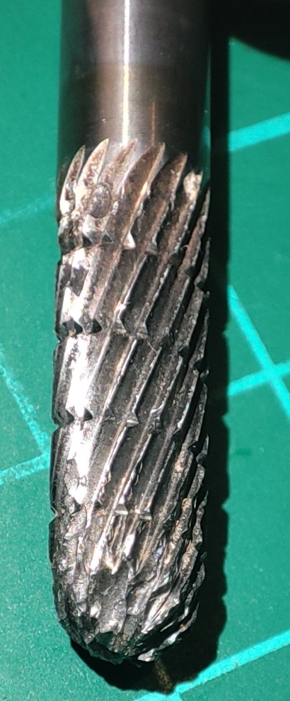

My oldest from 2012. Lots of low speed abuse etc that has chipped it, still cuts, use it often for similar duty. Solid carbide so the shank is still perfect and not chewed up by cordless chuck jaws.
