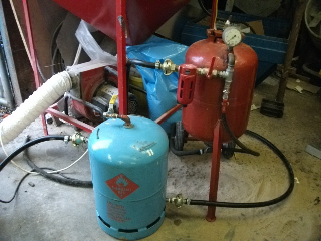

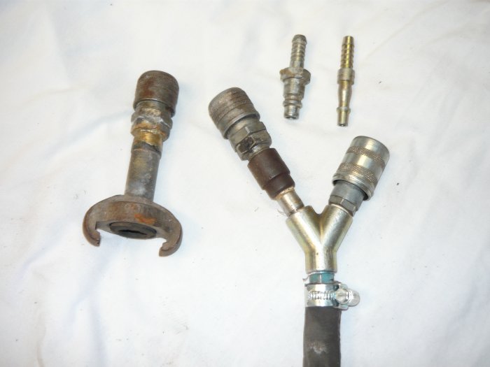

heres mineI use a y piece with pcl and euro on the outlets,most aldi /new gear i've bought has been euro,even pcl has a faster flowing range ,I chose not to keep up and just replace with pcl/sealey/draper which i think are interchangeable
i use them on the 6mm jet 90cfm pot and allso on the 3mm jet pot using 3/4 hose theres no auto seals in them . just use ball valves . no loss of airWish i had enough air at home to warrant the claw connector
Thats what I was thinking, thats normally only used on 3/4" and 1" hose !!Wish i had enough air at home to warrant the claw connector
