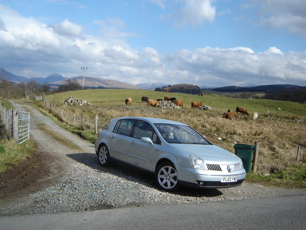

L lexi Member Messages 1,635 Mar 30, 2014 #1 Best compromise for a wheel refurb on my own car. No stripping. I will break bead and paint them when changing tyres. Quick rub down and a few coats of what? Etch? Not bare ally mind. Just on outside mind. They are original Renault Silver. DSC05050.JPG 158.3 KB · Views: 49
steveo3002 Member Messages 7,517 Mar 30, 2014 #2 etch is only needed for bare metal red scotch /800 em ..then do you need rattle cans or have your own gun?
brokenbiker Member Messages 10,436 Location Llanbobyll, south wales Mar 30, 2014 #3 go over it with 800, dust the first coat on then more coats till covered. Are you using gloss ot mettalic and clear? i need to tidy up the alloys on my Renault. The missus likes the kerb
L lexi Member Messages 1,635 Mar 30, 2014 #4 Thanks guys. I have guns and compressor. I will try and get colour match. I have 2k clearcoat that I could blow over my colour?
brokenbiker Member Messages 10,436 Location Llanbobyll, south wales Mar 30, 2014 #5 if you are using metallic you will need clear but i don't bother over a good quality gloss
