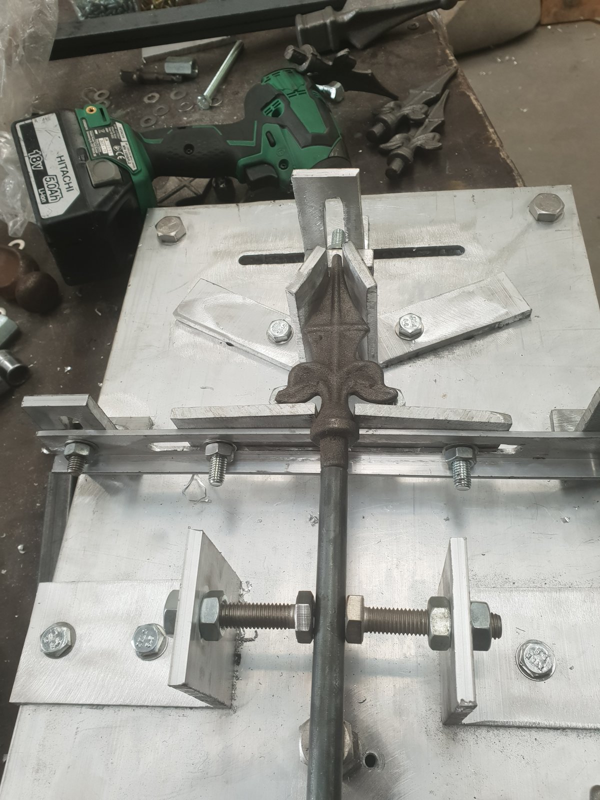

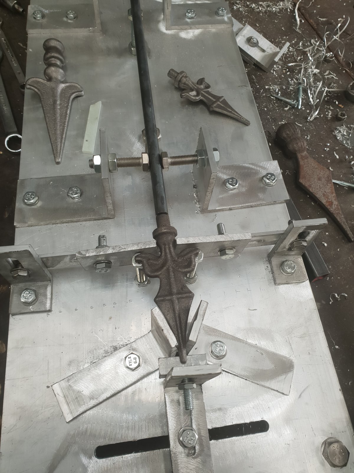

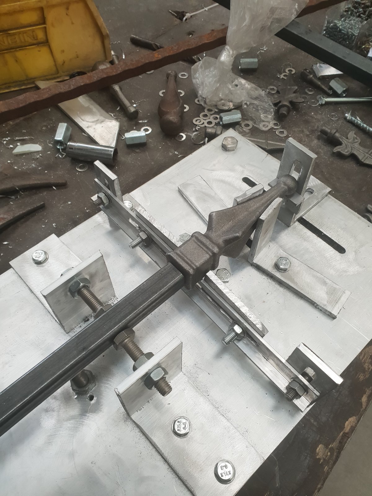

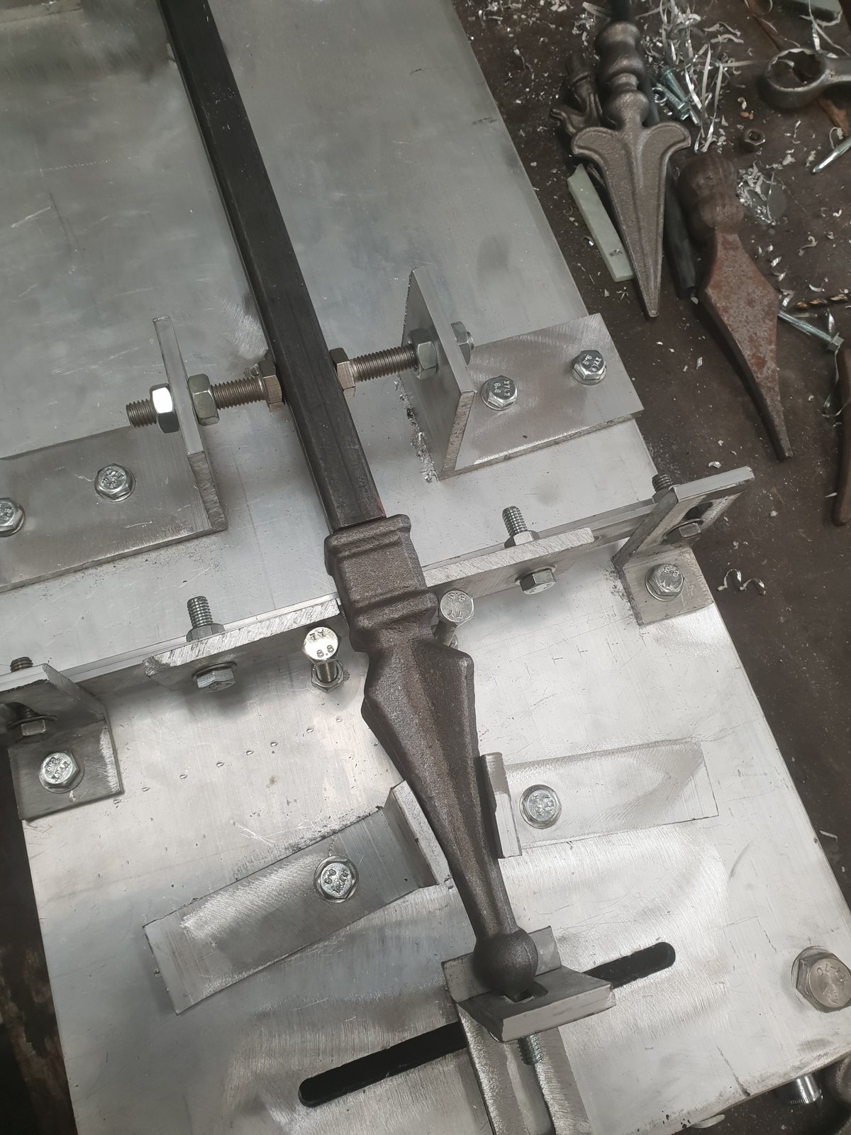

I thought I'd have a go at making an adjustable jig to cover most railheads and vertical bar combinations.
I normally just tack bits of steel to the bench to position the job, but then cut it all away once the jobs finished, so it will be nice to have something that's reusable.
It's all made in aluminium to avoid spatter so hopefully it will be good for a few years.
Don't be shy on suggesting any improvements....I only made it up as I went along
