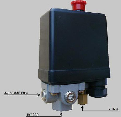

Hi, I purchased a new pressure switch from ebay, for the airmaster, it came with a hex nut and olive for the 6mm bleed or blow off pipe.
I cut the pipe off the old switch as it had a blue plastic connector, and the 6mm
pipe would not come out. The new switch had a hex nut connector for the 6mm pipe. Anyway I put the olive onto the 6mm pipe and tightened up very slowly and carefully.
I then powered up the compressor, no air leaks are present, and motor runs untill 120 psi tank pressure is reached, then there is a long hiss from under the pressure switch area and keeps hissing untill pressure in the tank reduces to 90 psi then motor restarts although seeming to struggling to start.
This cycle keeps going until I manualy switch off and release all the tank pressure through the outlet tap.I think it should only hiss for a second or two
I cant remember. So I removed the brass nut on 6mm pipe under the pressure switch and noticed the olive was crushed and pinching the black plastic 6mm pipe almost shut, the olive looked more mangled than compressed.
I cant understand this as this olive came with the switch ,and seems to fit the 6mm pipe really well. And tightening it up slowly should not have crushed
it badly enough to crush the pvc pipe.
Anyway what I need to know is what type of new olive and fittings do i need
to ask for to replace this ?, there seems to be all sorts available gas/water ect.
Also can I use a copper pipe and fittings here instead of the pvc pipe ?.
photo of switch attached
Regards
