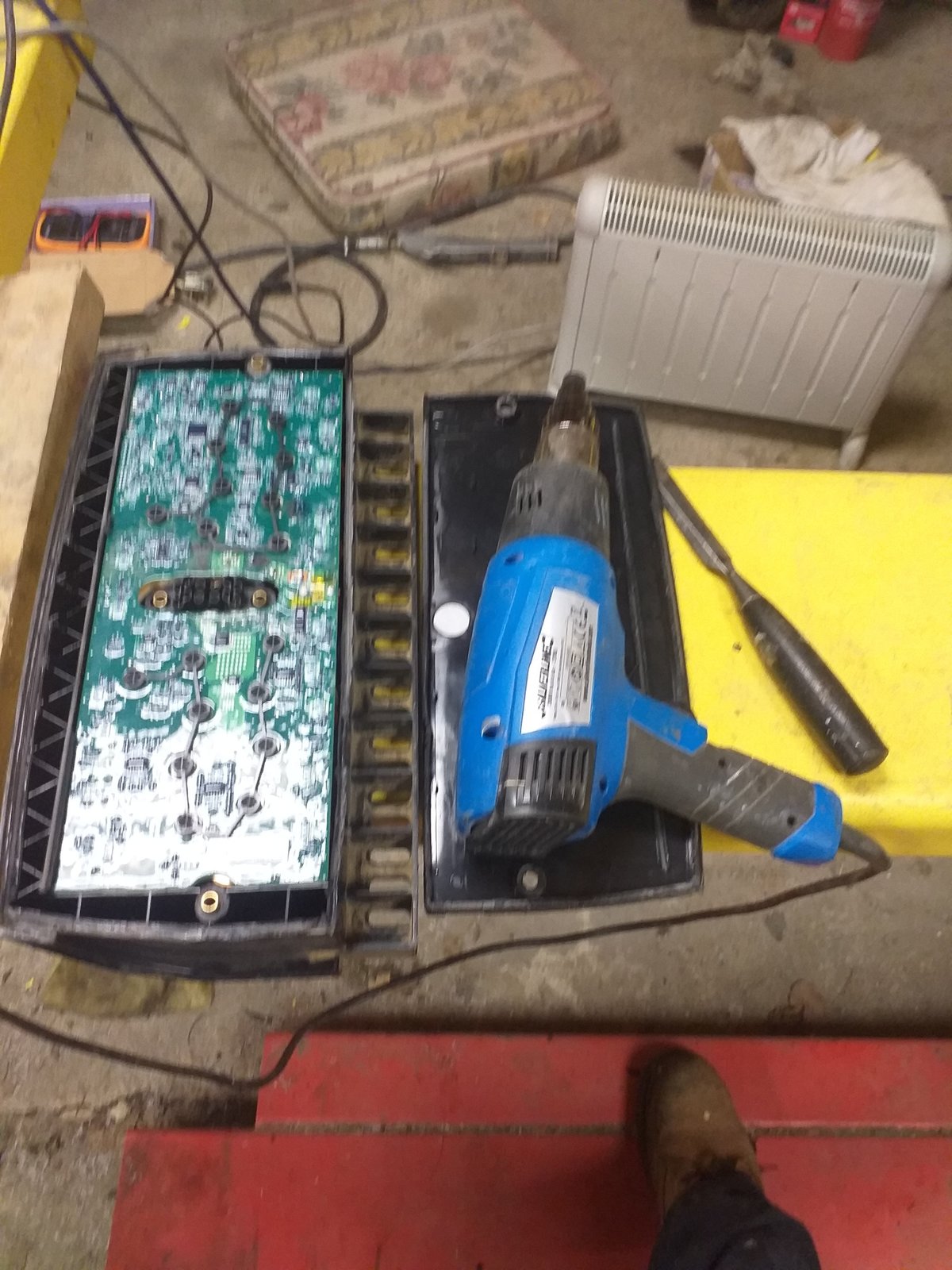

Recently I bought a dead circular saw off @angellonewolf which we both assumed had dead battery cells. We were both right. Half the cells are dead and I will go through the process of re-celling this pack just so you can see what that entails (and whether or not it works!)
I popped the case off and peeled back the protective layer of foam insulation. This thing is now very dangerous. Short it out and a lot of amps are going to escape, all at once.

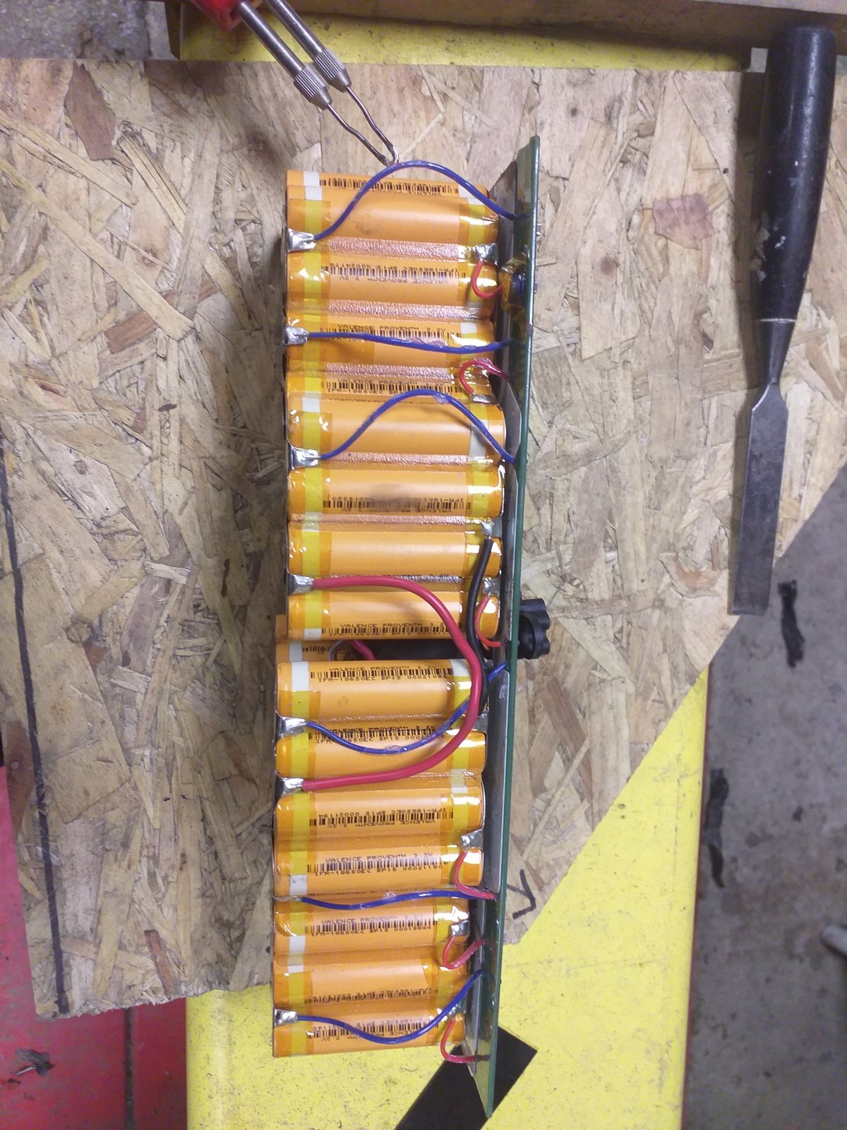

A quick check reveals low voltage, a sure sign of a dead cell, about 16v iirc compared to the 19 or 20v you should expect with 10 cells, five in series, then parallel. The board has to come off and there's a temperature sensor tucked away in between the middle cells.
I am fairly gung-ho about ripping these things apart so I prise off the spot welds which is absolutely not recommended! Some of them came off easier than others...
That's about as far as I got. All the cells are free, five out of the ten are stone dead, not all in the same circuit and I might expect some to recover though they're all going in the recycle bin. popping the weld off means the case is already compromised and I have a ton of spare cells waiting to find a new home.
Some battery packs have a battery backed switching circuit which disables the unit permanently if all of the cells are removed. That's common in laptops and high value items, some tool manufactures are doing it too but I am hoping this one doesn't. Soon find out.
