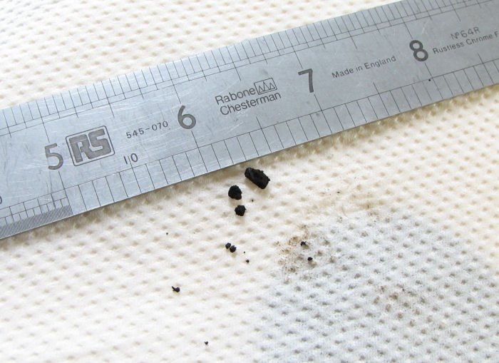

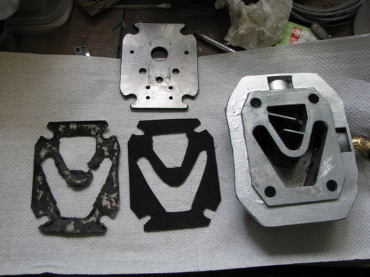

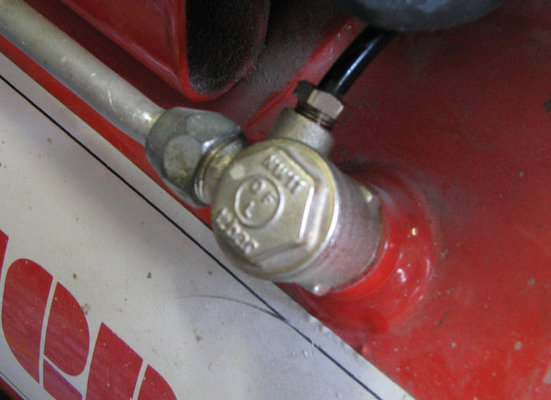

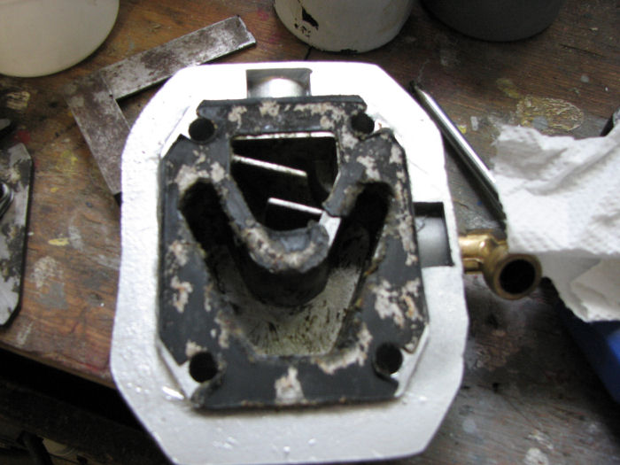

My Clarke 25 compressor has started blowing off on the relief valve quite regularly now. It's working ok one moment, then suddenly vents pressure, then stops venting, and charges up again, then vents. From experience, I know that this is caused by foreign bodies getting stuck under the rubber valve in the valve assembly that is attached to the side of the receiver tank, breaking the seal, and allowing the compressor to function correctly (by blowing off!!)
I'm anticipating exploratory work into the compressor assembly to workout what's going on. The bits that block the valve are black, and do not seem to be metal. ie I seem to be able to crush them in my fingers, but they are quite hard, and they're only small, about 1/8" max.
Anyone any experience of this and any pointers as to where I should look first.
Using the compressor in my house garage, so not too dusty, etc, and it's only used for spraying small objects.
Help!
