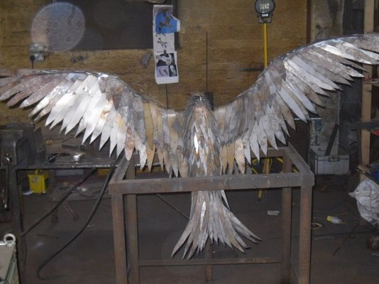

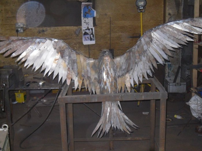

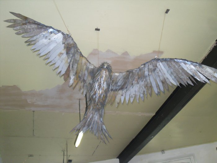

This is my latest bird of prey project, a Red Kite. Ive hung him for viewing this weekend but need to sort a couple of things im not happy with. I will take him down on Monday and should have him done for midweek
Im betting you could do a bird. You do a lot with frame work anyway and you obviously have an eye. Instead of men frame work draw a bird out and bend some round bar to it. Make 3 of them for the 3D effect and then add round bar for the wings. Fill in the frame with steel circles then add feathers. If you have a plasma they are quite easy to cut out.
Print of some pics and work to them. You will make mistakes, I have, but the beauty of steel is you can just cut it off and start again till you are happy.
