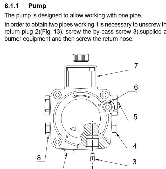

I replaced the oil pump last week and everything was fine until Sunday when it stopped working...I can put the inlet oil feed pipe into an oil can and the pump works fine...but it won't draw oil from the oil tank which is outside...I have blasted air down the feed line and can hear it gurgling in the tank...ive cleaned the filter at both the oil tank and at the oil burner pump...i tried connecting the tank feed line up again this morning but still no luck....any help would be very appreciated...thanks.
