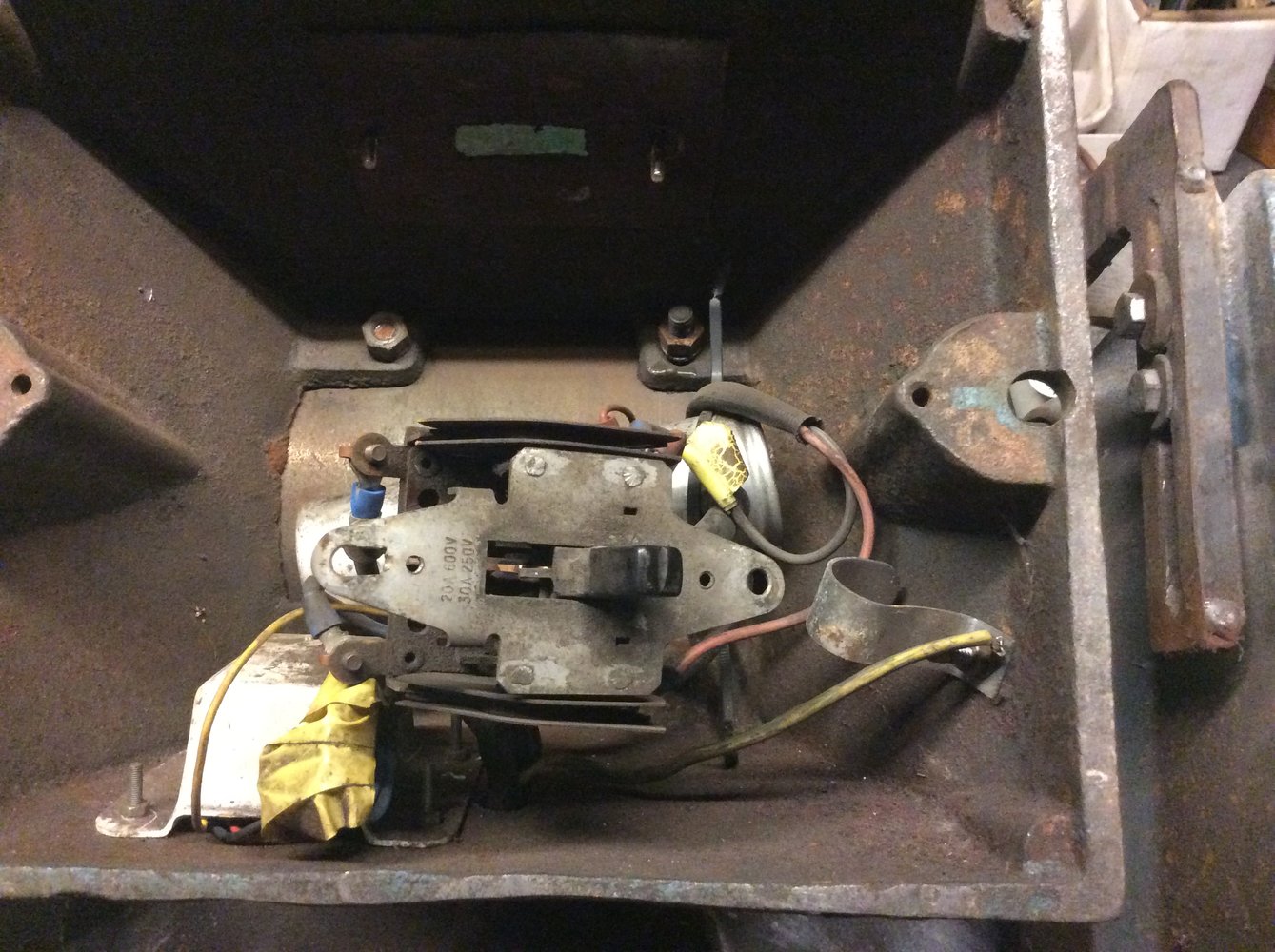

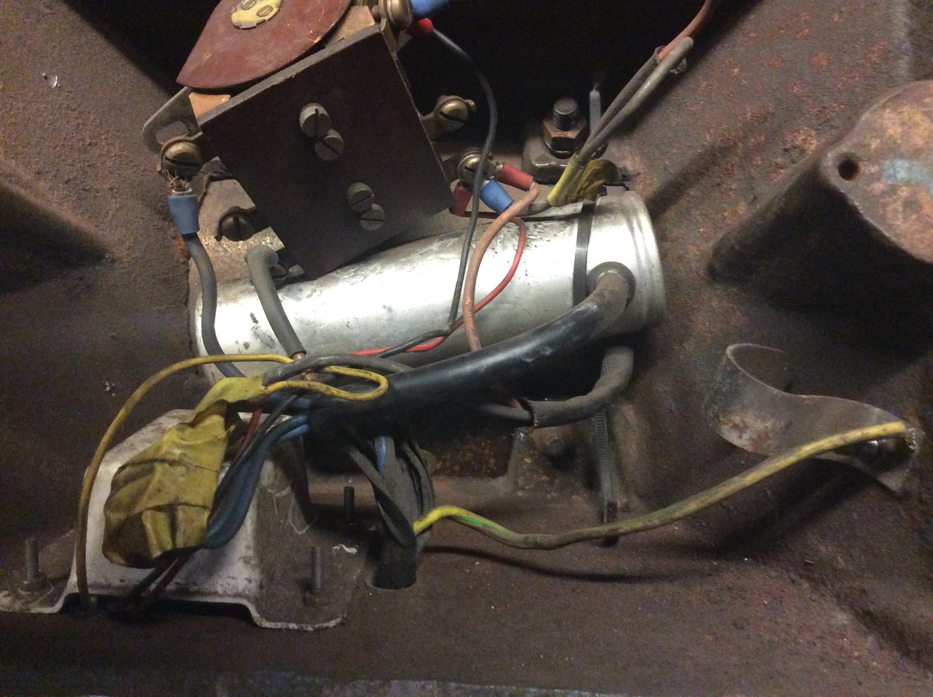

2 gangIt should just be L & N in and L & N out, with the capacitor wired across the output (motor) terminals
Any 2 gang switch of the appropriate load rating should do. An NVR would be ideal but not essential, I think, for a grinder. I like the idea above of getting an IP55 rated one to keep the dust out.
Aye - double pole2 gangi bet u mean double pole . a 20 amp metal one will be ok. it dont need to be a nvr
