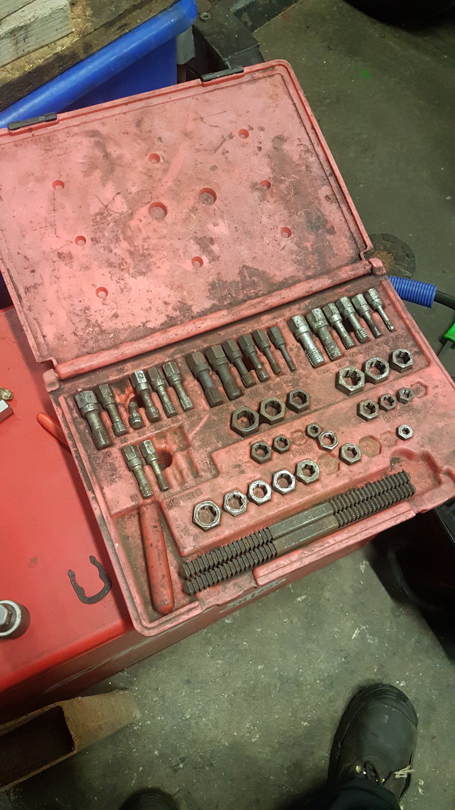

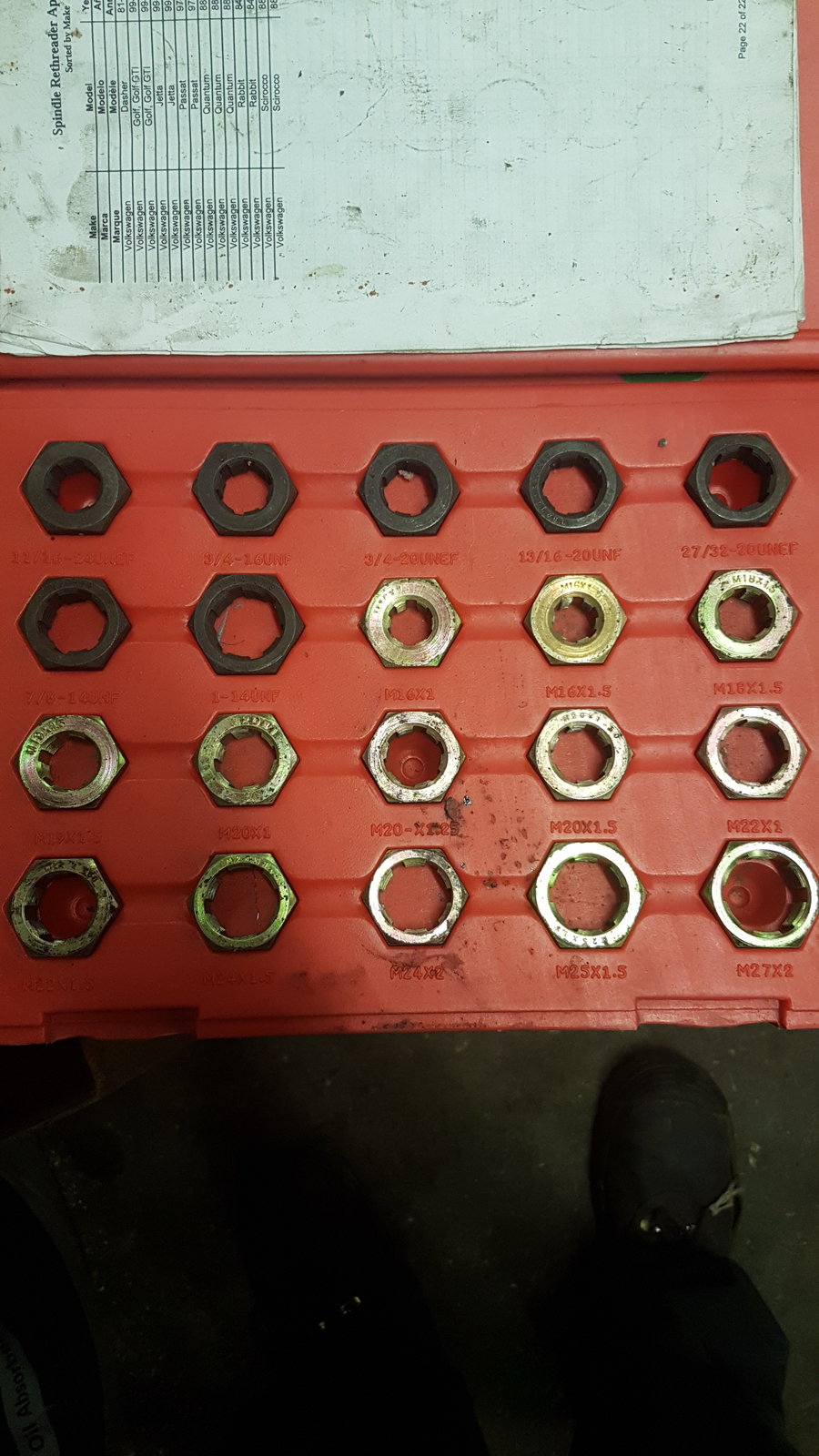

Has anyone seen these kits, they are basically blunt taps to repair old threads, I think the idea is that they don't cut metal out because they are blunt, so they just push the old threads back into position and get the kak out of the old thread. I always feel like taps are taking out more metal and weakening the original thread. From what I can see these rethreaders are not even hardened, they also don't come in fine sizes and unfortunately my Suzuki's are all fine pitch threads...
So what do you think if I just take a selection of cap head bolt and cut grooves down the threads with a milling machine?
