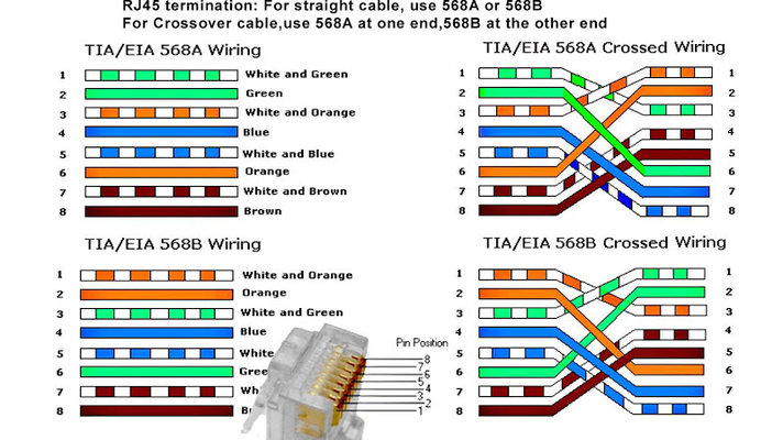

Both. There are 2 standards for wiring them. 568A and 568B.
Just make sure all your wiring is the same. if you have sockets they will have a guide for each standard

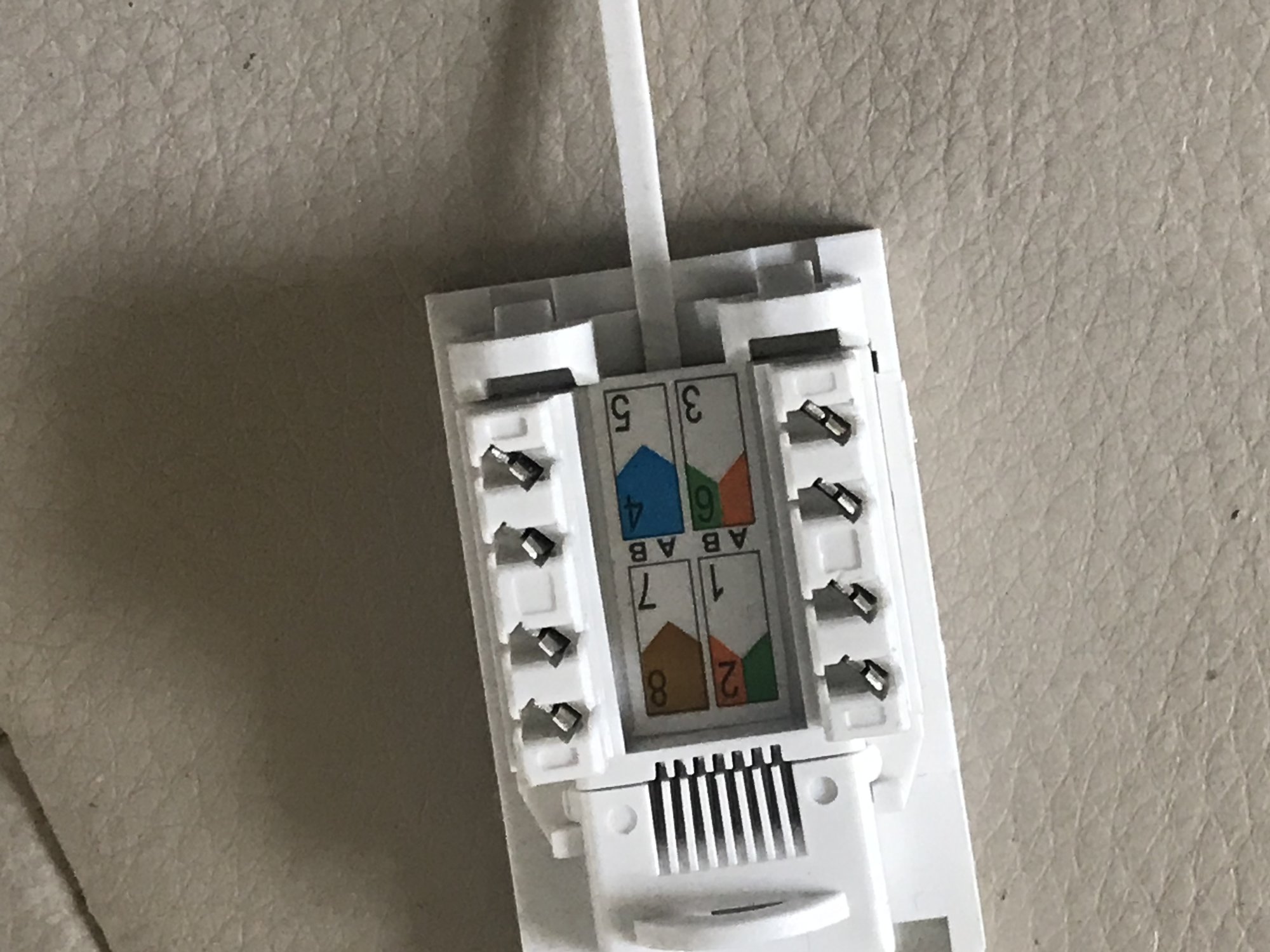

This is what I’ve got, how do I wire it up? Today it’s not making sense
The B standard is what I’m aiming for
They are numbered on your unit.The socket points aren’t numbered on my unit, I can’t get my head round if I pair up as in pic 1 or cross over like pic 2
1 is white and green.
2 is orange.
3 is white and orange.
6 is green
7 is white and brown.
8 is brown
4 is blue
5 is blue and white.
With the numbers orientated correctly from top left down. Then top right down.

Most cables you buy are on standard A so do your sockets the same way. It doesn’t make a huge difference but might as well keep it the same. If you grab a cable and look at the plug you will see they are wired as A
